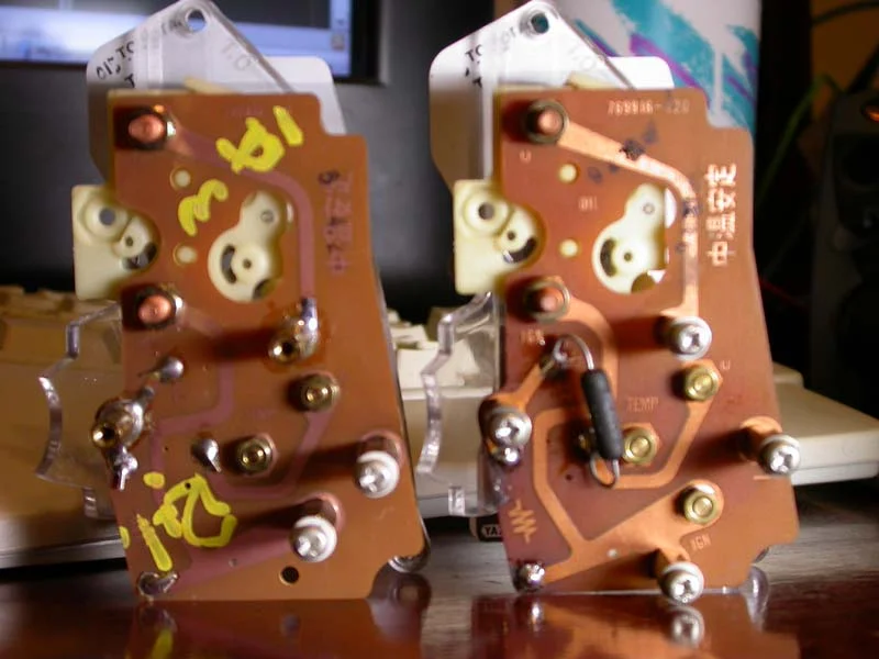

it would work mechanically but iirc there is a screw mounting hole out of place.
What Semlin said,
See pic below, stock 93 on the left, modified 97 on the right, like a lot of other year changes 93 and 94 are the same, and 95 through 97 are the same.
Notice the placement of the bottom standoff and screw, The screws are also the electrical connection, (In this case ignition switched 12v + supply) it would not be to bad to move it on the gauge PCB, it is already pre-drilled you woudl just have to make contact, but the circuit board of the cluster is a different story, it could probably be done by a good tech, possibly deleting that screw and making a wired connection but I think it would be a lot easier to just modify your 97 gauge.
Please ignore the poorly executed bends on the resistor it was the first run on the test bed gauge,
