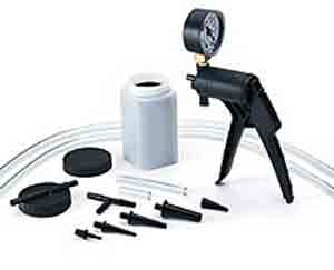

Sounds like a pin hole in the booster to me too... The way to test your booster and a junk yard booster would be a hand held vacuum pump:
You hook the pump up to the booster and apply some vacuum, if the booster is leaking it will not hold vacuum. If it holds vacuum then it's good. Kudos to you for wanting to learn about your truck! And welcome to Mud! :cheers:
