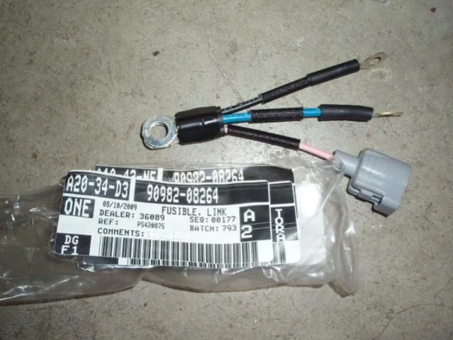

Check your fusible links. These look like 3 wires coming out of the battery's + terminal, inside each of these wires is a fusible link, which could be blown and no voltage will run by them.
Check for continuity or voltage on the fusible link end.
Here's a pic of what the fusible llink look like..

wow i was hoping that would work, just tried it and got nothing, part is expensive, any other way to test if it is bad

pdmcgee: which part are you referring to as being expensive? The fusible links are only around $12 in the US.
