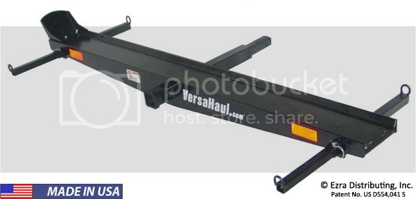

I'm thinking of buying the VersaHaul Sport Motorcycle carrier which has a max load of 600lbs. Then, plug a hitch mounted bicycle hauler into it.

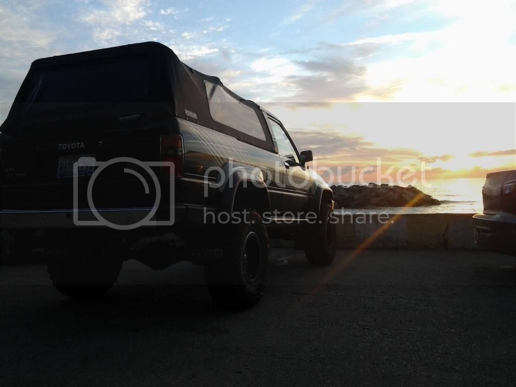

I found the HD Versahaul with trailer lights and straps for half price so jumped on it. I've been driving it around town the past 2 days with the bike loaded and 2 sets of wheels/tires in the back. So far so good.
The rear is sitting just below level at this weight... it sit's about 2" higher empty. Suspension feels fine, brakes and steering feel good.
After a bit more testing, if all goes well, I'm gonna run it to CA via Albuquerque. If it doesn't seem safe, I'll throw it in a U-Haul trailer along with the bike.
