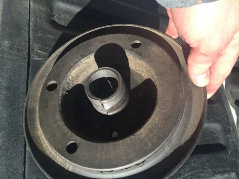

image.webp I just bought a pair of 60's (83 and 87). The previous owner told me that the 87 just needed the crankshaft pulley nut and the key to get back on the road. I went to put it on yesterday and saw that the pulley is broken out where the key fit in. I see that I can order one of these, but am wondering if there any other options of a harmonic balancer swap from another yota or I should just bite the bullet and order an expensive used one. Thanks!

If you think a used one is pricey, try new. They are also available aftermarket. But, as 3 pups asks, how is the nose of the crank? Is one of the trucks a parts rig? You can use the pulley off that if the crank on the 87 is good.
We ask because if the pulley or nut goes at speed, usually the crank snout is trashed, or the keyway.

Hmmm... I think that Spike was right. I am going to have to mess with the slot on the crank, looks like it was wallowed out during the process of the pulley coming off. Not good!
common issue when this failure occurs. looking at your pic of the balancer, opposite the key way appears the thickness of the balancer is less, meaning it was wobbling around for quite some time.
There are a few threads in both the 60 and 40 section about repairing the keyway, if it's not too buggered. I've also seen some youtube vids should you want to peruse there.
What would you recommend? Braze, chisel? Also, anyone know the specific dimensions on the ID of the pulley? My friend has a fab/machine shop and might build an inner sleeve for it.
