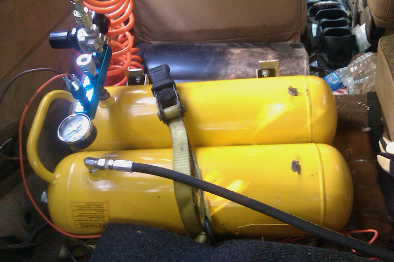

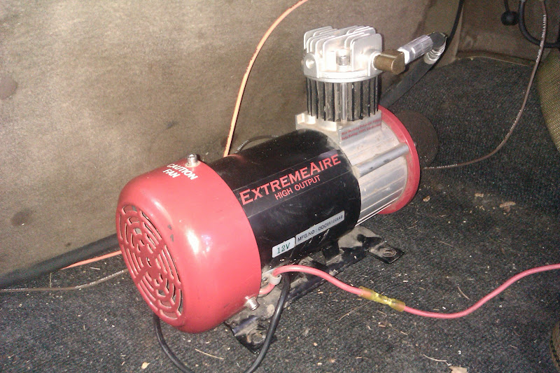

I picked up a used 12v compressor this summer and installed OBA.

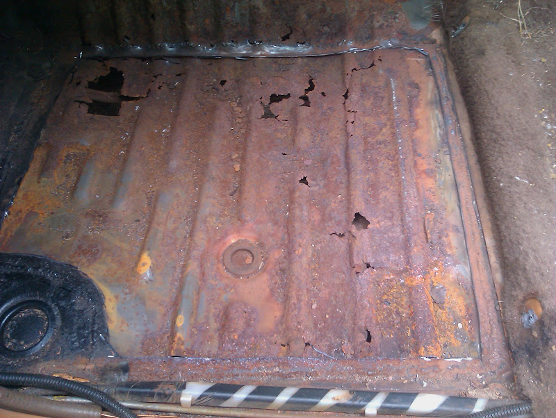

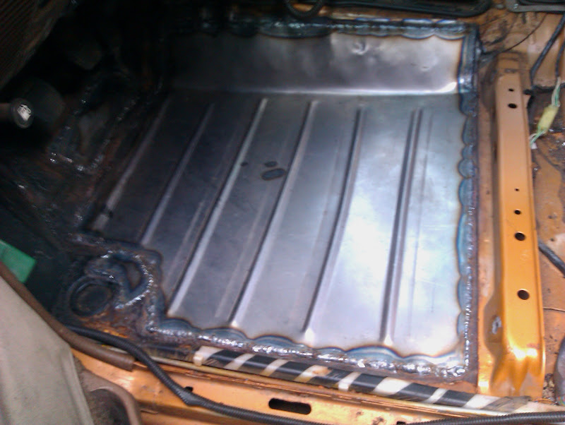

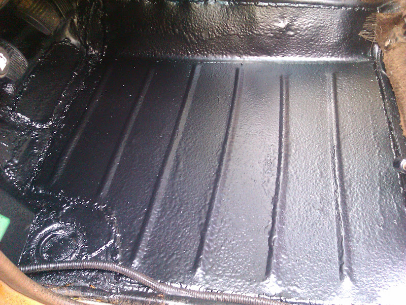

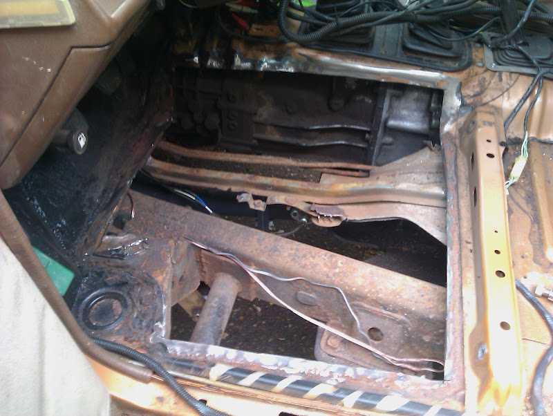

My drivers side floor pan was rusted out, I had a sheet of 22 gauge steel welded over it for most of the summer as a temp fix. This weekend I finally cut the rust out and fixed it the right way with some 16 gauge steel.
