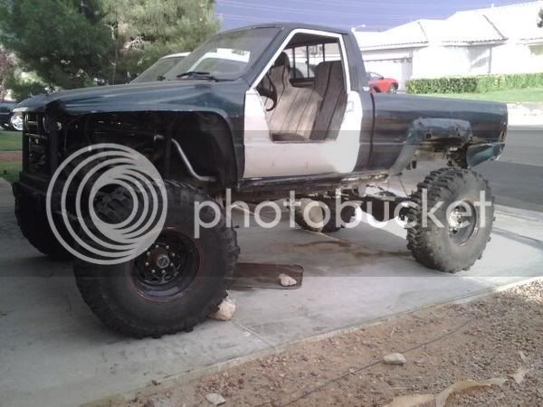

anyone have any feedback on the lines proposed to cut these into half doors? I've looked at the Pirate and other's threads on half doors but am just wondering what ya'll think.
I am going to keep the window frame and make canvas snap-on covers for the openings in case of really incliment weather:D
I am wondering about how much I plan to take out.... is it too much? I want it to be light and increase visibility, so the tape marked cuts provide that, I do plan to weld in one brace (or armrest) support horizontal along the high part of the cut).
Feedback?
I would change the lines to something like this and just go ahead and move the handle.
I will be doing this as well to a set of mine eventually, or make a set of tube doors.
