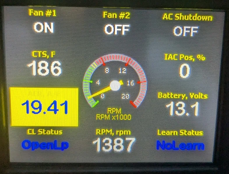

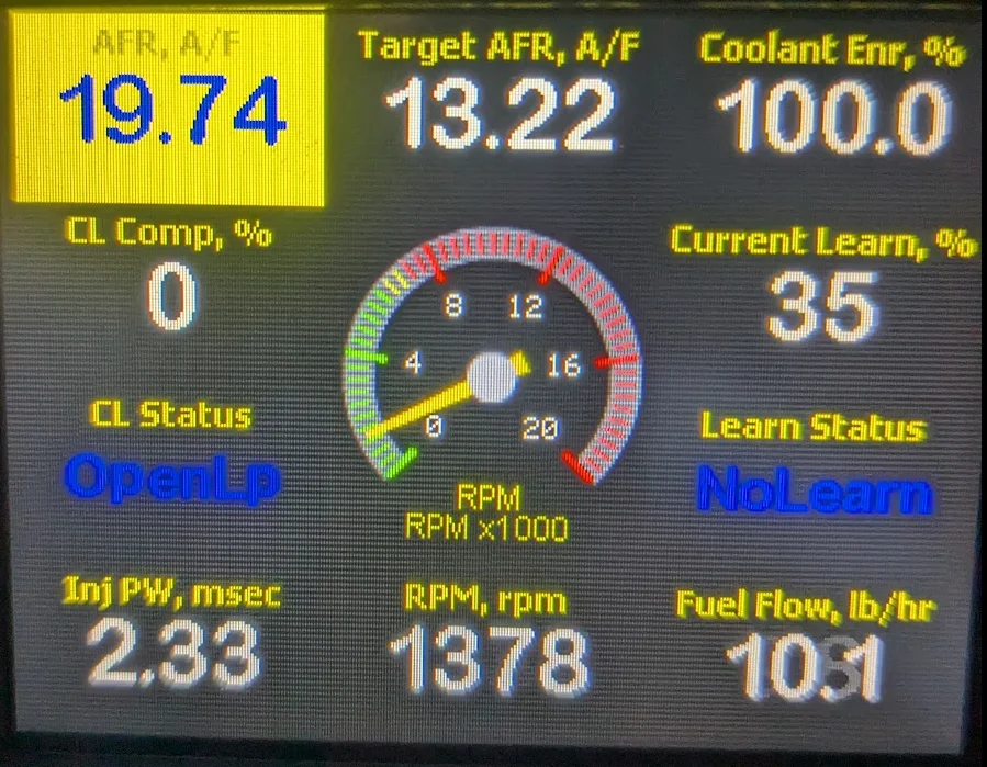

I brought it up to temp and here are some screenshots:
You really need to check for vacuum leaks, that AFR is very lean. Also, once the engine is above 160F, it should switch over to closed loop and be using the o2 sensor to adjust AFR. Recommend getting a good vacuum gauge and hooking it up to one of the ports on the intake manifold and see what the reading is and if its stationary or bouncing around. Reading should be 15in/Hg or higher. I see 20-21 in/Hg at sea level.
When it is at cruise (between 2000 and 3000 RPMs) the AFR is pretty close to the target of 14 (assuming that 14 is the correct target). It also runs ClosedLp and Learn when cruising but switches to OpenLp and NoLearn when I take my foot off. I don't know if any of that means anything or not.
I'll get a vacuum gauge and test it. Test at an idle with no throttle, right?
What he said! That MAP reading is super low but I’m assuming you were holding the throttle part open? If not you have a big vacuum leak.
I guess the other thing: have you adjusted the idle set screw on the throttle body to get below 1200 rpm? They are not factory set and need adjusting.
So vacuum holds at 15. I forgot to get some starter fluid. I'll get some and spray around the intake to see if there's a change.
I wasn't touching the throttle. I know nothing about MAP. Not sure what it does or what it should be. I haven't touched the idle screw. It's still set as it came.
I think the timing does need a tweak. It misses a bit. Not sure how to loosen the distributor to be able to turn it.
Back the idle screw out while it’s running. Ideally, you want the throttle blade pretty much closed and the IAC should do the work of letting idle air in. IAC should be 1-5% at idle, so you’ll shoot for IAC at 1-5% at your target idle. I also like an idle closer to 780-800 rpm to keep everything wet and slippery, but that’s just me. Also, in case you’re unaware, any time you make idle screw adjustments, the key needs to be cycled to reset the TPS.
I really recommend setting up a custom screen with TPS, MAP, IAC, AFR, Coolant Temp and tach. You can also resize the dial tach in the middle so it’s a smaller range. Mine is set to 5000 max with redline at 4000.
MAP is manifold absolute pressure; it’s what the sniper sees as vacuum. A low MAP number correlates to a big vacuum leak (if at idle). Idle MAP with 18” vacuum is around 80-85 I think. Your 15” vacuum is a little low (depending on altitude) and I bet it is due to the throttle blades being more open than they should be, which is also causing the higher idle.
