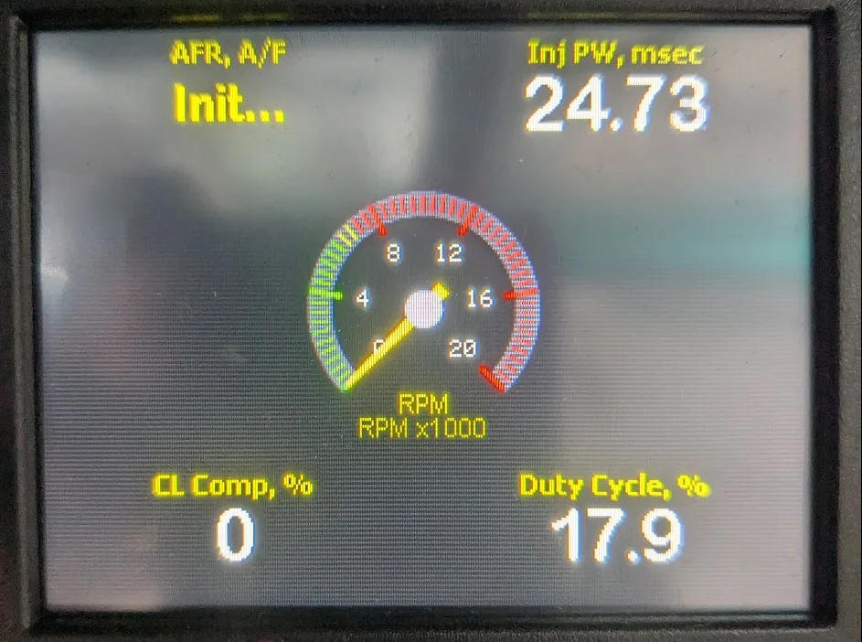

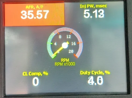

A couple shots of the sniper screen. Here it is after initializing and before engaging the starter motor:
This is what it looks like while the starter is cranking:
Any thoughts?
I disconnected the output line from the Corvette filter/regulator - there is gas in that line. I disconnected the line from the sniper and gas does come out while the pump is running but is just burbles out. All the lines seem to be clear. But I'm still not getting good flow. Bad pump? Bad Corvette filter/regulator?
Maybe I've got the connections on the filter/regulator reversed. Is the center one the inlet and the offcenter one the return, or vice versa?
Admittedly I've never installed a sniper kit, but I have been dealing with fluid pumps and whatnot for years. If the output line of the pump is disconnected, there should be a lot of fuel coming out while running. Def should not be a burble. Hell, when I barely pushed the old mech pump by hand it shot fuel about 6'. If it's just trickling out, you either have a suction leak or a bad pump from the factory. In my opinion. Or it could be getting low voltage and running at half mast.

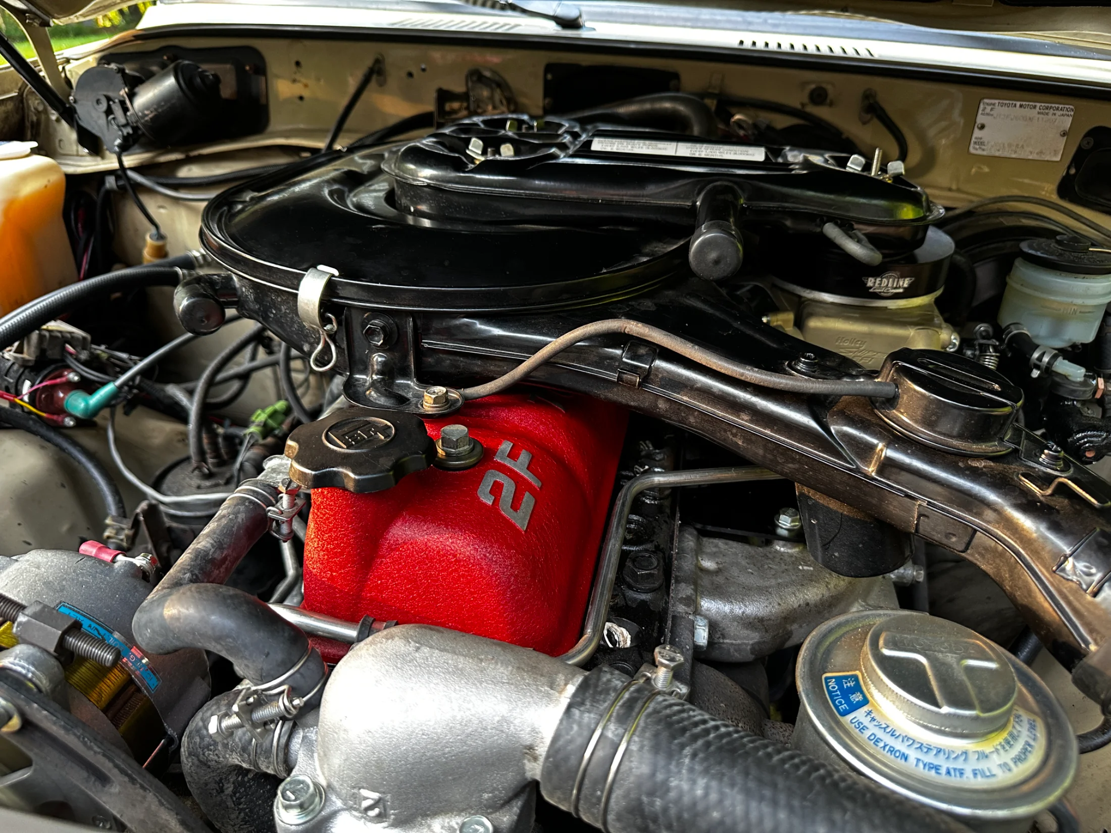

I see you have a vacuum line to the intake valve thing on the air cleaner? How do you have your vacuum lines routed?
I have the vac line coming out of the intake with a man a fre smog delete going to the PCV valve
I have the distributor advance going to the port specified by Holley on the throttle body. I have the vacuum from the passenger side of the air filter going to the distributor.
Lastly the vacuum for the brake booster is in the stock location on the rear of the intake manifold with the other smaller tube on that fitting capped off.
I’ve also got the AC Delco charcoal canister installed but my truck isn’t near me so I can’t remember exactly how I plumbed that in but if you search for this here you will find some common solutions.
All other lines to the air filter housing and intake manifold are capped off.
Also, where do you have your o2 sensor mounted?
