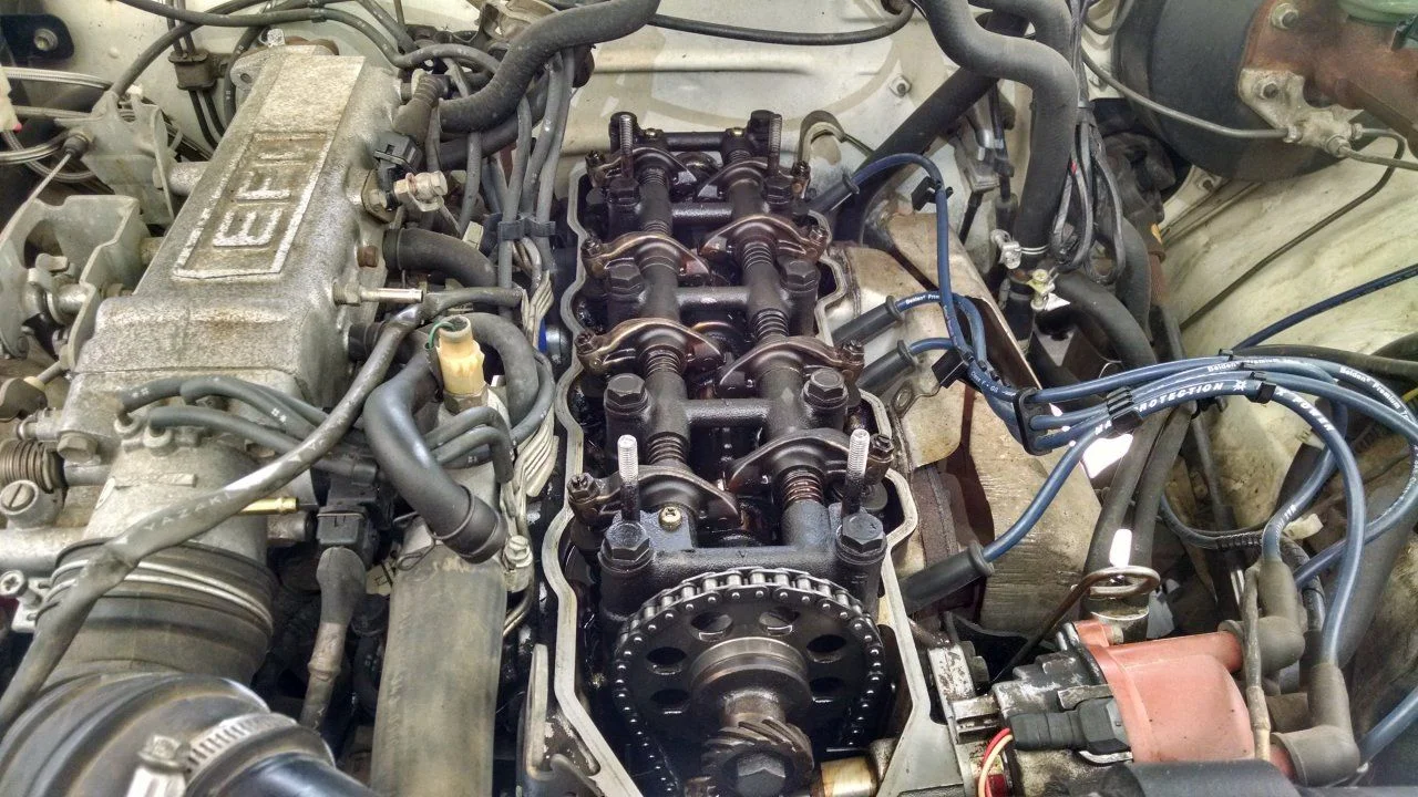

I adjusted the valves a few days ago. At first it ran great - hardly any chatter on the valves, etc.
Then today it really had a lot of chatter and I noticed that I was stuck on 1200 RPMs at idle even after warm.
I'm going to pull the valve cover off and recheck the valves with a warm engine tomorrow. I may also try replacing some vacuum tubes if I find any questionable ones.

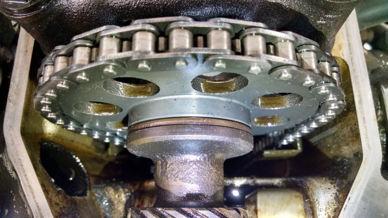

check your timing chain guide on drivers side when u have valve cover off. oem's are plastic and prone to break. just saying!
Yea, when I did the valves I did
and it looked good, but it sound like it is broken now - no more valve noise and a new noise from the front of the timing area. Maybe it was broke down below. When I get it back open I will check it again. Here is a pic of it before.
I had a customer whos broke, piece went down caused chain to jump and bent all the valves and landed back on top dead. No Start and no compression but back in time! had never seen that happen before.
Make sure you're not overtightening the valve cover nuts. They don't take much, and if you do, stuff can tap on the underside of the valvecover and make a lot of noise.
Oh wow - - never thought of that. I did them by hand and watched the rubber expand to where it looked like it perfectly rounded out the metal on the top and bottom - - - given I just did it, I could always loosen things up and see. Thanks, Chef.
