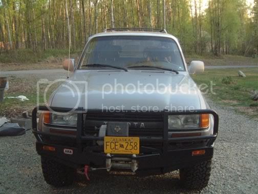

I spaced mine back about an inch, then trimmed the bumper and lower bar to fit.
Its a great winch and has freed me from some pretty good stucks.
Here is my rig. ARB Commercial bar/Warn 8274.
Before I mounted lights.
After lights mounted.
Some detail shots of the Commercial bumper fit. It will look better once I get the balls to remove the flares.
Warn 8274 fits perfectly.
Dave
