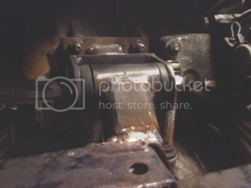

I put the transmission on anyway because i need to start doing mounts. I took off the motor mount arms from the om617 today. The four protruding bolts are not too far off from the stock toyota arms. I also have some 2 inch square 1/4" tubing butted up against some 1/4" plate that I got out of a scarp pile. I may just drill the mercedes bolt pattern into that butted plate (engine side) and then either use 4bt mounts on top of the frame rail, or cut diagonally to match the slope of the toyota mount. I don't have the engine in the body yet for a mock up because i'm still figuring how i'm going to be lifting that beast in, my current crane is def not high enough, i may have to set up a pulley system of the shop roof cross beams to get the clearance i need.
I want to hear some opinions about motor mounts possibilities, this is going to be a challenge for me (not much of a fabricator yet).
So the options right now is the square tubing pictured used with 4bt mounts or stock toyota mounts
or
stock toyota mounts only (depends on if i can get the mercedes engine side hole pattern into the toyota motor side), and also on width and reach issues, I don't know the difference in block width between the om617 and 20r.
or
Mercedes stock motor side arms with 4bt mounts

Here are mine. They are 1.5" rubber bushings that I got from the local spring shop.
I don't know if you have it or not, but if you have a v6 or auto 3 core radiator available, you should be able to use that. Also, you can use the stock mechanical fan, just make sure what ever radiator you use won't hit the fan. I have a volvo 240 radiator and the way I have it mounted, the mech fan would take out the fitting to the expansion tank.
I used Cummins 4BT solid mounts which are also a very common Dodge smallblock isolator. I'm happy to report how it performs once I get it running. Softer is better in my opinion because these things really like to rattle around, particularly at idle...

Before I left I fabbed motor mounts out of square tubing and utilized stock toyota rubber mounts and toyota block side mounts butted up to flat plate drilled with mercedes bolt pattern. Custom hung tranny cross member with ubolts to frame. I did all the fabbing in the most pitiful conditions in a (dark wet ) hole in the wall shop on upper queen anne during the 2011 winter/spring. It took me days what could have been done in a couple of hours with a properly equipped shop. The project right from the get go was very shade tree and totally time inefficient and thus in the end quite expensive (i've come to realized this working on other projects in proper equipped working space :) The suspension is all done and it rocks. The truck will be riding on some aluminum 16" rims off a gm vehicle.
