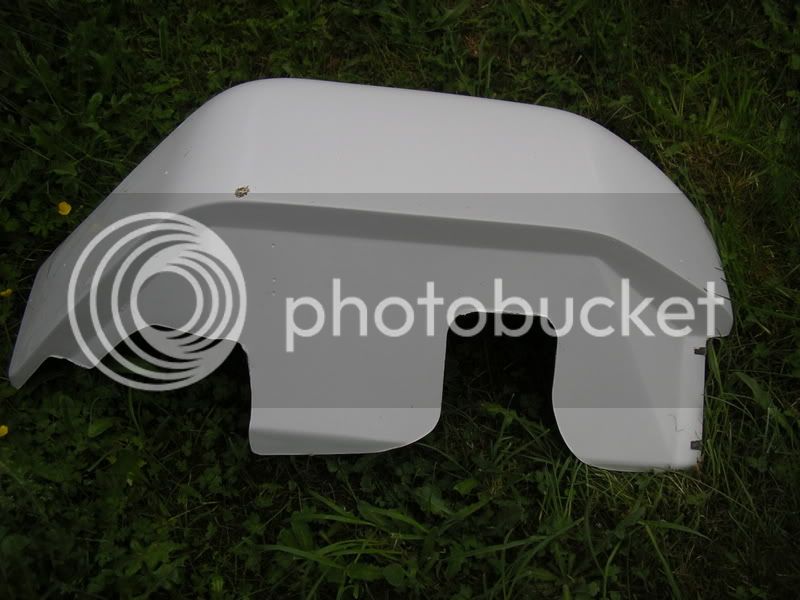

at a guess I'd say 150 ish a set maybe? maybe a bit more,maybe less all depends on what you use. Contractor grade deck resin works fine, and it's pretty cheap. it's the matt and roving that get you. I still have a bag of roving kicking around.
They arent super cheap, but thing is, you can build up the edges and areas to be a lot stronger than the steel ones, and they're easy to patch if you ever f them up.
and you can skip the inners too if you want, I did with the green ones, and just zapped in some rubber matt to keep the muck out of the engine bay.
I still have a couple pics of em. whites are standard, the green are 2" narrower, and 2" shorter so they can be moved up closer to the hood.
(green pic is ooooold...that's the original Crackwhore...before I turned it into a BJ45...)
I was guessing at about $150.
I'm thinking I'll go that route. It means saying goodbye to the flat-fenders but I like the look of those. Do you recall the size ot the tires on the green one?
Are the white ones gelcoat or painted? :hhmm:

How big are the molds? Would they fit in the back of a 40 or are they larger than that?
pretty big, size of a set of fenders plus a bunch of boxing...
white ones are gelcoat, on the green one those were 33's. Hankooks I think? so not the biggest. spring under, with 60 series rears up front...Think I cut about 1.25" out of the aprons or so?
was room for 35's there tho.
I still have the green ones out in the shed with the trimmed side aprons, if you want to skip the whole stinky process of building a set...;)
