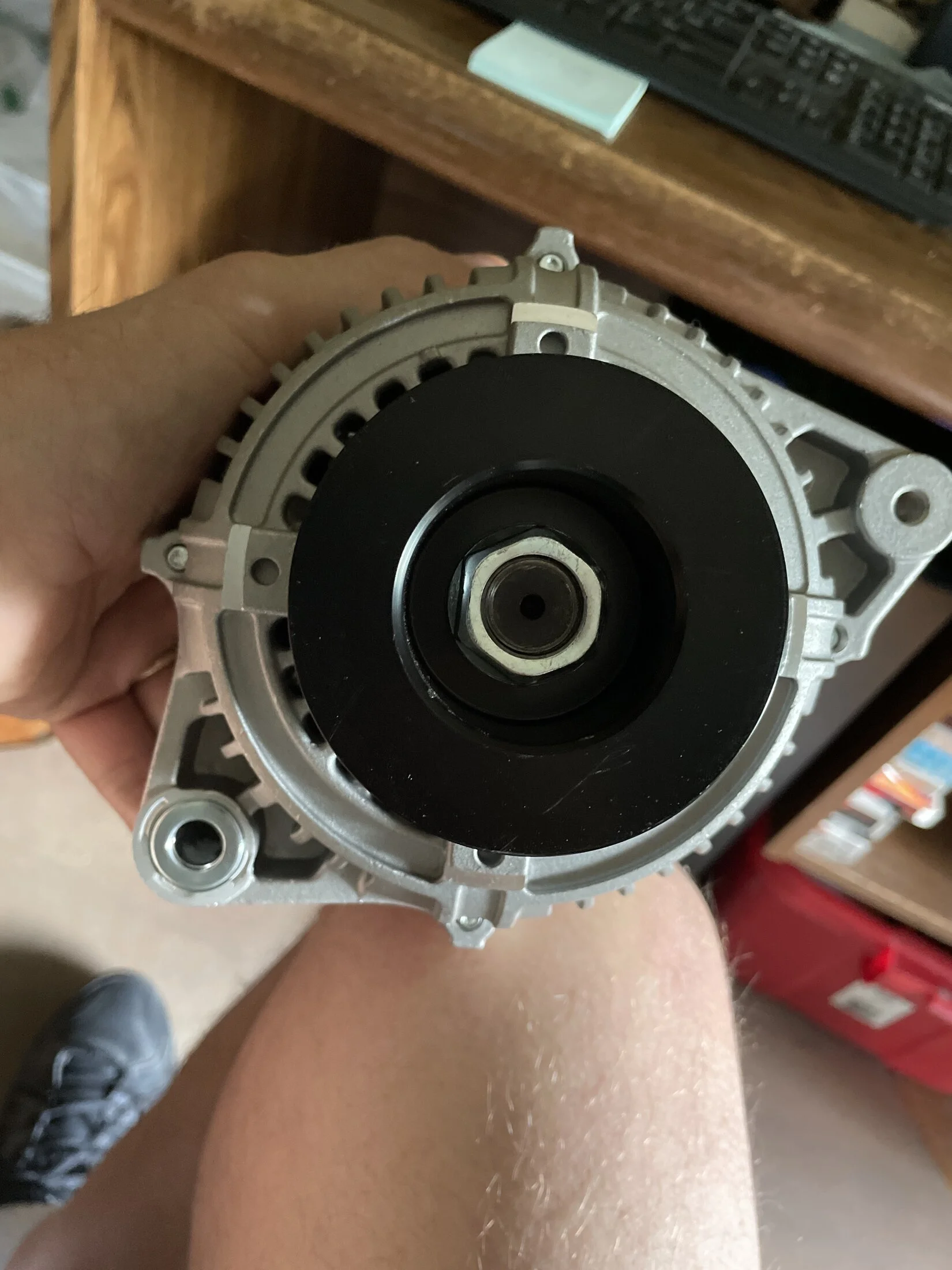

Just for info, I have a brand new alternator that I ordered for someone but didn’t take it.
12v 110a 27060-17180
Before you order a replacement alternator you need to work out which one you have.
There are two styles of factory 1HDT alternator, but most of the aftermarket Alternators are listed as fitting, when they don't.
Some early HDJ81s (up until at least 1994) had a "small body" 60 amp alternator. The problem is that the larger 100+ amp alternators, whilst fitting the cast bracket, do not fit the adjusting bar. In order to use the bigger alternator you need to swap to the adjuster bar 16381-17020 for the larger alternator. This bracket is retained by 2 of the water pump bolts - I have replaced these brackets without disturbing the gasket seal but your results might vary.
