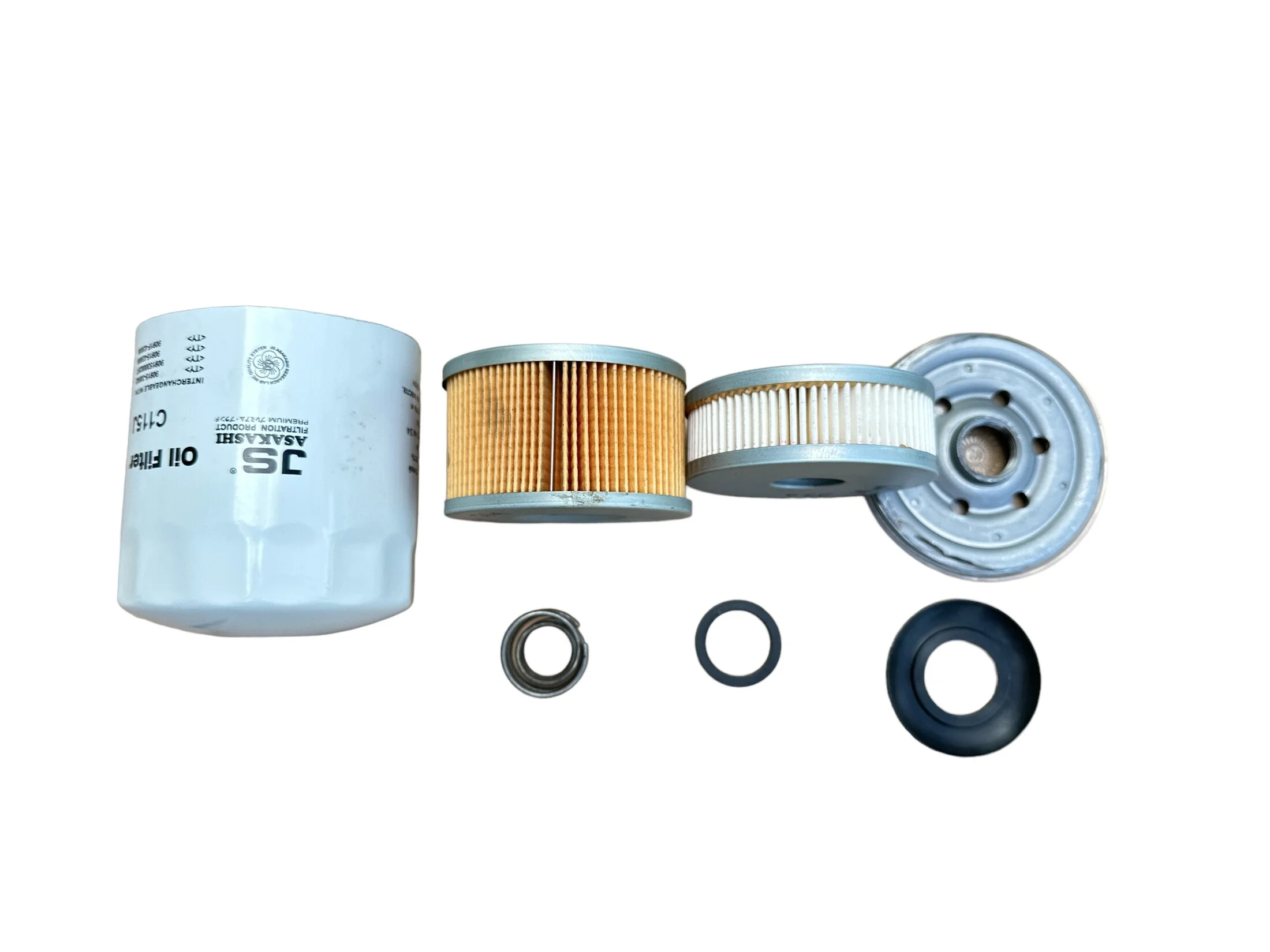

Cut away views are shown on my site where I have cut open that brand of filter. I am planning on posting a more detailed thread with all of the filters I have cut open to date for this application. There are some very good OEM and aftermarket options, so pretty decent ones, and then some that could be a fair bit better.
The JS Asakashi filter cut away is shown here in the product photos: Oil Filter - JS Asakashi C115J - Toyota models - replaces 90915-30002 - https://www.shopraddcruisers.ca/oil-filter-js-asakashi-c115j-toyota-90915-30002.html
2025 April 09 - Adding cut away photos of the JS Asaksahi oil filter.
The larger orange portion is the primary filter media, the white portion is the bypass filter media.
For the price, this is a decent oil filter - and is comparable to many of the non-OEM style filters.

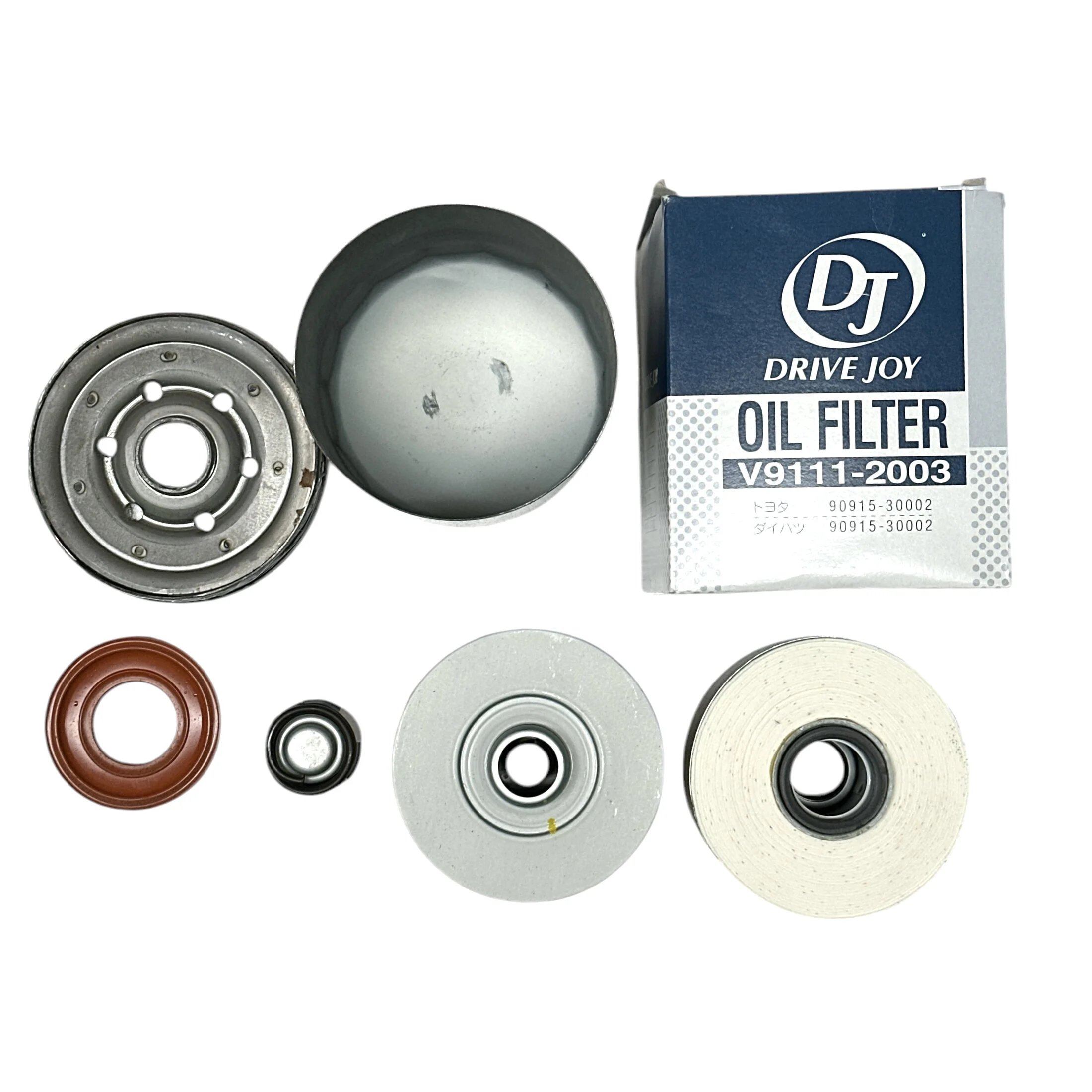

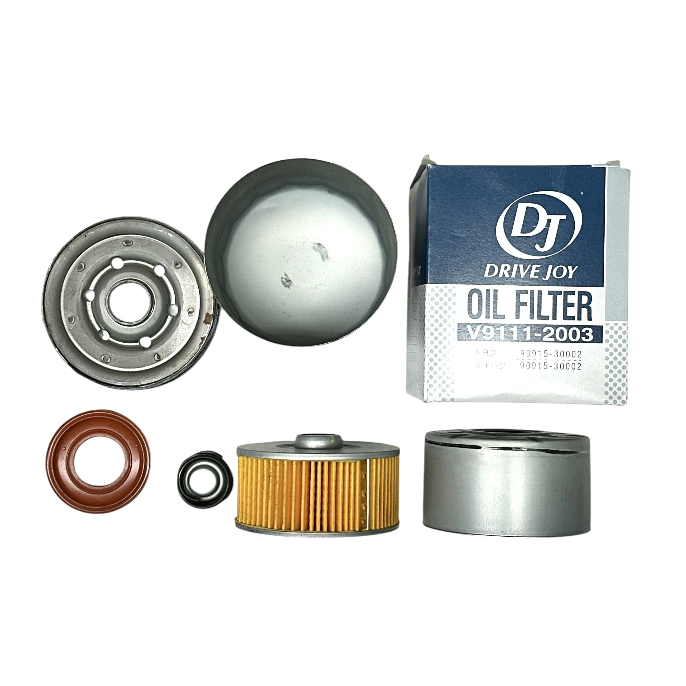

Here are a couple of cut aways of the Denso/TACTI "Drive Joy" diesel oil filter for applications using 90915-30002.

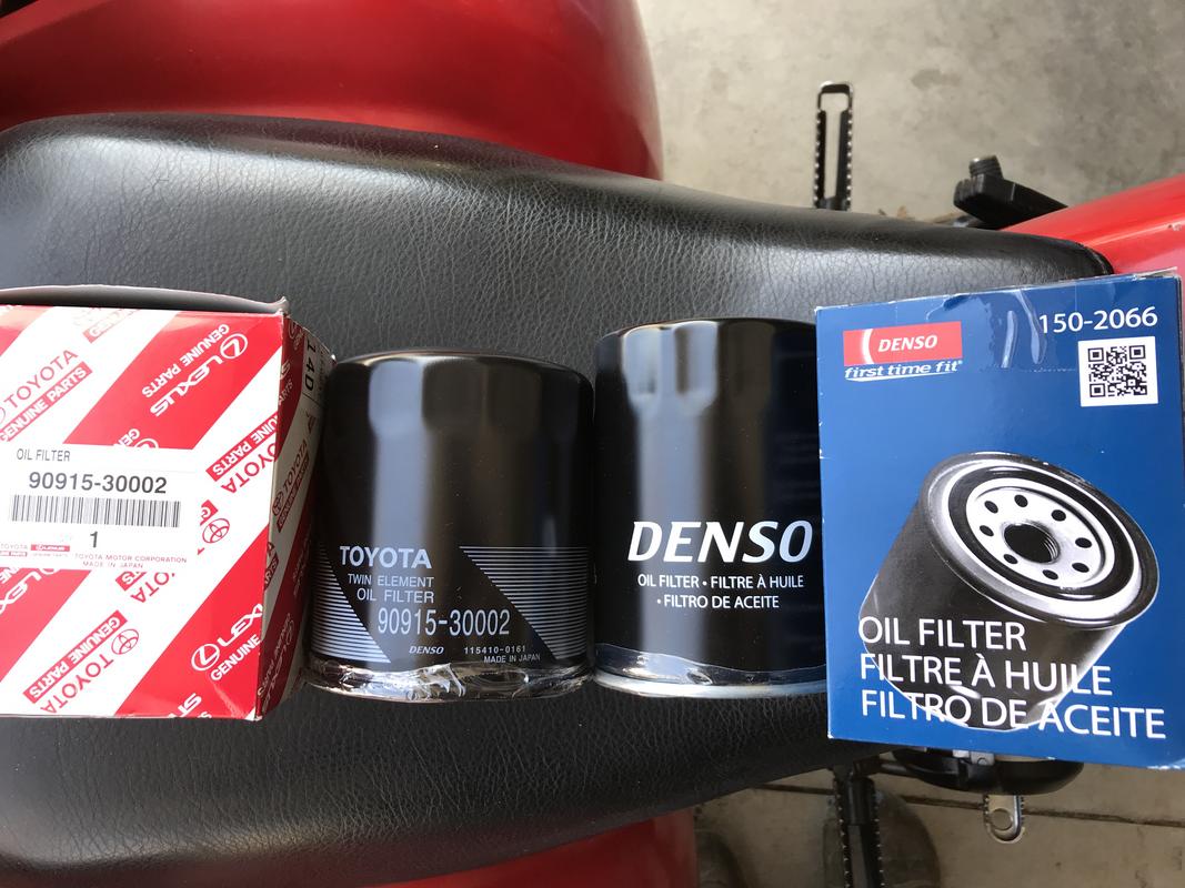

This filter is identical to Toyota 90915-30002 as it is made by Denso in the same factory that makes Toyota branded oil filters (note that Denso branding is written in smaller type on the Genuine Toyota oil filter).
Note: This filter contains the "toilet paper roll" style bypass filtration media that is found in Toyota OEM filters and some very high quality aftermarket filters. This type of filter media offers superior filtration of diesel combustion soot particulates that contribute to abrasive wear as well as potentially increasing the oil's viscosity and consuming the oil additives.
TACTI Corporation is a partnership that has been established by Toyota Motor Corporation (80% ownership) jointly with Nippondenso Co., Ltd. (10% ownership) and Aisin Seiki Co., Ltd. (10% ownership) for procuring and marketing aftermarket auto parts and accessories, as well as for participating in the car shop business.
TACTI parts are very high quality and are either identical to Toyota parts found in red and white boxes, or they are very, very high quality/OEM equivalents.
More cut open filters to come... I have a stack of them on my workbench.
