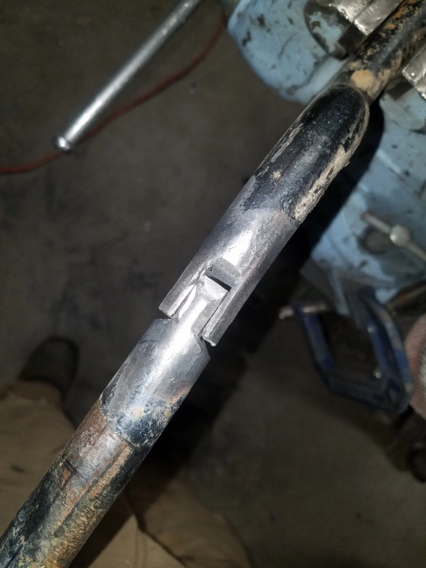

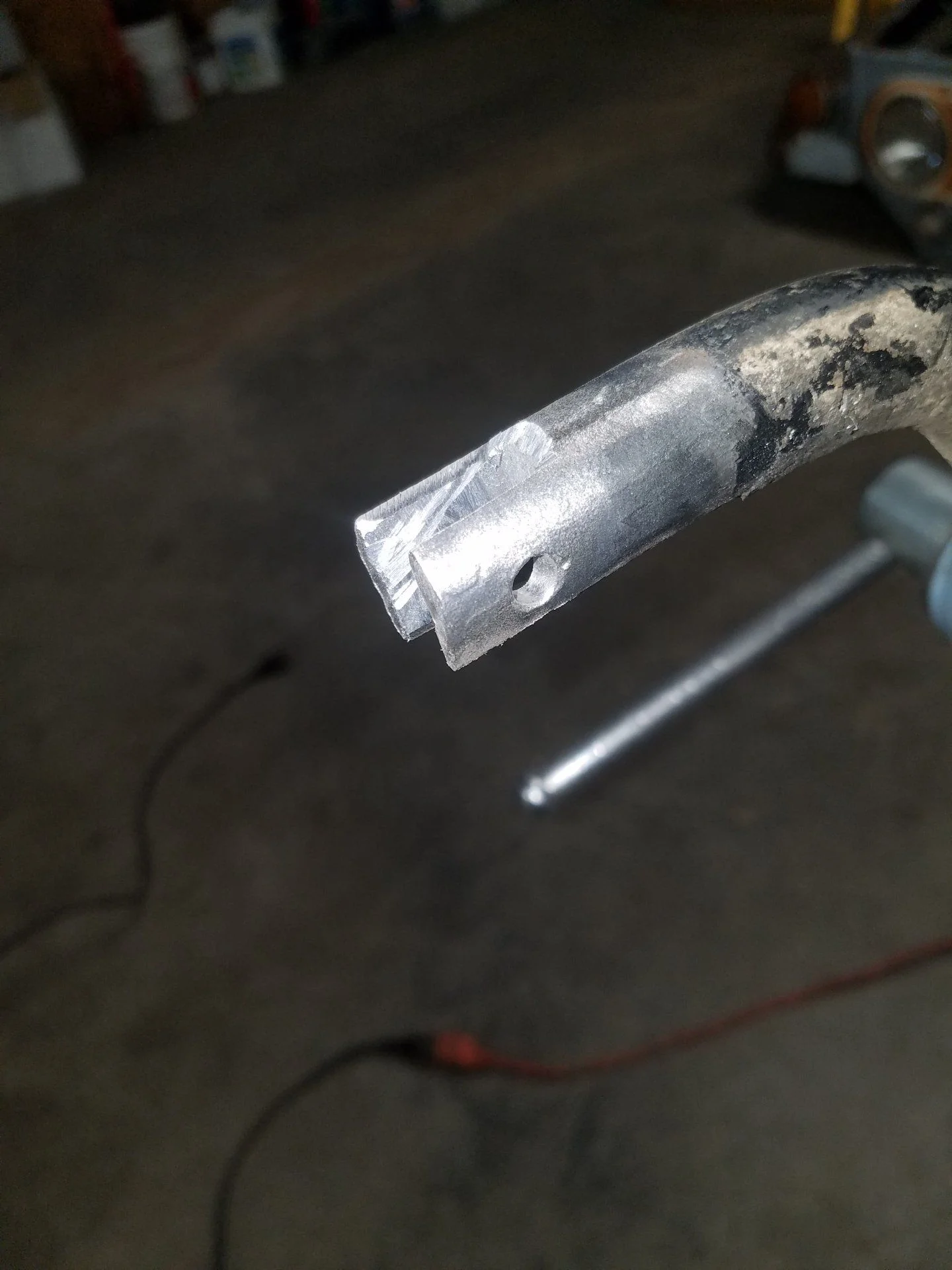

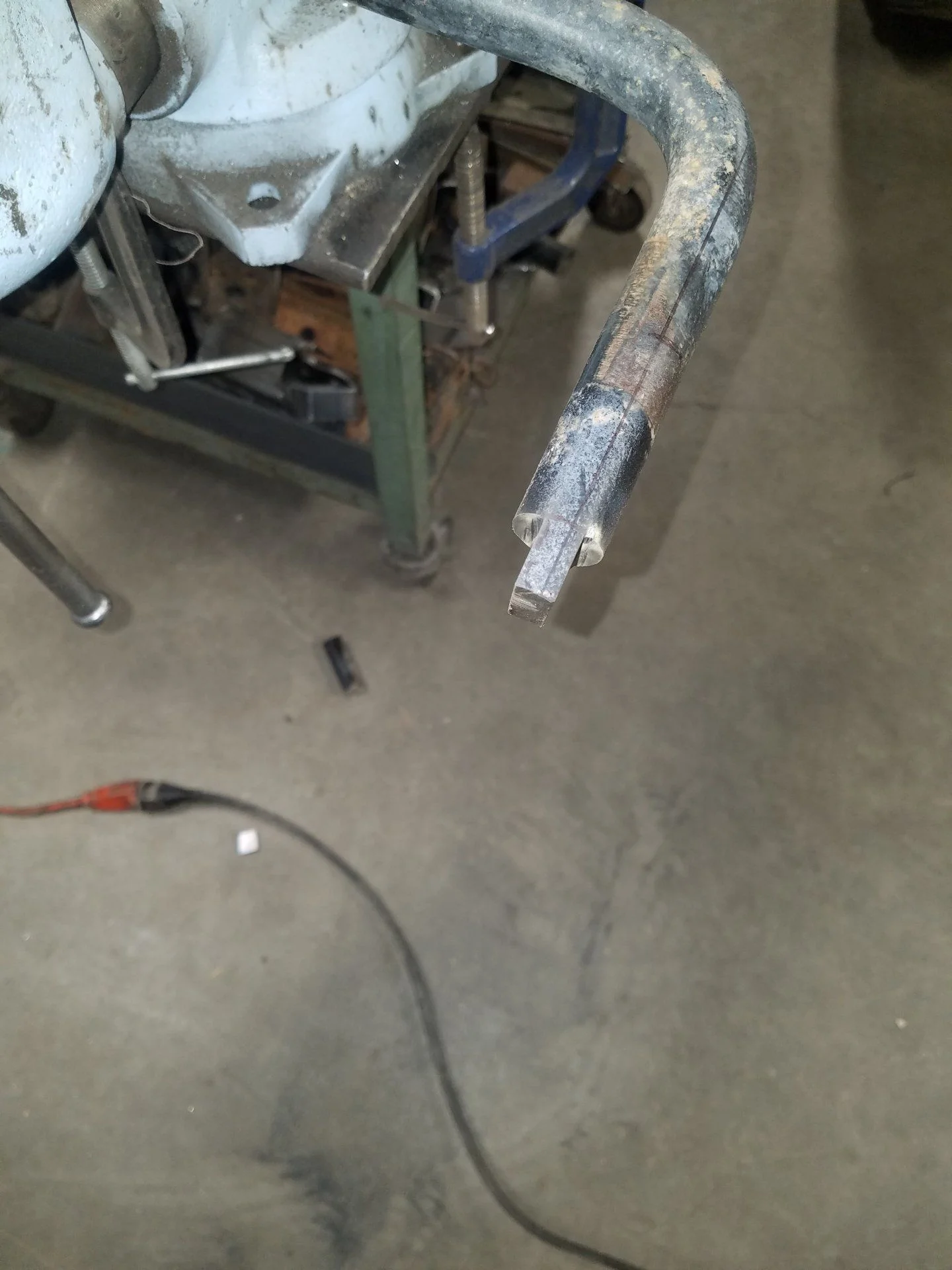

The back story. I am building a 45 that I swapped all of the 80 series suspension on. I narrowed the 80 series axles 4 inches, so in order to fit the stock sway bar I had to narrow it as well. I am planning to have the sway bar re-tempered to get the spring back in the sway bar, I assume my cut and weld has altered this. I found a shop that will do it but I need to know what the steel is, so they can temper it correctly. I used google and searched this site and couldn't find an answer.
Because everyone likes pictures I have attached my cut and weld of the sway bar.

It won't heat treat correctly. I would think straightening one side, cutting off the end, reforging the end and then heat treating would be the way to go. The whole thing needs to be heat treated at once.
@Mauser is correct; you've created a hard spot in the bar. It'll bend on both sides of that joint, and likely break the joint. It is possible to soften the entire bar, pack it in carbon and heat treat it, but the best you'll do in the joint is case harden it. What you want is hardened through.

Probably not too long, but it may last forever. Hard to say. Maybe a short sleeve over the welded area would help. Right now without any heat treat the welded area will be soft and likely to bend and most likely break next to the weld.

The welding wire probably has a 70ksi strength, while the base material will be double that. The mixing of the base and weld materials will kind of average the two out at the location of the weld. When you put it use, the sway war will bend at its weakest spot, ie the weld. I doubt it will last long at all if you do put it to use.
One possible way around that would be to sleeve the weld. I wouldn't have high hopes, but you may be able to equalize the strength well enough to get it to last.
