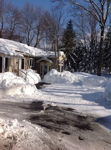

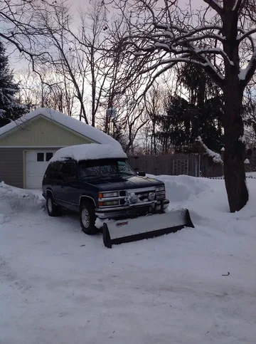

we clear our driveway with one that mounts to a front hitch.. it's called snowsport.. does a decent job, doesn't always get down to pavement but clears enough to get up and down the driveway.. takes about 5 minutes to mount the night before a storm and can be taken off just as quick to drive into town.. probably not for commercial use if that's your plan.. maybe a good option but I think lift height would affect it's effectiveness
pics (sorry it's on a chevy)
