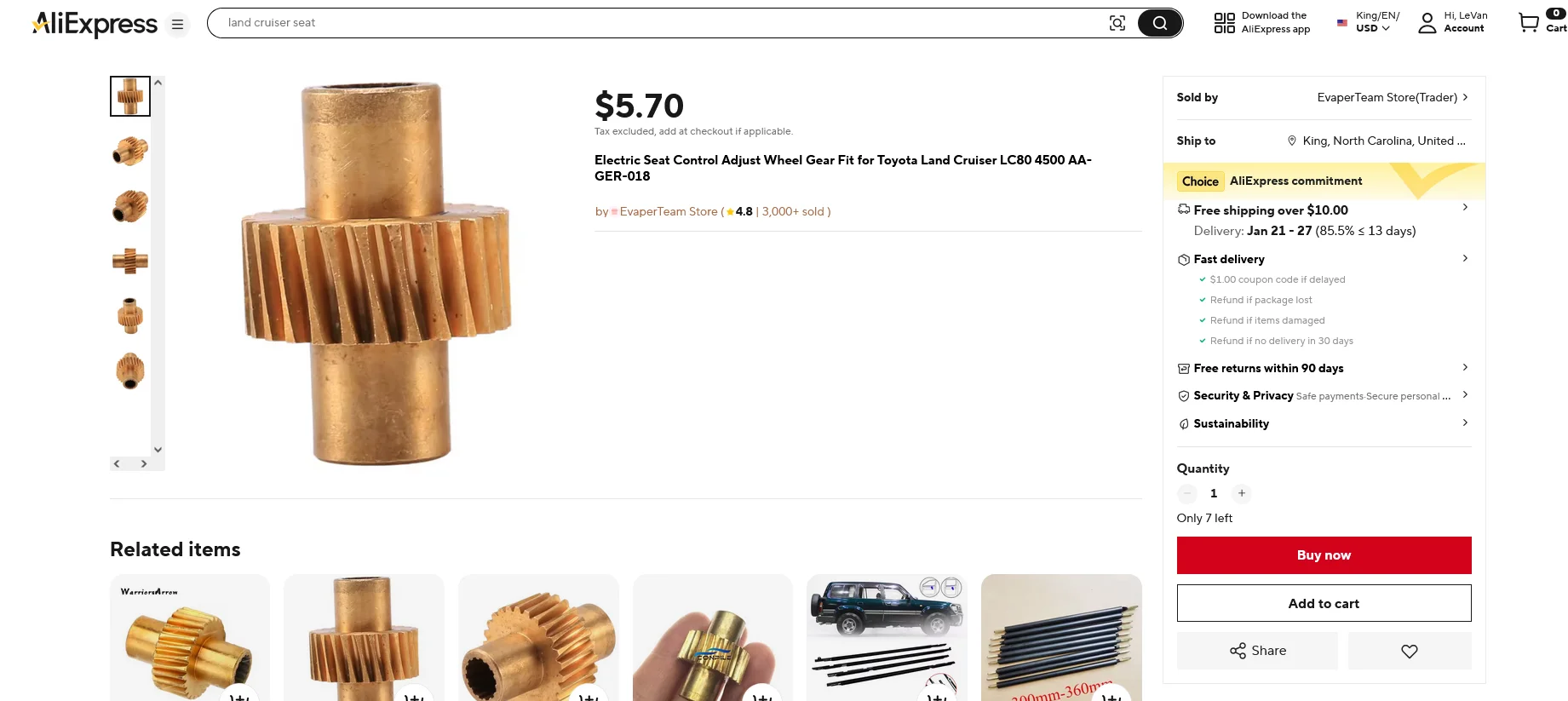

Has anyone tried/used these, or similar gears from Aliexpress? Power seat gears.

I did the gamiviti ones and a week later the driver side was jacked up again so I've been thinking about ordering the brass ones off eBay.
The passenger side still works with the gamiviti ones.
FWIW, you want the nylon gear as the "fuse" for these as opposed to the motor or some other NLA part.
you want the nylon.... it's a fusible link if you will. brass will just cause more issues.
sorry, but i think they failed do to user error.
I think that a brass gear is dangerous!
If the brass was to eat through the nylon worm gear you are screwed. You would have to try and replace that worm gear or entire drive shaft and where would you get one ?
That was my point in post #8. You want the nylon gear as the fuse because it's easily replaceable. The rest of the drive components are NLA unless you find them from someone parting out a truck.
