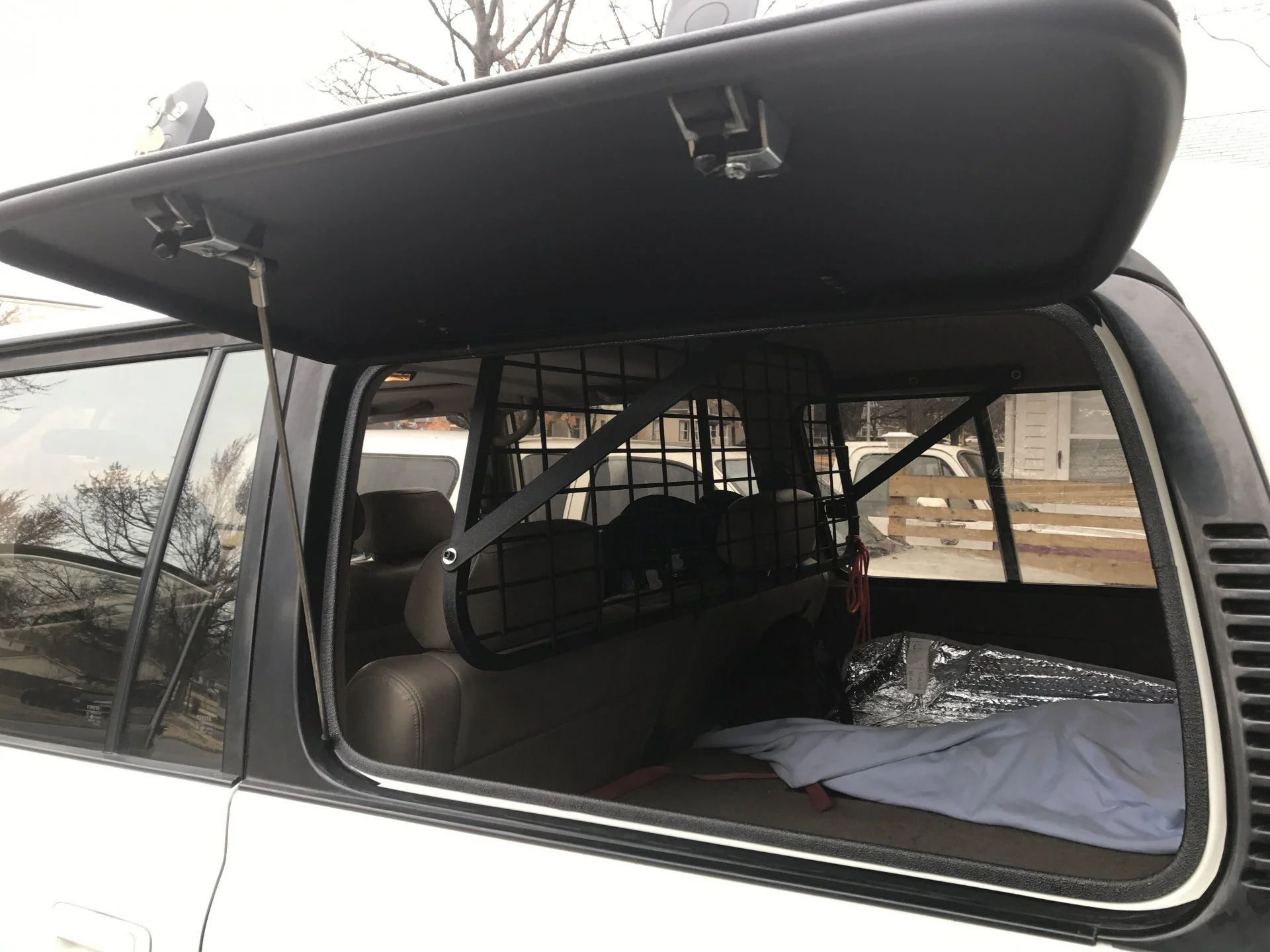

Installed the flip up window yesterday. The only trouble I had was getting the slider window out. I started at the rear of the window and had trouble, after 5 minutes of trying I moved toward the forward corner and had no problems. I used the same non marring chisels Phil uses in his video.

Yes, about an hour to install once the old window is removed.
I placed a space heater inside the cargo area pointed at the window so the hot air was forced to blow across the window for about 30 minutes before I began. The rubber weatherstripping was very warm when I began. This is probably not necessary during the summer, but probably made removing the old window easier.
I almost didn't post a picture yet because I knew Phil would make a comment about the exposed white not yet painted.

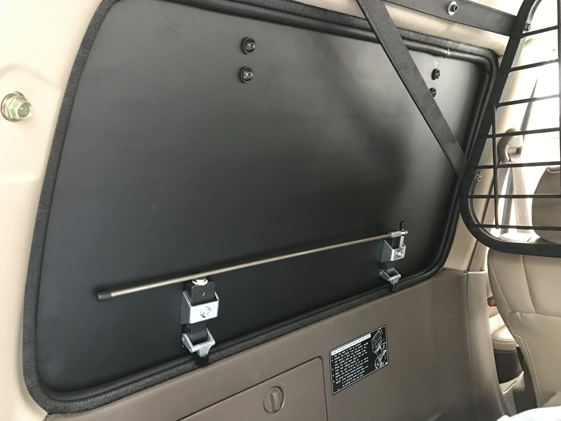

Got my flip up installed this morning. It was pretty straight forward - the hardest part was the layout of the hinge holes and committing to drilling them. But everything worked out perfectly.
Thanks @LandCruiserPhil for a high quality product. Every piece of this window feels super solid. Looking forward to putting it to use.

Another picture perfect install, nice job @Shwing !

This is an odd question, but would you mind posting the installation instructions? I'm having a hard time figuring out how the hinges attach to the body.
