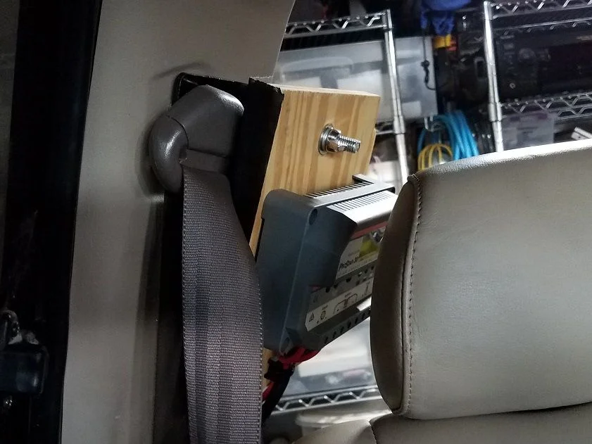

Last weekend's wheeling trip involved the neighbor boys so I had to throw one of the 3rd row seats back in. This caused some grief with my hillbilly plywood solar mount and my Water Brick/Puma Mount. I removed the Puma mount just fine and after an hour of staring at it, I re-purposed an old Jeep bumper bracket I scavenged from my neighbor's never-ending bumper swap project and managed an offset mount that allowed me to put the 3rd row belt in and retain my solar mount. The lift gate clears and the seat clears in the reclined position. It's very solid and has me thinking about what to do when the D-Pillar mount is in place.
Is this something that could be incorporated into your production D-Pillar mount? Something to accommodate the 3rd row belt should Life come knocking and screw up one's truck plans? I know the 3rd row is where the D-Pillar mount will actually mount. I was thinking a longer seatbelt bolt combined with some sort of bolt/sleeve/nut pass-through mount nut thing may work to retain the D-Pillar mount AND the seat belt should it be required. What say you?
I was able to reinstall the belt retractor with no issue which was nice. :P
@Dissent There is both a structural and liability issue. I'm worried more about the structural. In a word I would say no. That being said, I've designed enough into the D-Pillar that it will disconnect easily.

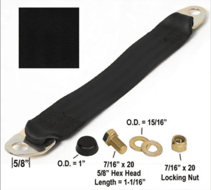

I found a solid solution to extend seatbelts if need be (see pic).
I figure between my awesome Jeep bumper bracket that is in place now and something like that, I should be able to make something work that's still very safe.

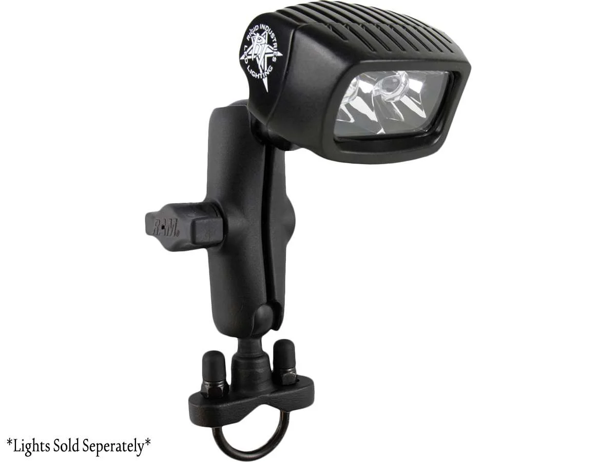

You think it would be compatible with RAM mounts? Give lighting and other accessories more articulation?
