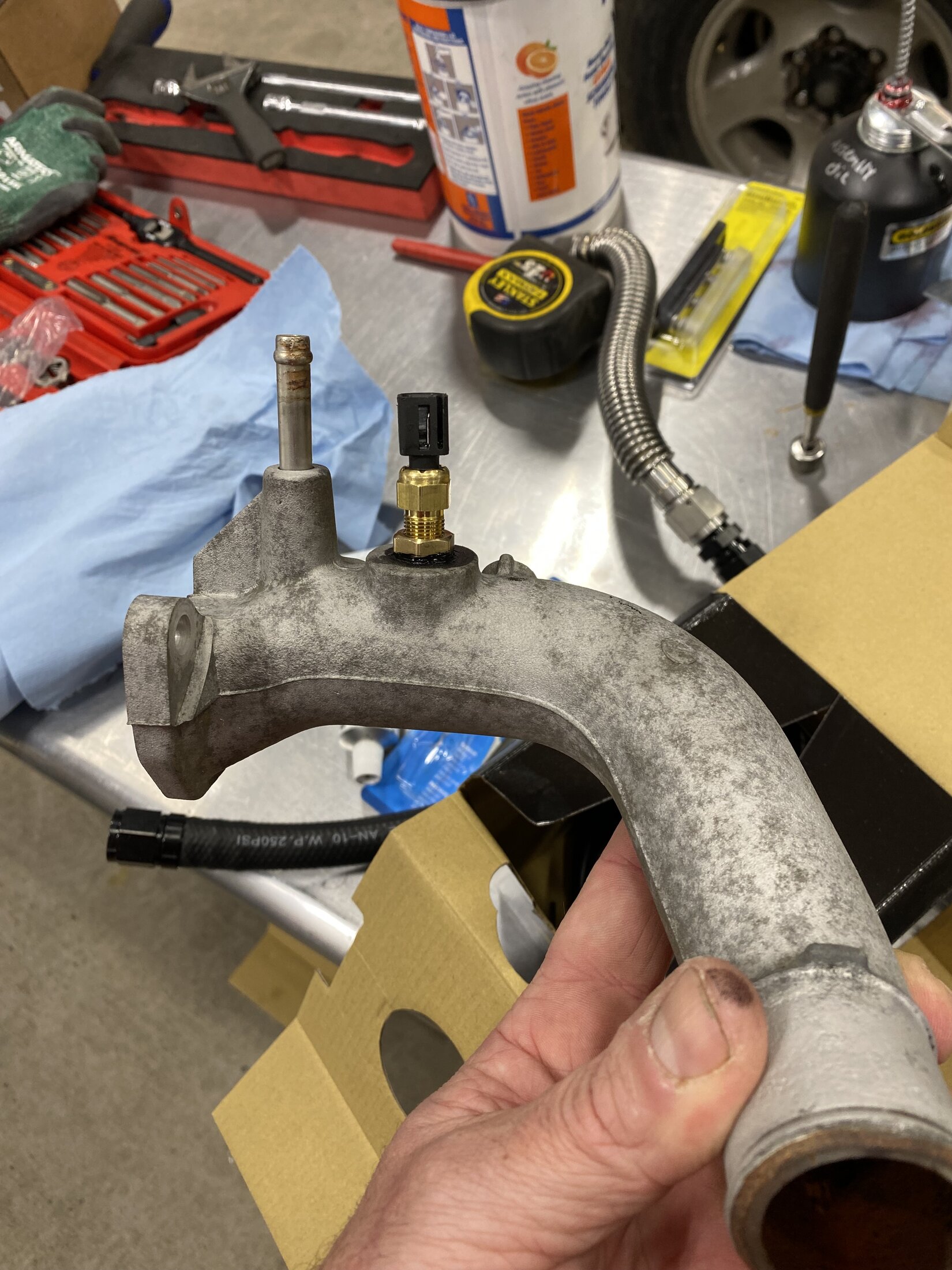

I have a stand alone temp gauge as well.
(JRP 14in1). The sensor is in the outlet tube coming off the head. It’s consistently about 4* hotter in temps.
Is either wrong, NO. They are just reading from different locations.
It’s more important to notice a rise, or creep, in the temp read outs than just the consistent numbers from a particular location.

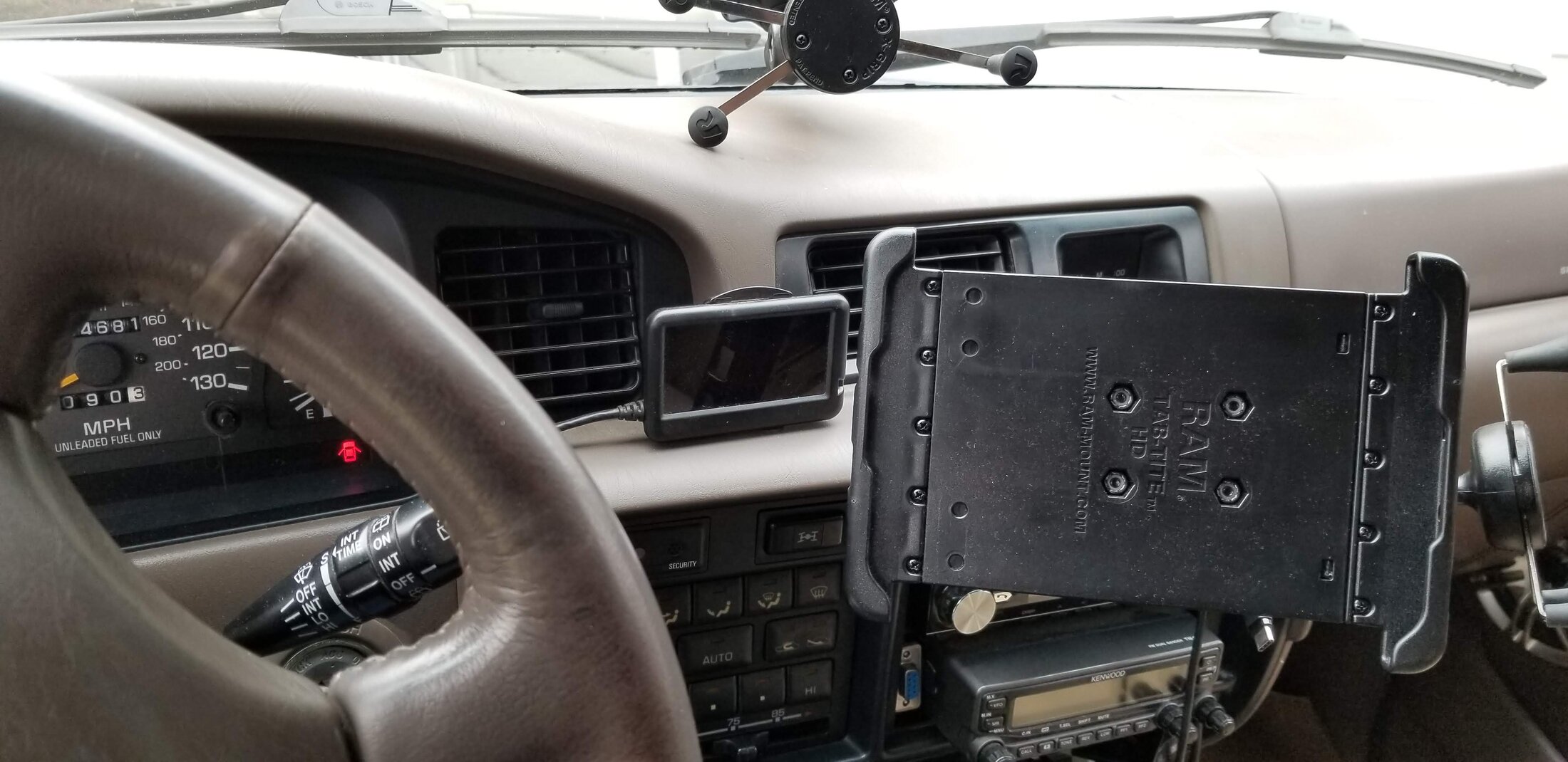

Personally, I monitor coolant temps with an Ultragauge mounted on my dash. It has a small footprint and gives me all the useful data I need. Also keep in mind that the available data from these older OBD2 ECUs are somewhat limited. Whatever reader you decide to use will have more available "gauges" than the ECU will support.
In any case, what I look for is a change of temperature range over time as opposed to instantaneous reads of temp. I know the operating range of the OEM thermostat is 180F-203F, so as long as I'm within that range according to the OBD2 reader, I just go about my day.

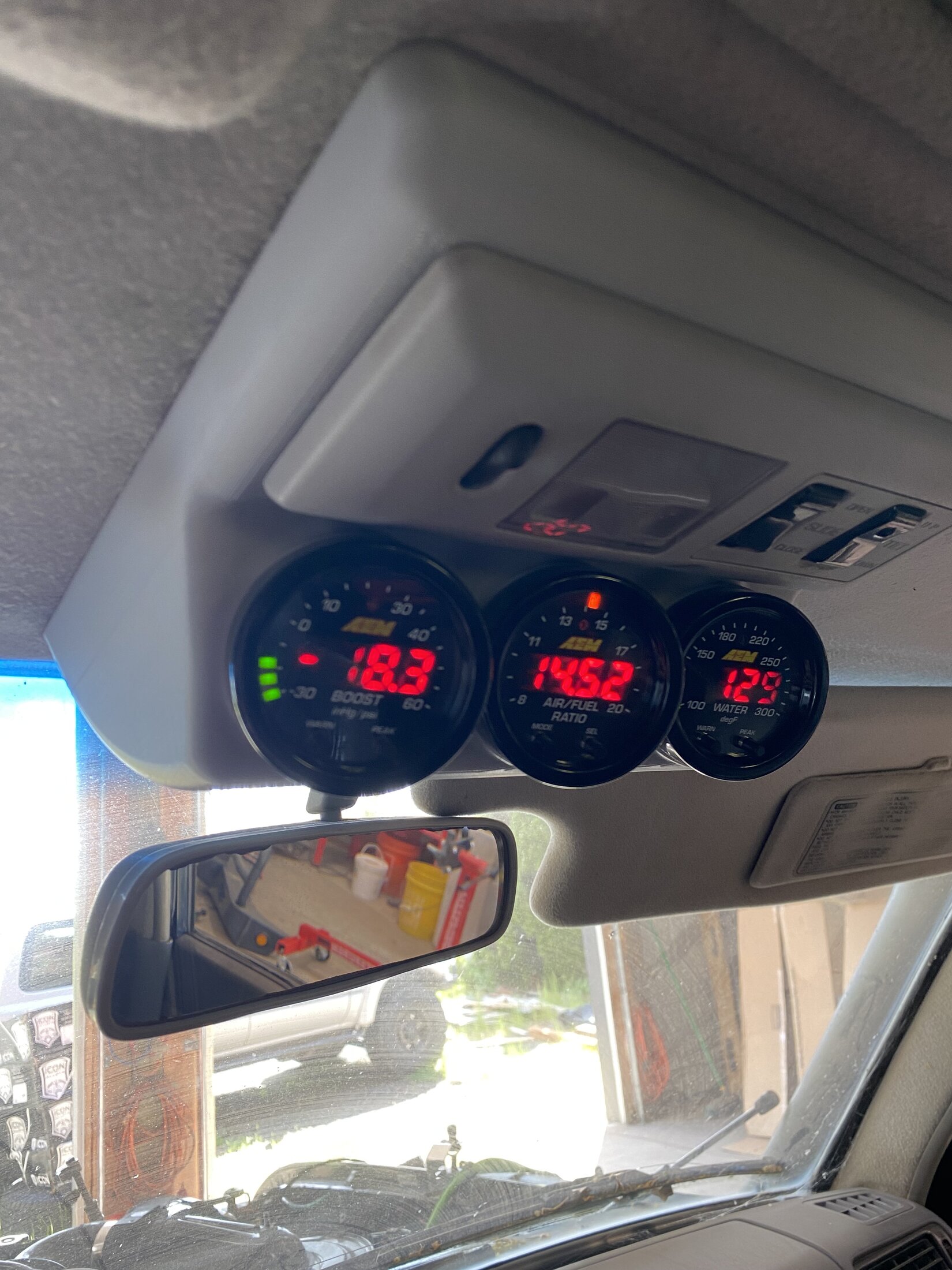

I have a scan gauge and a aem temp gauge with sensor in the outlet of the head. It’s reads 3 degrees hotter. Temps usually 187 to 190 for day to day driving.
