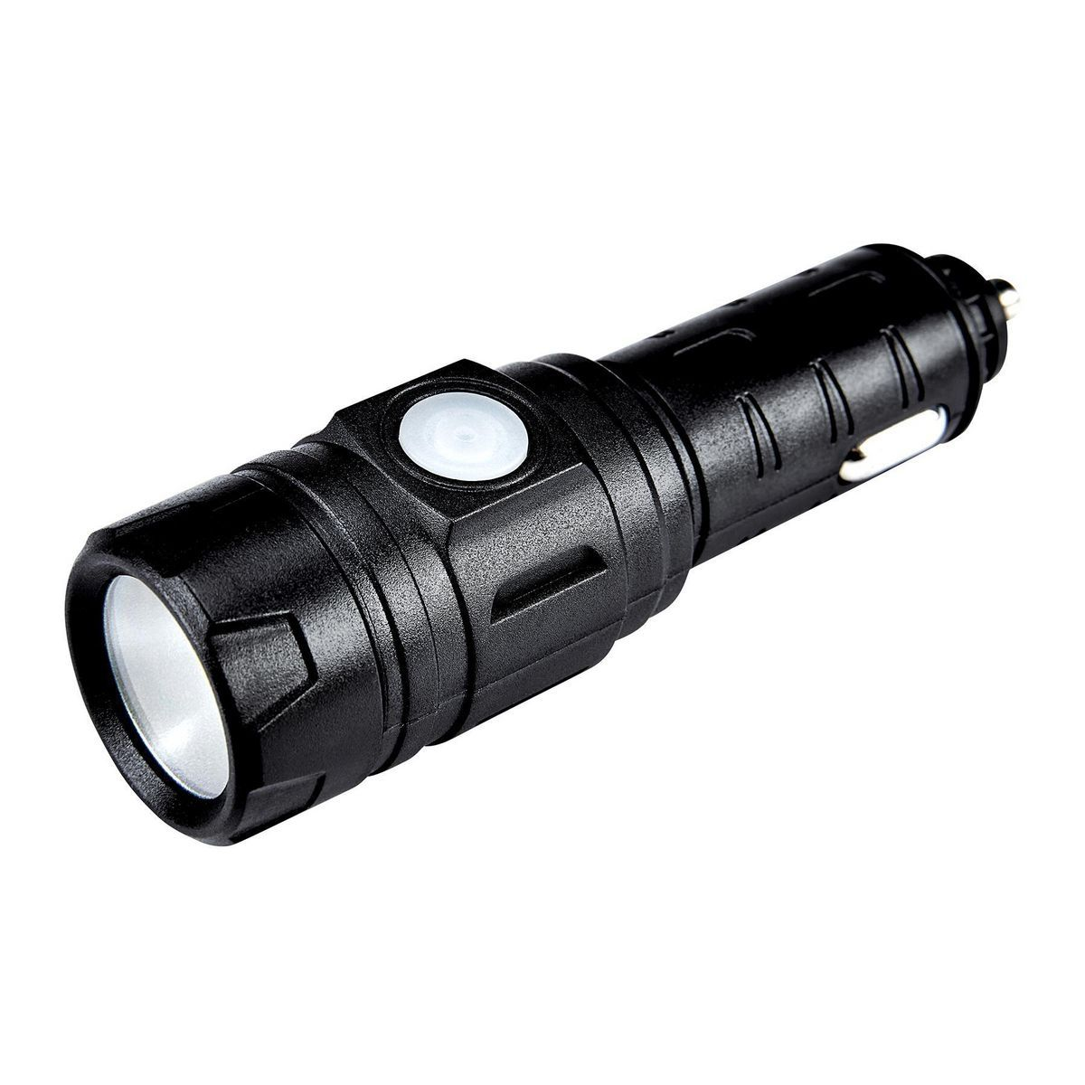

I have the OE cig lighter up front and ran 4 AWG to the rear for my fridge and other accessories. I included a cig lighter at the rear and while it is rarely used, I ran across these in HF the other day.
