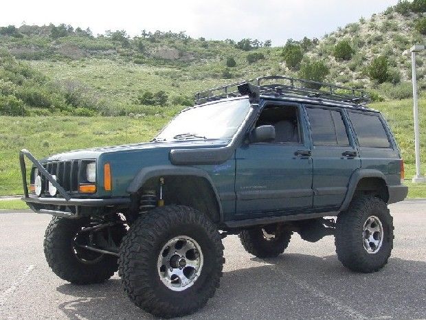

A Jeep XJ, for example has 7 degrees as optimal factory spec. So why not 2-4? For starters, that vehicle doesn’t have radius arms and it also comes factory with a y-linkage steering setup (relay is attached directly to tierod). That means toe changes with suspension compression and there is terrible vulnerability to bump steer. We don’t deal with either of those things.
I converted an XJ to a long arm radius setup with a custom Dana 44 axle and we deliberately set caster at 2 degrees so avoid quick/touchy steering on a big lift at speed. This worked perfectly 5 degrees under factory spec in conjunction with a crossover steering linkage (like what we do with high steer).

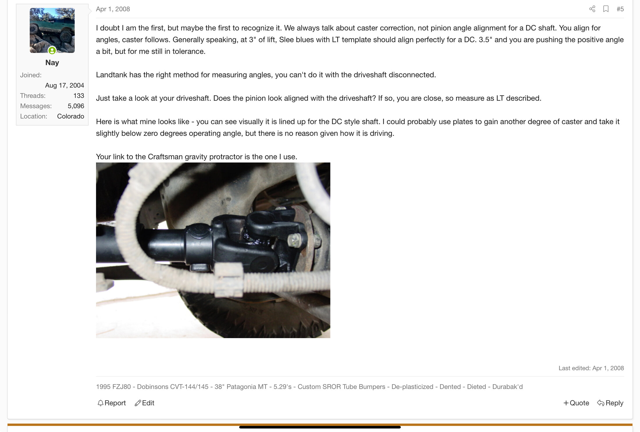

Again, I think what is missing here is that if you convert the broken back (high angle pinion on a stock 80) oriented driveshaft to a double cardan, simply aligning the double cardan shaft to proper pinion angle requires rotation of the pinion down, which increases caster, and that offsets the upward rotation of the pinion when lifting. At my lift height you will have exceeded that correction, but it doesn’t mean you’ve just gone wildly negative on caster. At 4” of lift this simple modification will keep you within factory caster spec. It will not put you outside of caster spec on the high side, which we seem to believe is better even though it is out of spec. Anybody who lifts their 80 (within a range) and doesn’t take advantage of this simple mod and instead chooses driveline vibrations with a stock driveshaft…that’s on you.

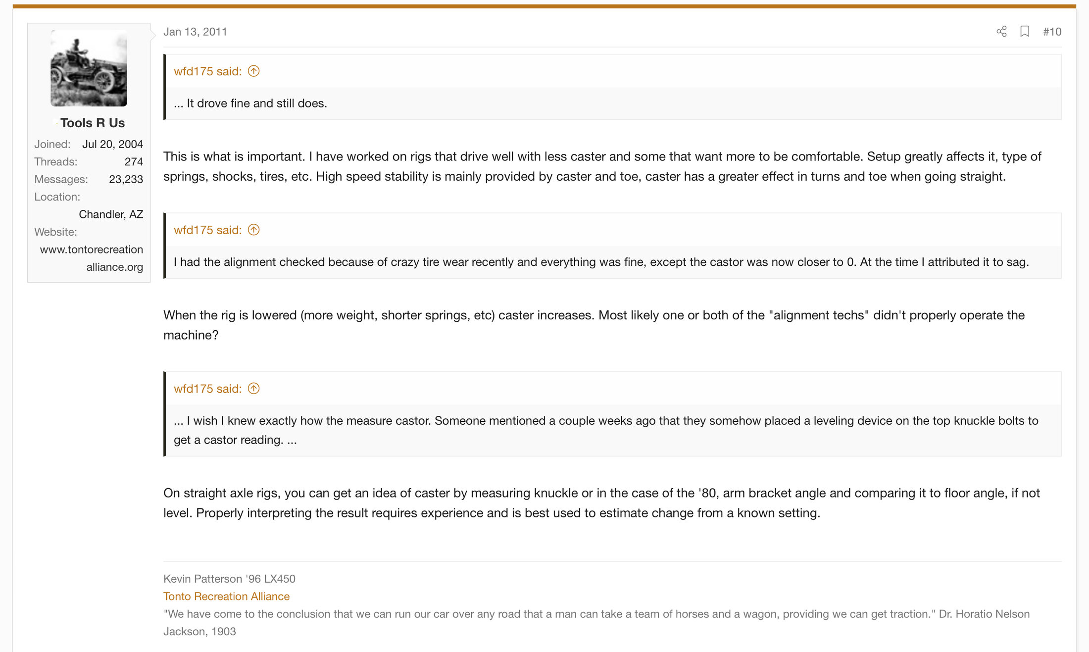

Our dearly departed friend is sorely missed for his common sense perspective. “Setup greatly affects it, type of springs, shocks, tires, etc.” is spot on - that’s the point that what you feel on your rig is not going to be consistent with a very different setup.

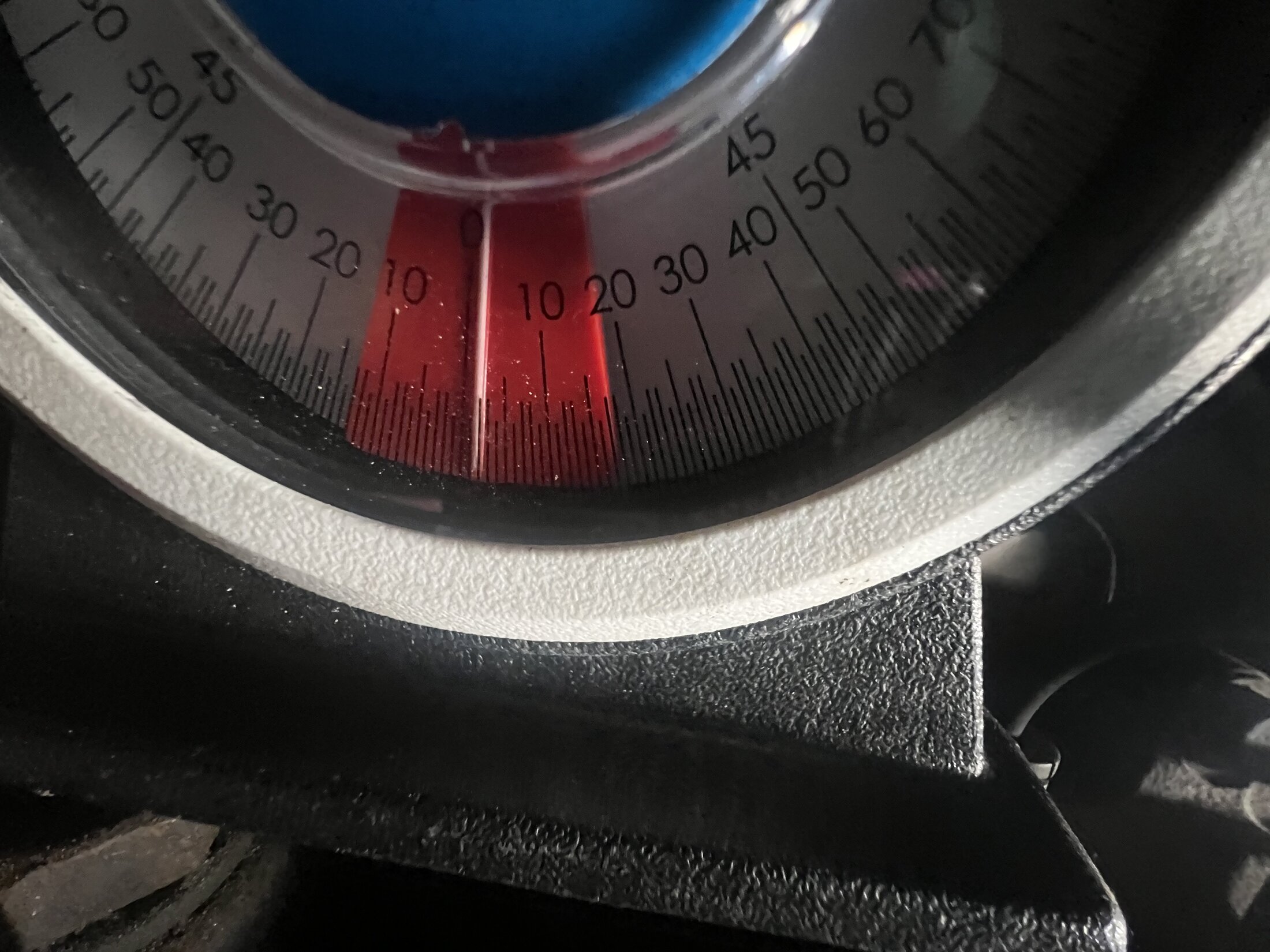

Also, this isn’t really a full measure of caster, but just gut check kinda stuff. Measured on the trunion cap bolts on zero degree garage ground.
