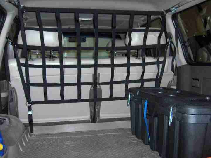

So, I flipped the net, and put to use some of Eddie's installation suggestions, modified slightly based on what the interior of the rig afforded me from an attachment standpoint. I was VERY pleased with the outcome. The net was much tighter now and fit well IMO, even without using the footman loops.
In the end I ended up with the following final installation method as you will see in the pictures:
(1) Attach the top most net rings to the 2nd row rear grab handle and to the 3rd row grab handle on each side of the rig. I attached the strap that comes pre-attached to the top rings to the 3rd row grab handle and then used one of the additional straps I purchased to loop through the ring and around the 2nd row rear grab handle. You can adjust the position of the top of the net to sit right behind the rear seat by simply adjusting the straps.
(2) Attach the second top net ring to the 3rd row grab handle using the strap that comes pre-attached to the net ring.
Detailed view of the top net attachments
(3) Attach the bottom net ring to the cargo tie down loop using the strap that comes pre-attached to the net ring.
(4) Attach the 2nd net ring up from the bottom to the 2nd row outside seat hinges. To accomplish this I again used a set of the additional straps I purchased to lenghten the straps that come pre-attached to the net rings. This allowed me to loop the lengthened strap around the seat hinge and back to the buckle on the pre-attached strap.
Detailed view of the bottom net attachments
Here are a couple more pictures showing the final installation of the net:

Some additonal thoughts on the net and installation. First off, the net seems to be of very high quality. It is light years better than the metal doggy barrier I was using. It isn't cheap, but when compared to something like the Milford barrier it seems like a good compromise, especially for someone like me that may only use the net on 2-3 trips per year. Personally, I strap anything real heavy like recovery gear etc. to the cargo floor so I need the net to stop lighter stuff like sleeping bags, clothes, etc. I like the fact that I can install the net in just a few minutes and remove it even quicker.
As for the installation. As mentioned, IMO the 80 series interior doesn't really lend itself to using the footman loops, especially on the lower trim areas where the plastic trim becomes bulkier. I think if a person really wanted to have an ultra tight install attached to the body of the rig, that it would be better to fab up some brackets that could be installed using the grab handle bolts, seat belt mounting bolts, and the seat frame bolts. On one end of the bracket would be a bolt hole to secure the bracket to the body and on the other end of the bracket would be a slot for the strap to pass through for attachment. I don't see the necessity to go this far unless I planned a more permanent installation of the net. I saw no deflection in the grab handles when I installed the net so IMO they are plenty strong for this use.

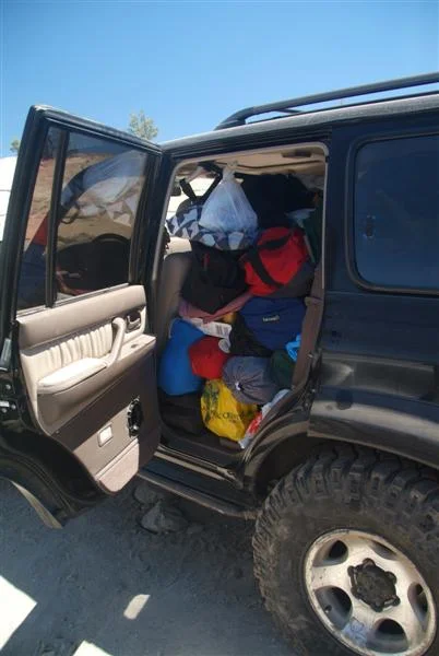

The net was used on a recent trip to California to run the Rubicon during TLCA's annual Rubithon. The trip was a BLAST and the net did great. See the picture below. The net really is there, you can just barely make it out in the picture. We found all sorts of useful things for the net to do aside from just keeping stuff in the back of the rig :) - It came in handy to tie stuff to it and to hang stuff off of it.
I can say the net has been Rubicon tested and did its job well :drive:
