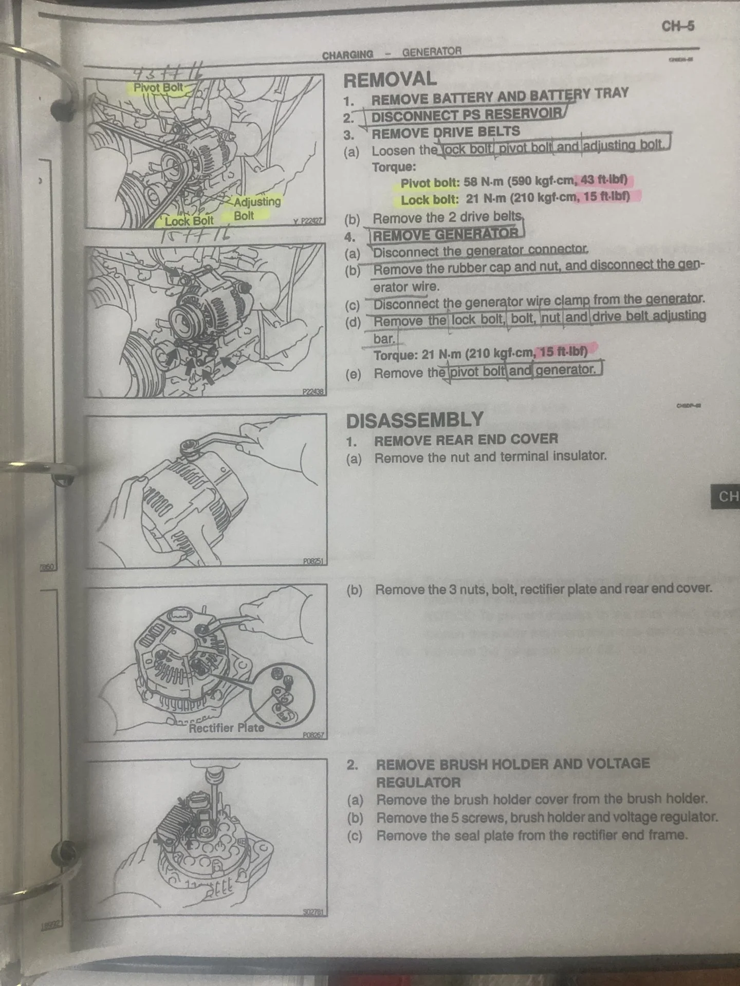

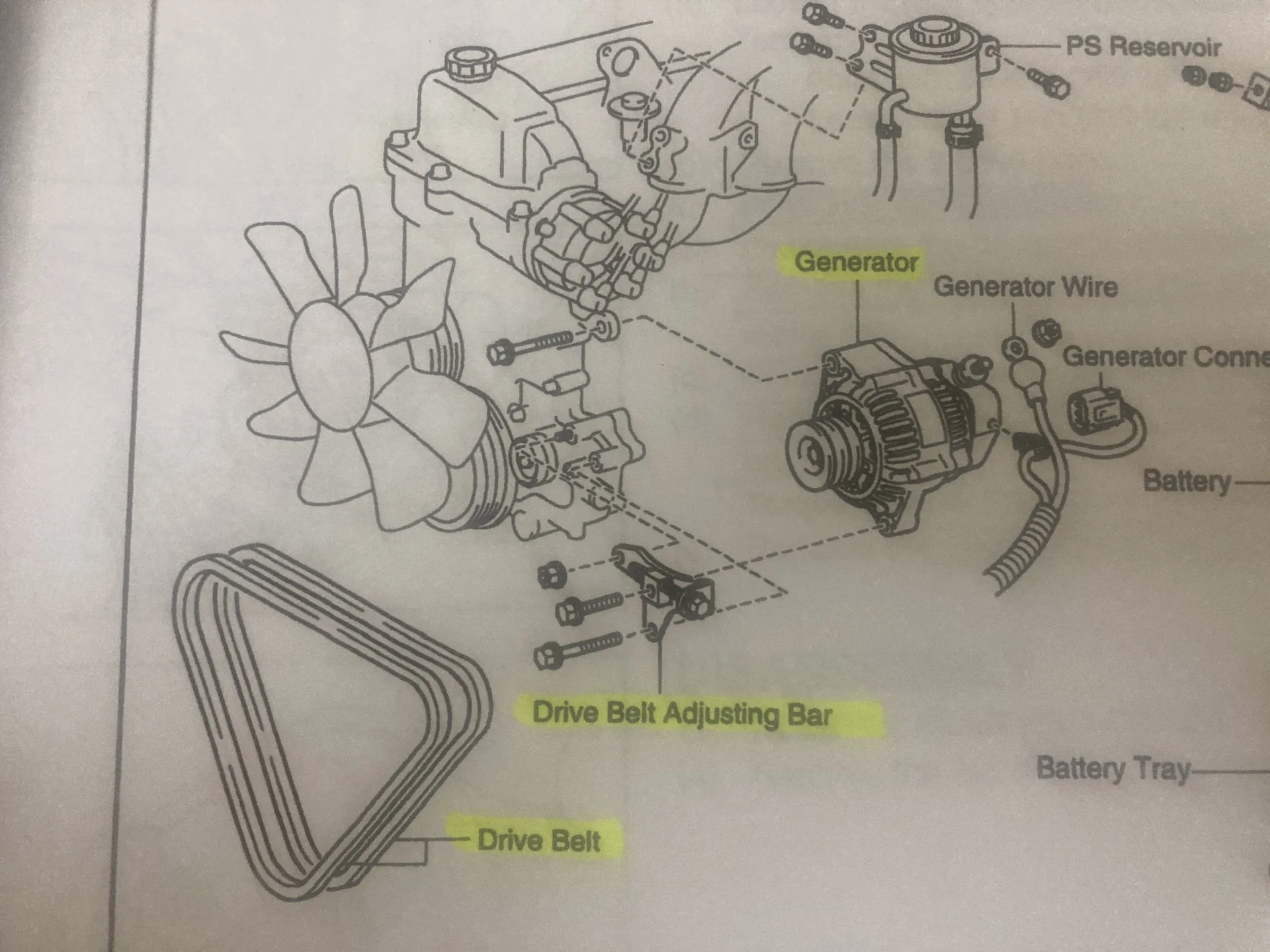

there's nothing in the FSM that i could find on this and nothing on mud either. anyway here is a breakdown for the noobs who may have not done this one before.

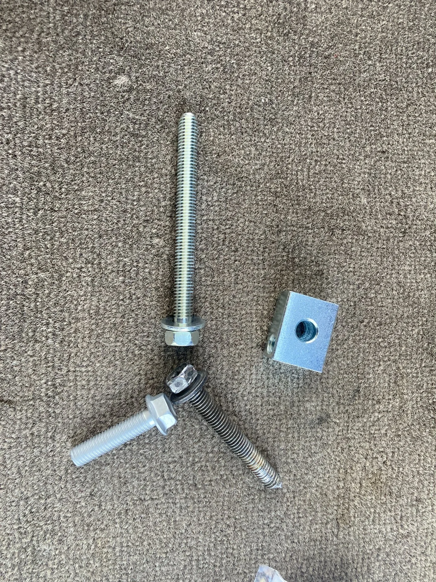

if i did it again i would order the two bolts and the tensioner block up front. chances are the tensioner bolt is at least partially stripped like mine was. so you may as well change them because someone before you probably ****ed it up.

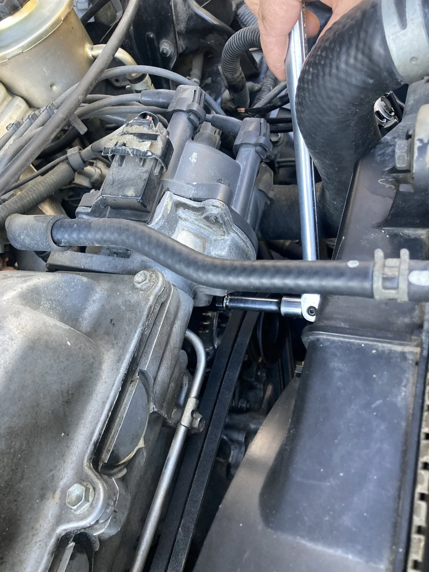

take out the tensioner bolt. unscrew it fully counterclockwise and just worm it around all the hose and pipe in the way until you can take it out. definitely remove the battery box. it's not even up for debate if this is your first time in there with this. then take off the tensioner block by removing the tensioner block bolt. use a mirror if you have to to find it.
if you removed the tensioner pulley and tensioner pulley bolt (supposedly it is not doing anything except sitting there waiting to seize up and tear up your belts...) this will all be easier. anyway also fully loosen the alternator PIVOT BOLT on the top left. also use a mirror to find it if you have to.
the deal is there is the pivot bolt (14mm 43 ft-lb). if it is not loosened the alternator can't move when you tighten the alternator tensioner bolt and you will strip the threads of the tensioner bolt, the tensioner block or both. or you will just shear off the bolt completely like i did. the alternator also won't move when you /loosen/ the tensioner bolt if you don't loosen the pivot bolt first - but you won't know this and it won't strip anything since you are just loosening a bolt. basically the belts just won't go slack like they should (if they were still on there that is).

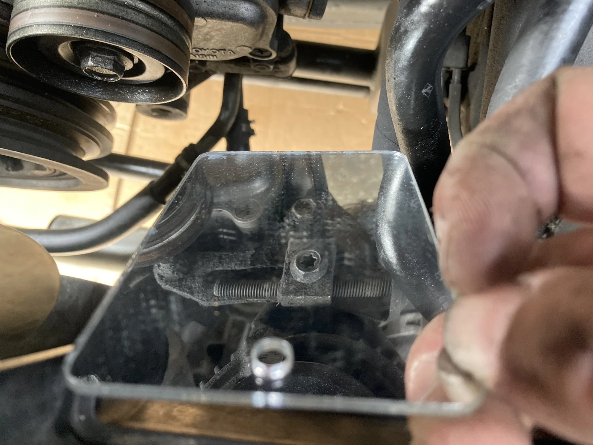

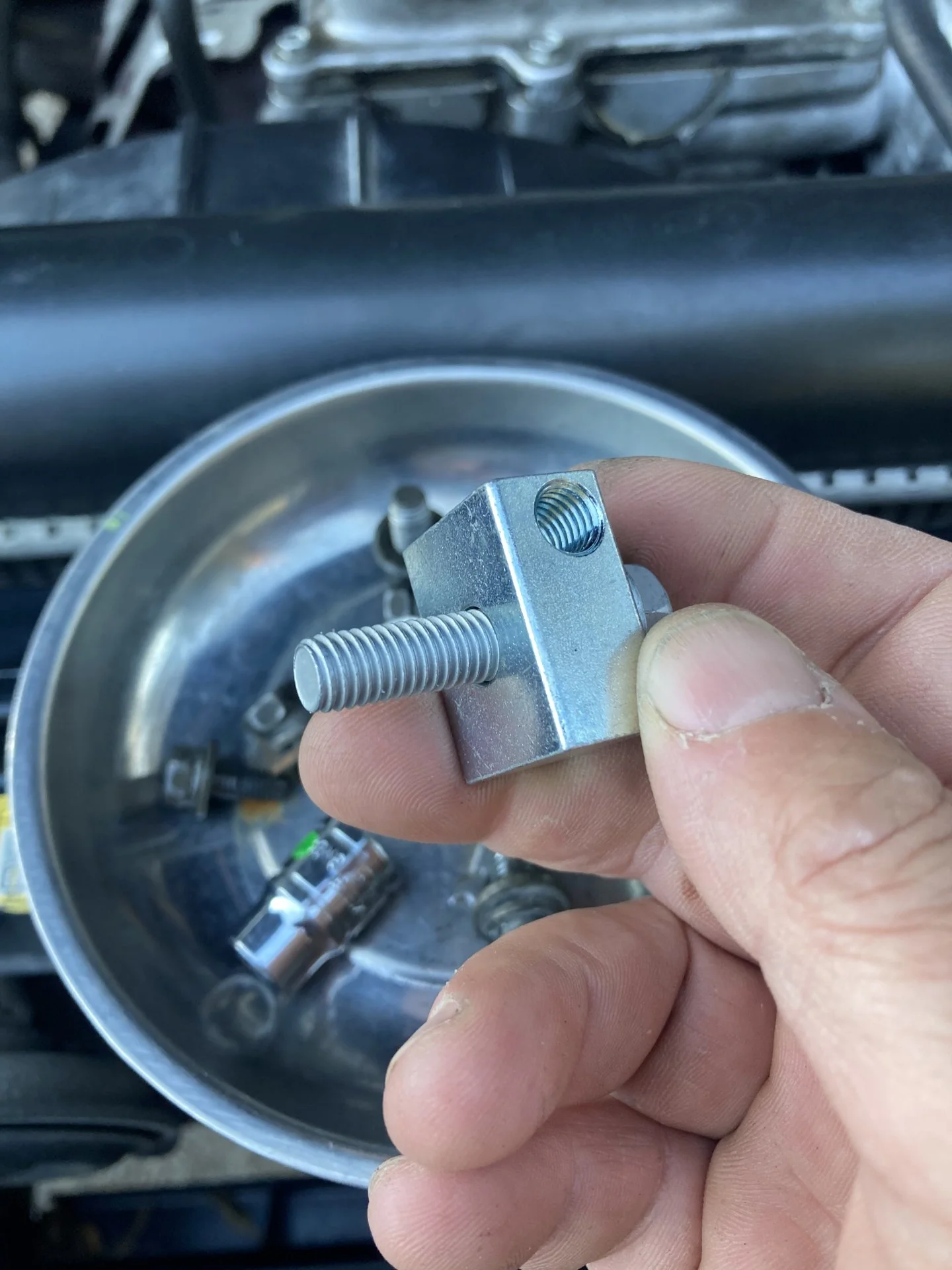

also loosen the bolt that slots through the tensioner block (it doesn't thread into it) so it just is loosely sitting in the alternator housing. what this bolt does is secure the tensioner block and tensioner bolt to the alternator to secure the alternator to the tensioner assembly that is bolted to the block. if you don't loosen this you will be turning the tensioner bolt to tighten the belt (by bringing the alternator pulley towards you) but the alternator and tensioner block won't be moving because they are fixed to the tensioner assembly that is itself bolted to the engine.

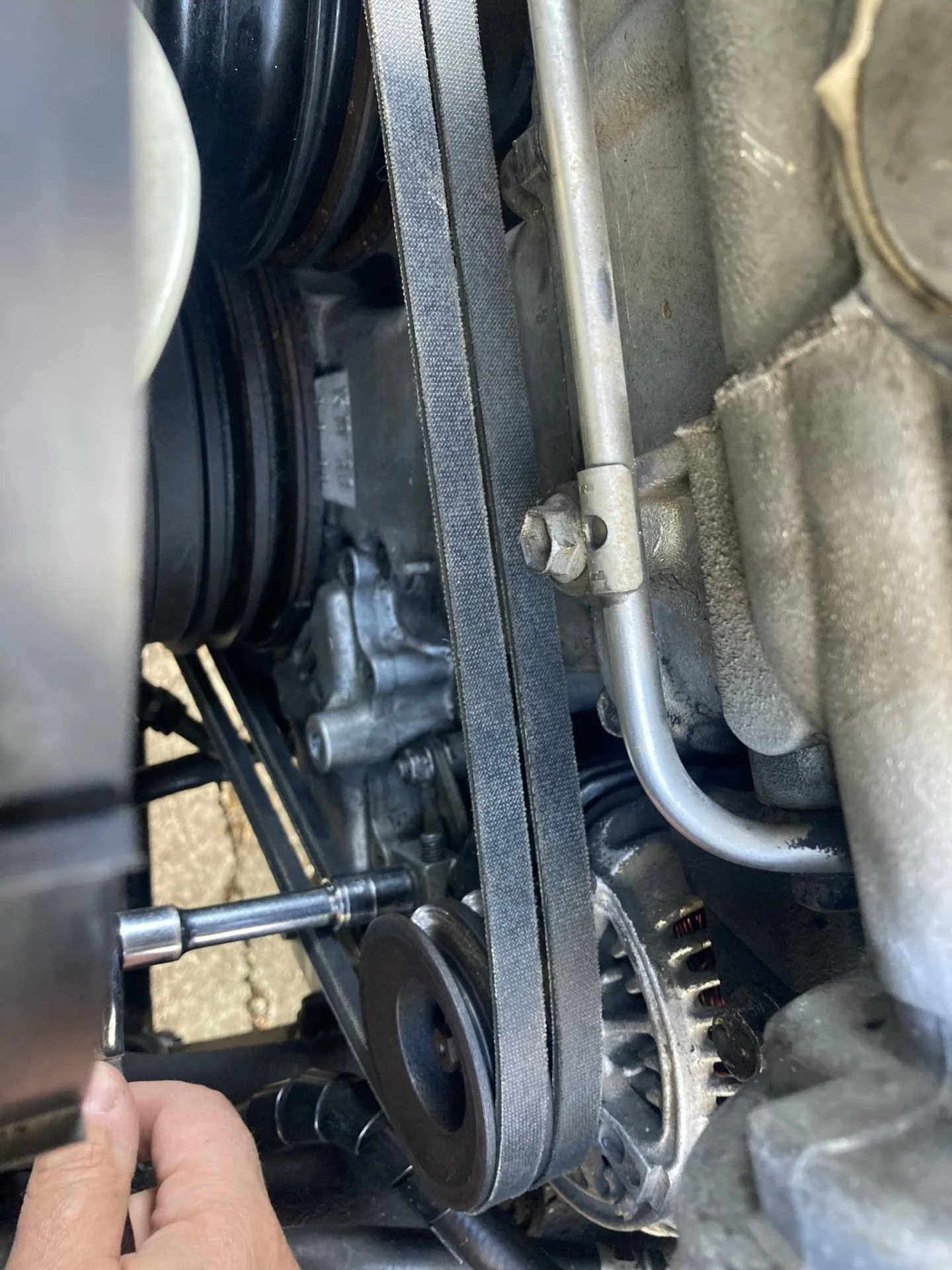

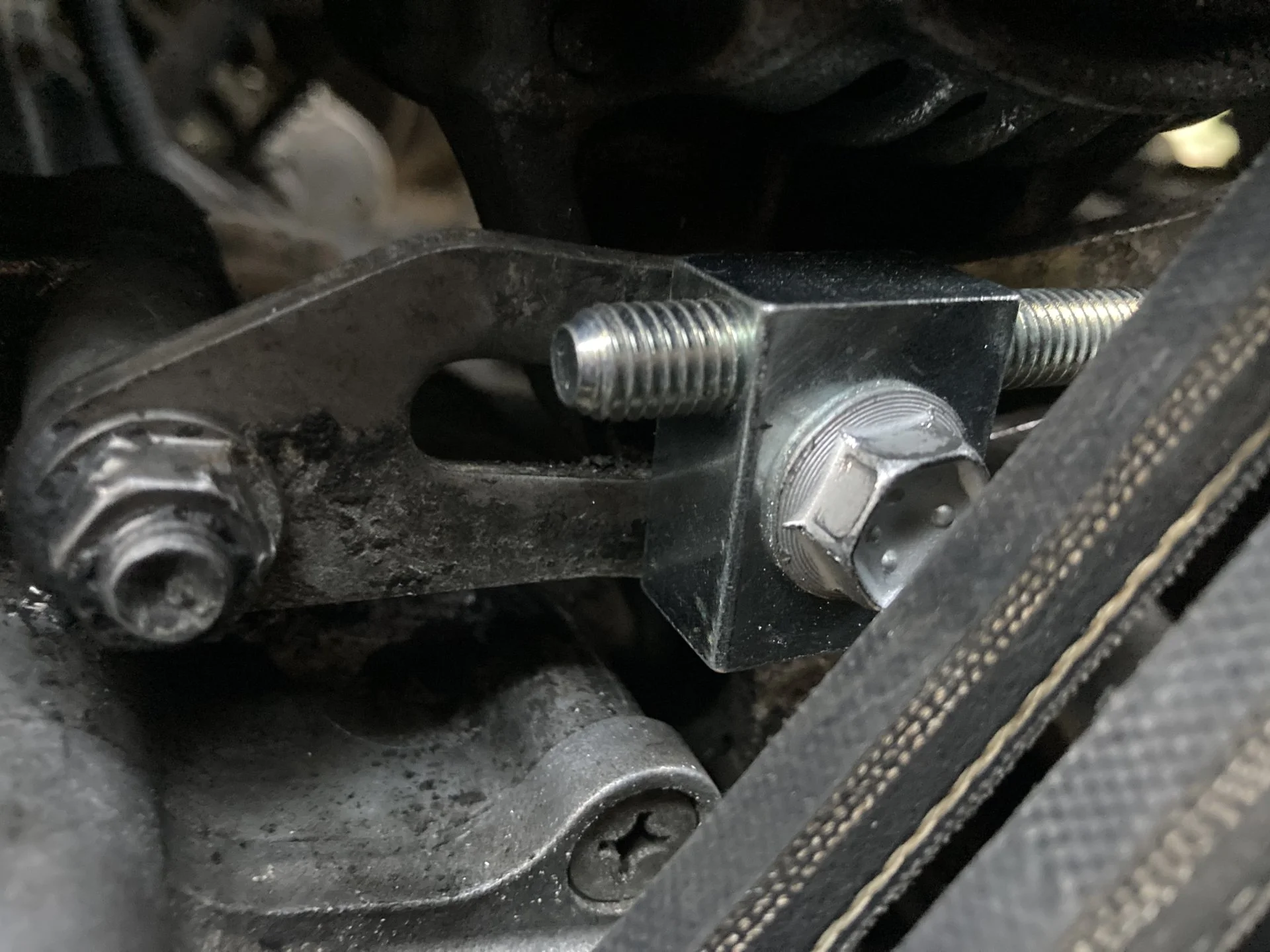

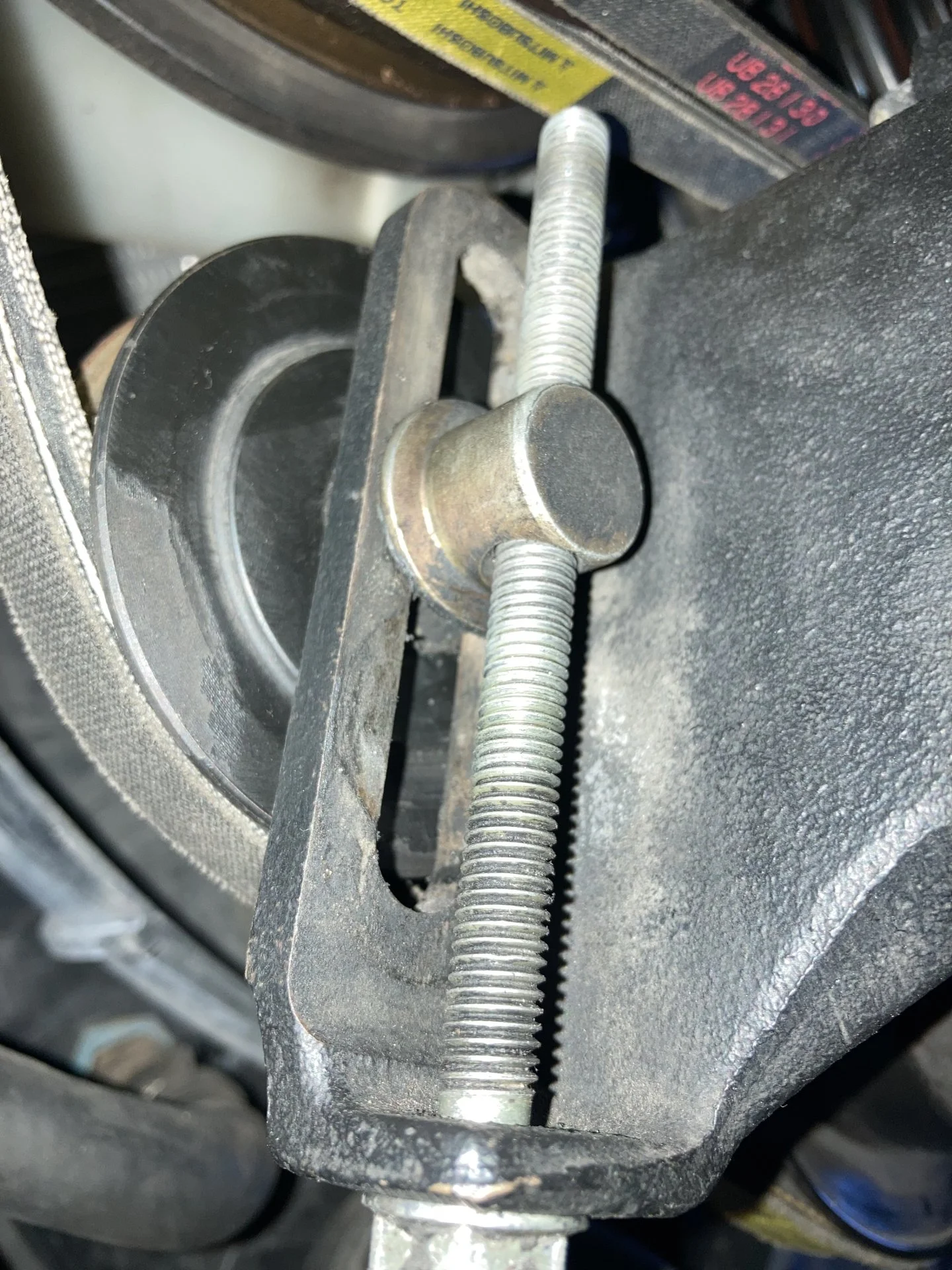

you can see in the photos this tensioner assembly has a curved slot in it. and you can see how the alternator attaches through the tensioner block to the tensioner block bolt. and that this rides in the curved slot when the tensioner bolt gets turned clockwise.
anyway. loosen the tensioner block bolt.

loosen alternator pivot bolt (1/2" wrench 14mm socket) on top left. leave it loose in the engine block.
loosen tensioner block bolt (14mm). leave it loose in the alternator.
if you are replacing tensioner block bolt, block and tensioner bolt - i angled the long tensioner bolt into the tensioner assembly, then started the threads manually into the tensioner block until it "bottomed out" on the "left" side. then i loosely fitted the tensioner block bolt into the alternator.

pics fitting the new tensioner bolt into the tensioner housing and bottoming it out in the tensioner block.

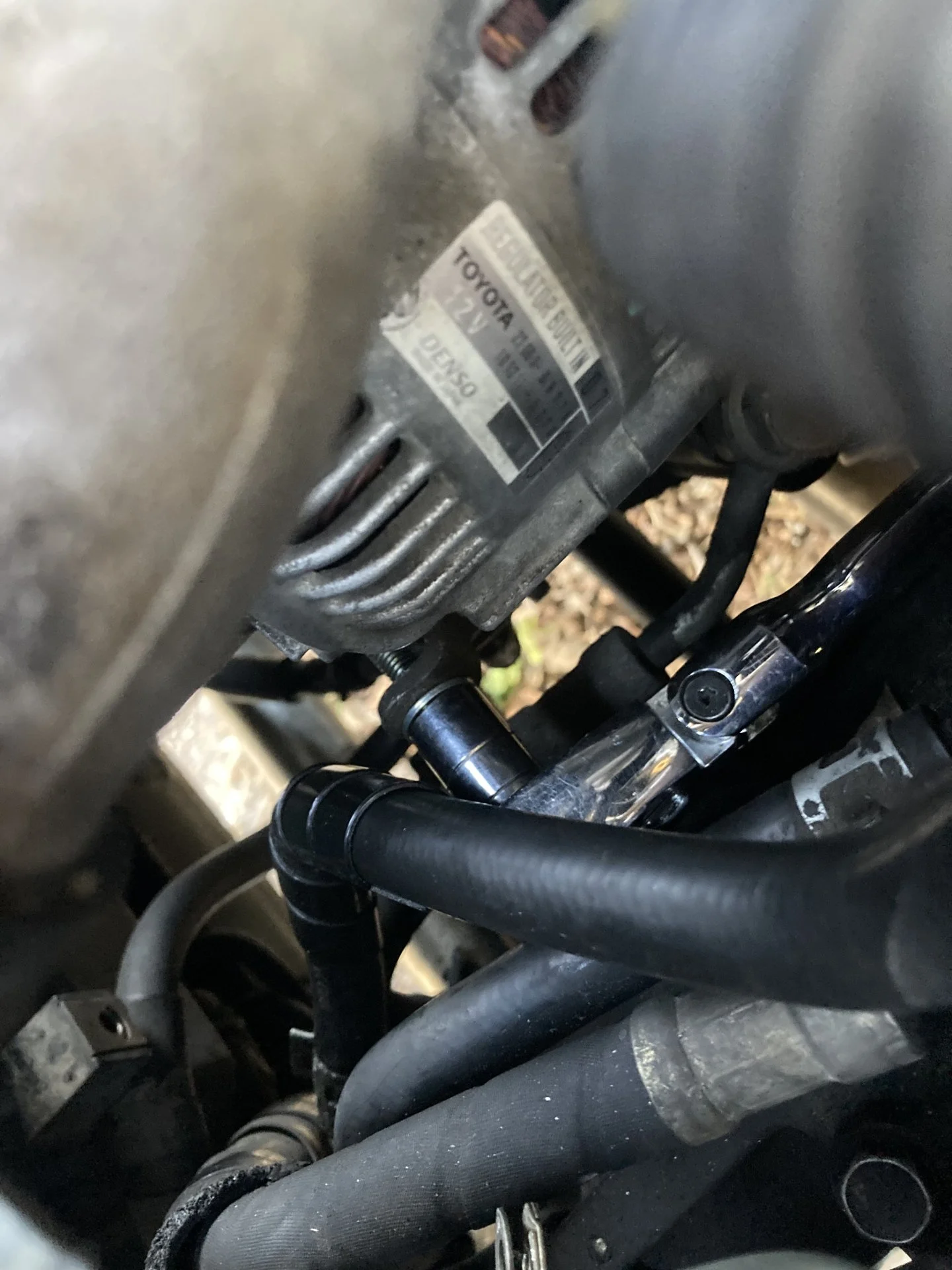

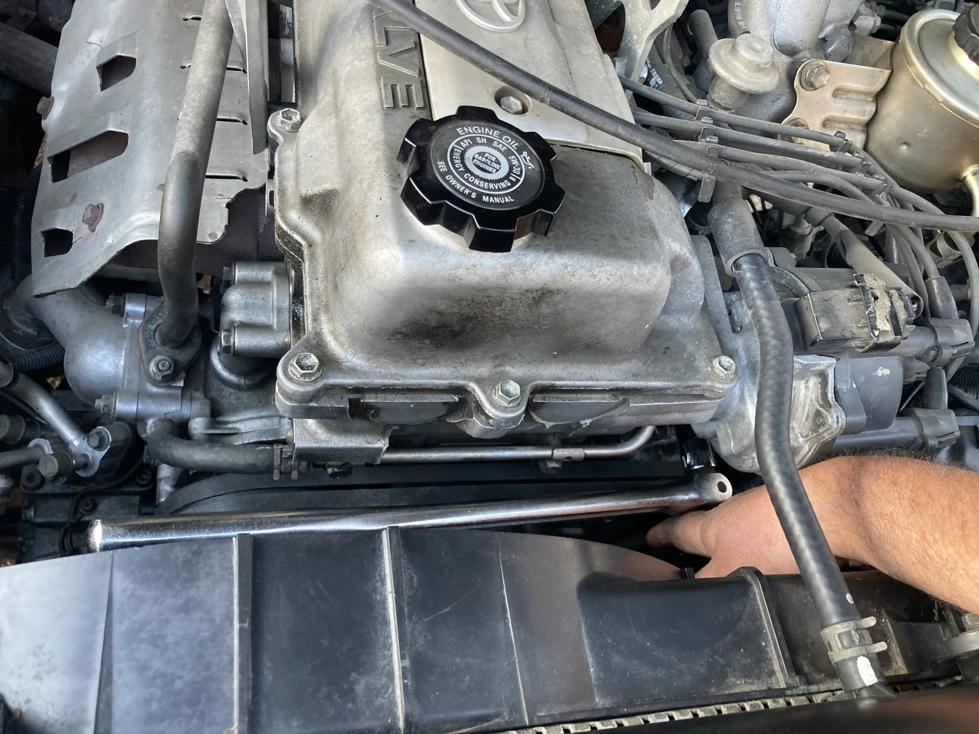

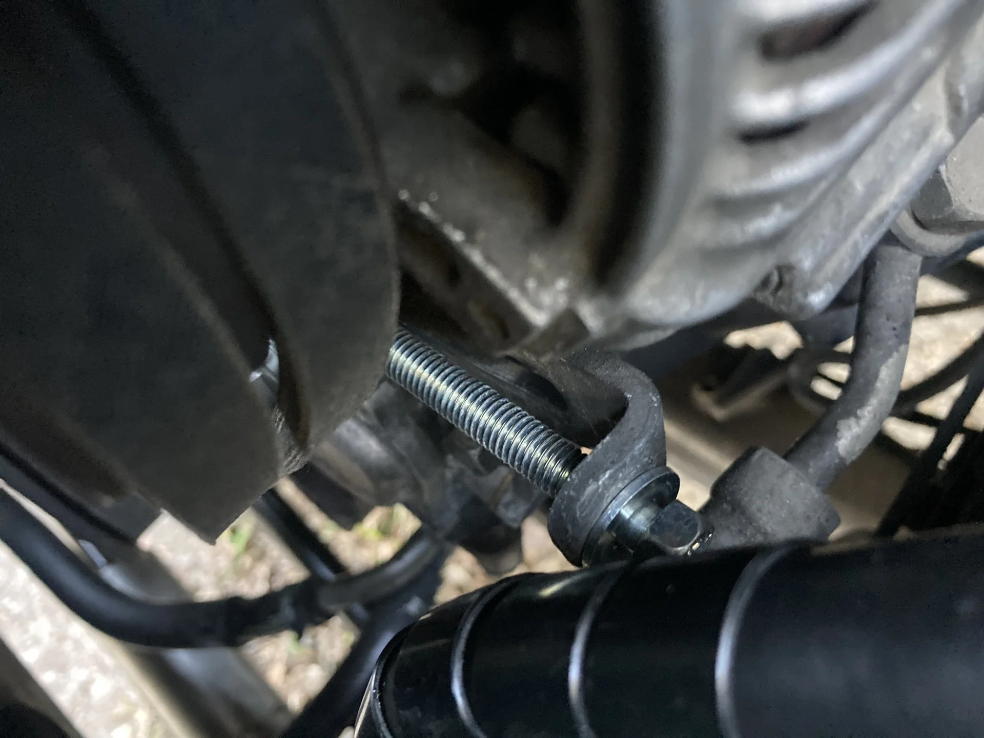

then you have to get the tensioner block bolt into the area with the threads for it on the alternator. this is not that easy since it is impossible to see but if you use a mirror you can at least sight it.

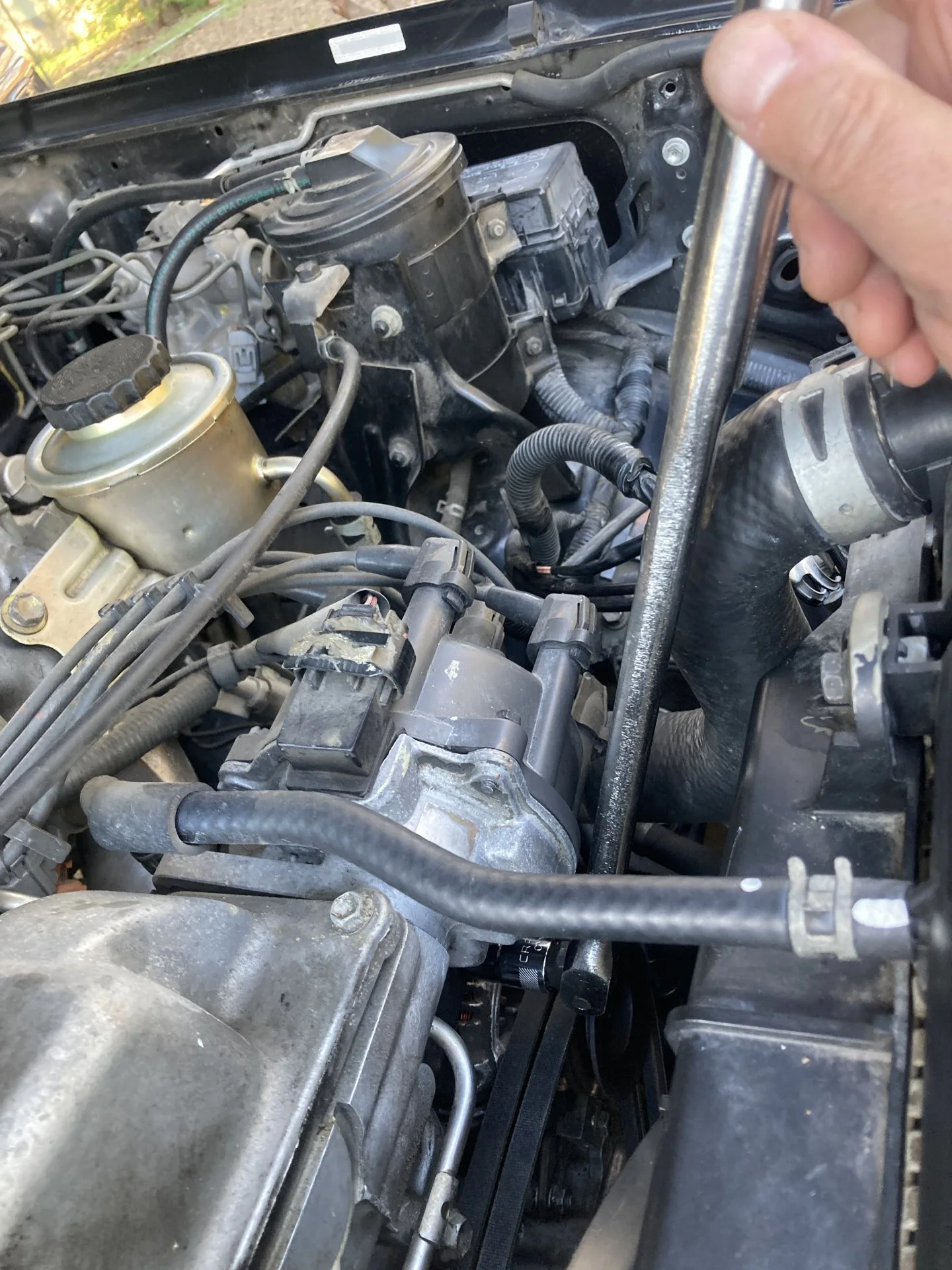

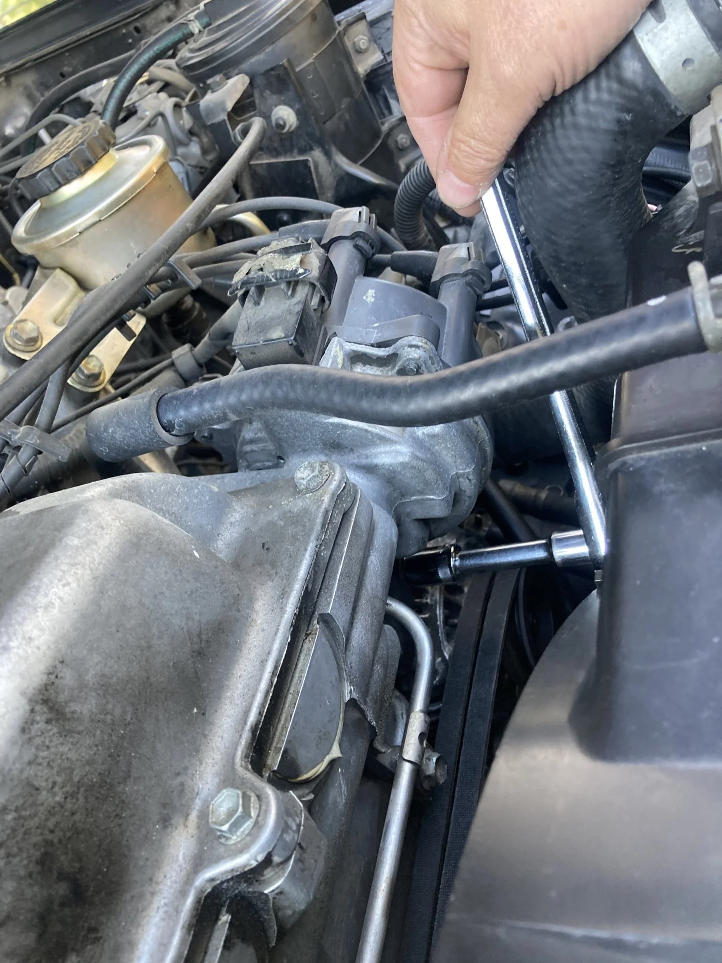

then get a stubby wrench over the tensioner bolt. the bolt should thread easy so you should be able to just use a small stubby on the tensioner bolt.

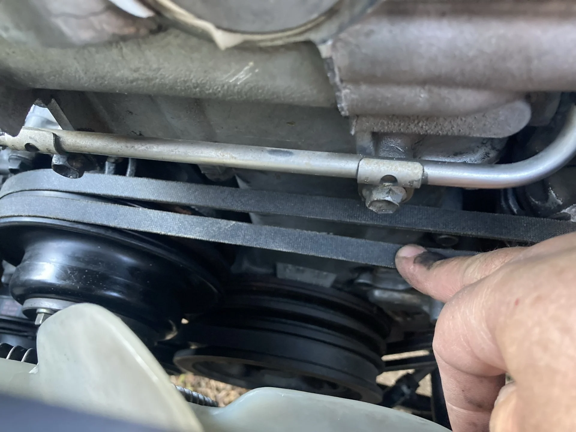

get 1/4" or 6mm slack on the belts.

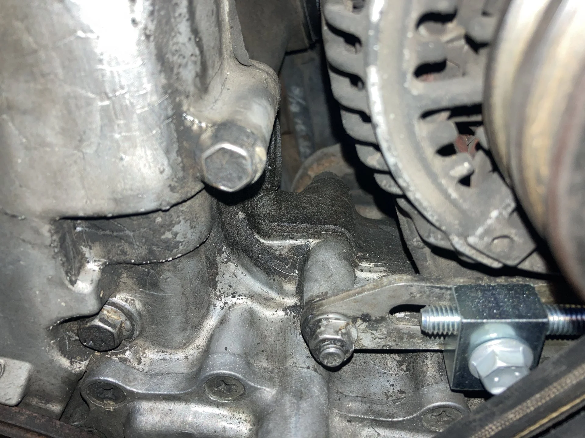

the tensioner bolt and block. tighten the tensioner block bolt.

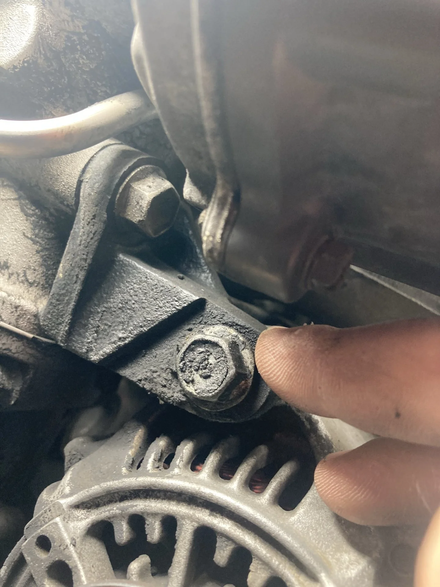

i tightened the alternator pivot bolt with a 1/2" wrench and then snugged it up with a breaker bar. then 43 ft-lb with the torque wrench.

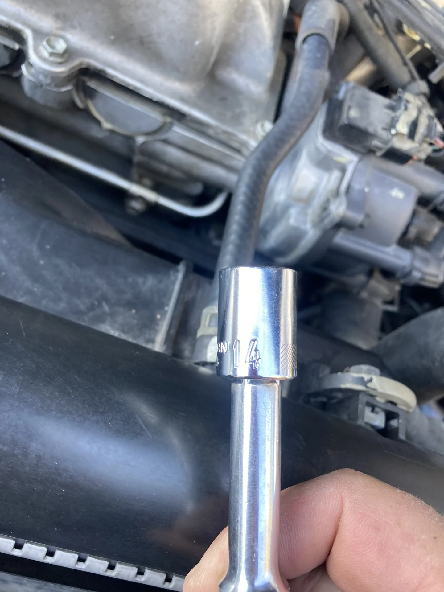

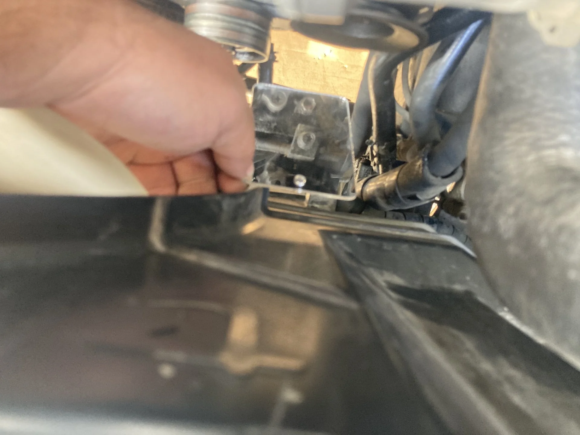

here's where i got smart and started using a mirror after i figured out i couldn't stick my head between the radiator and the block to find these parts. i think the one i am pointing at is the alternator pivot bolt. i guess it hangs off a casting that is bolted to the block.

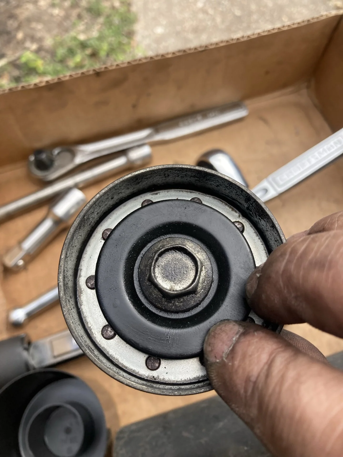

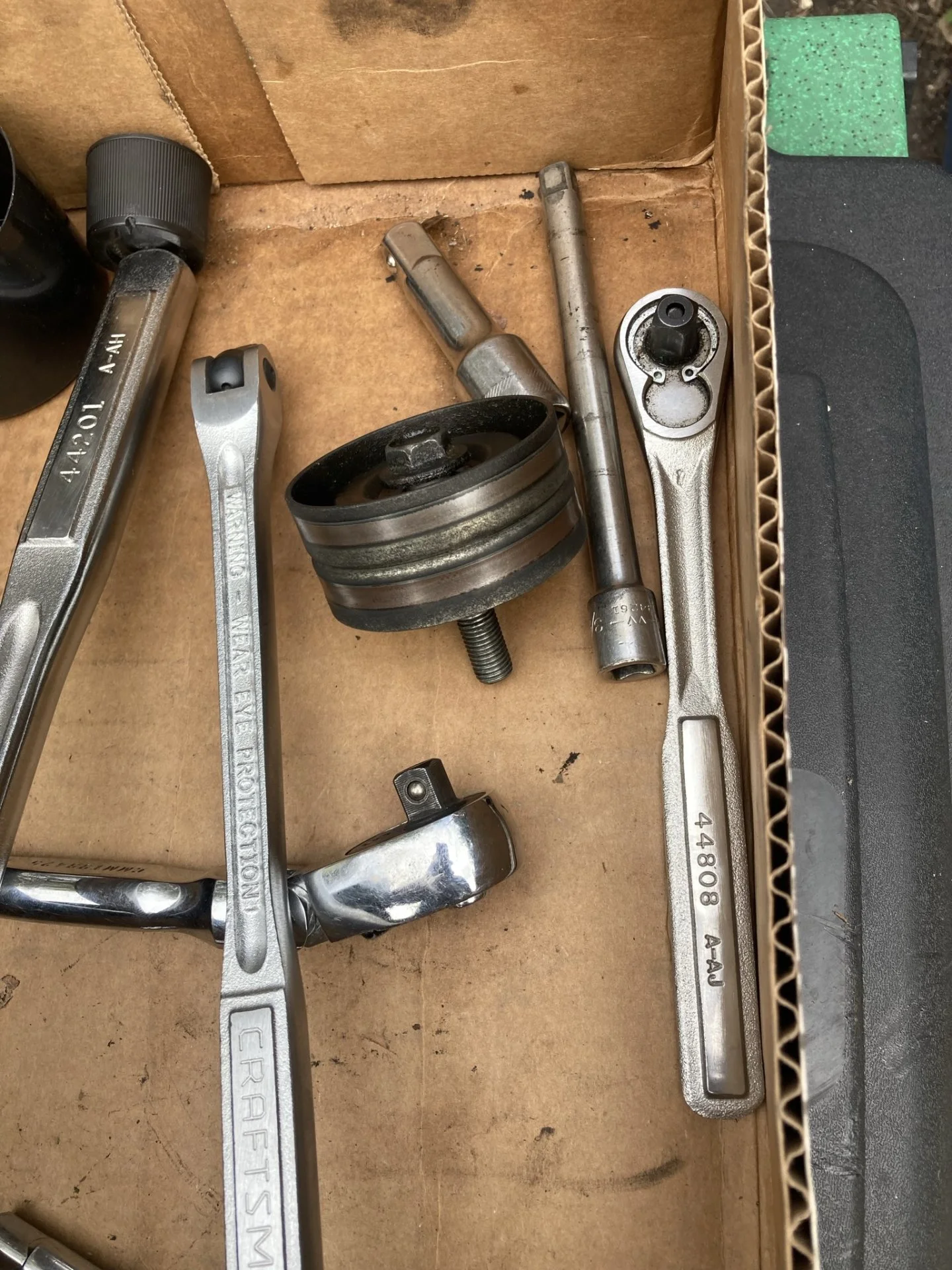

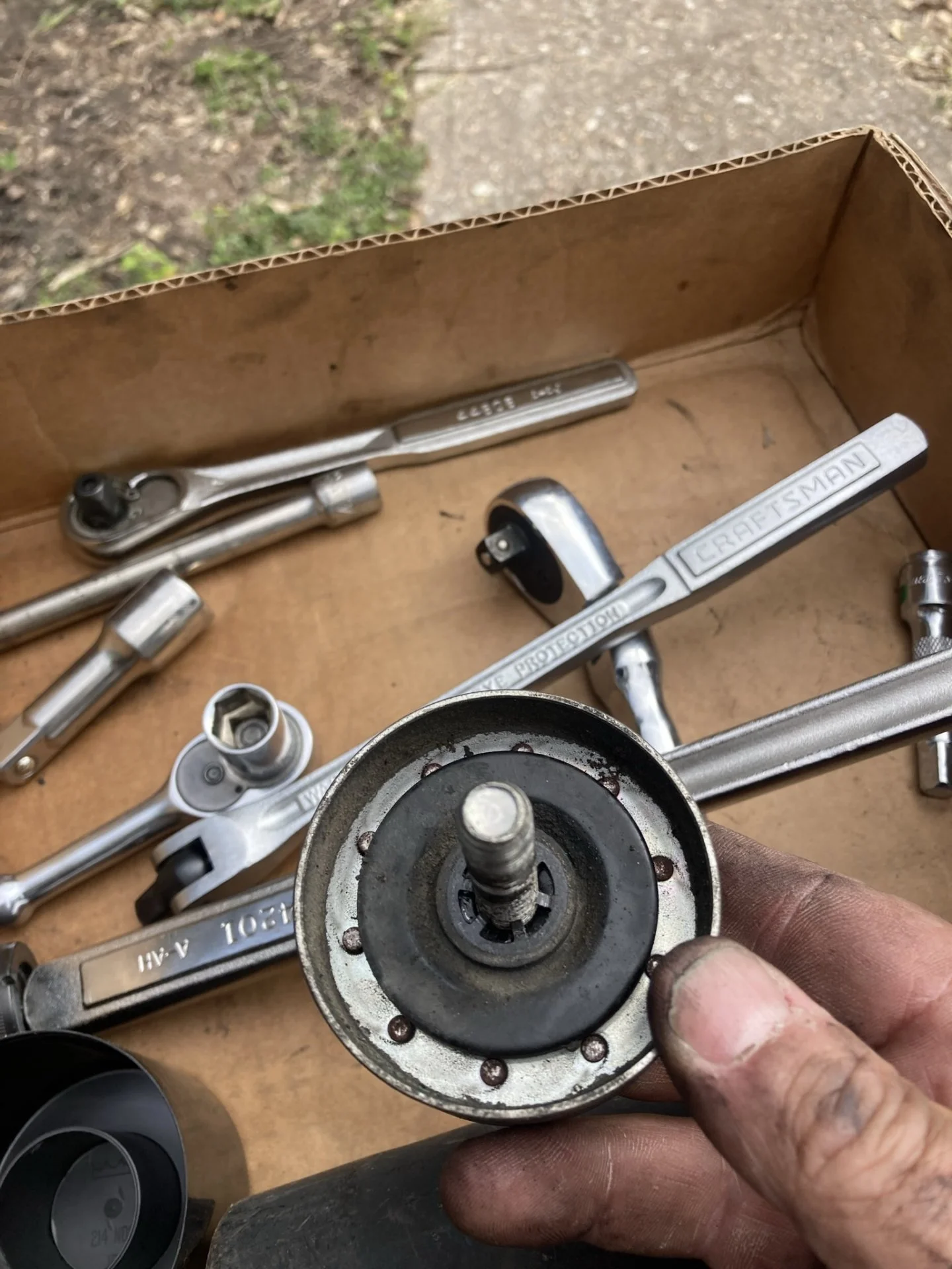

here is the idler pulley i pulled.

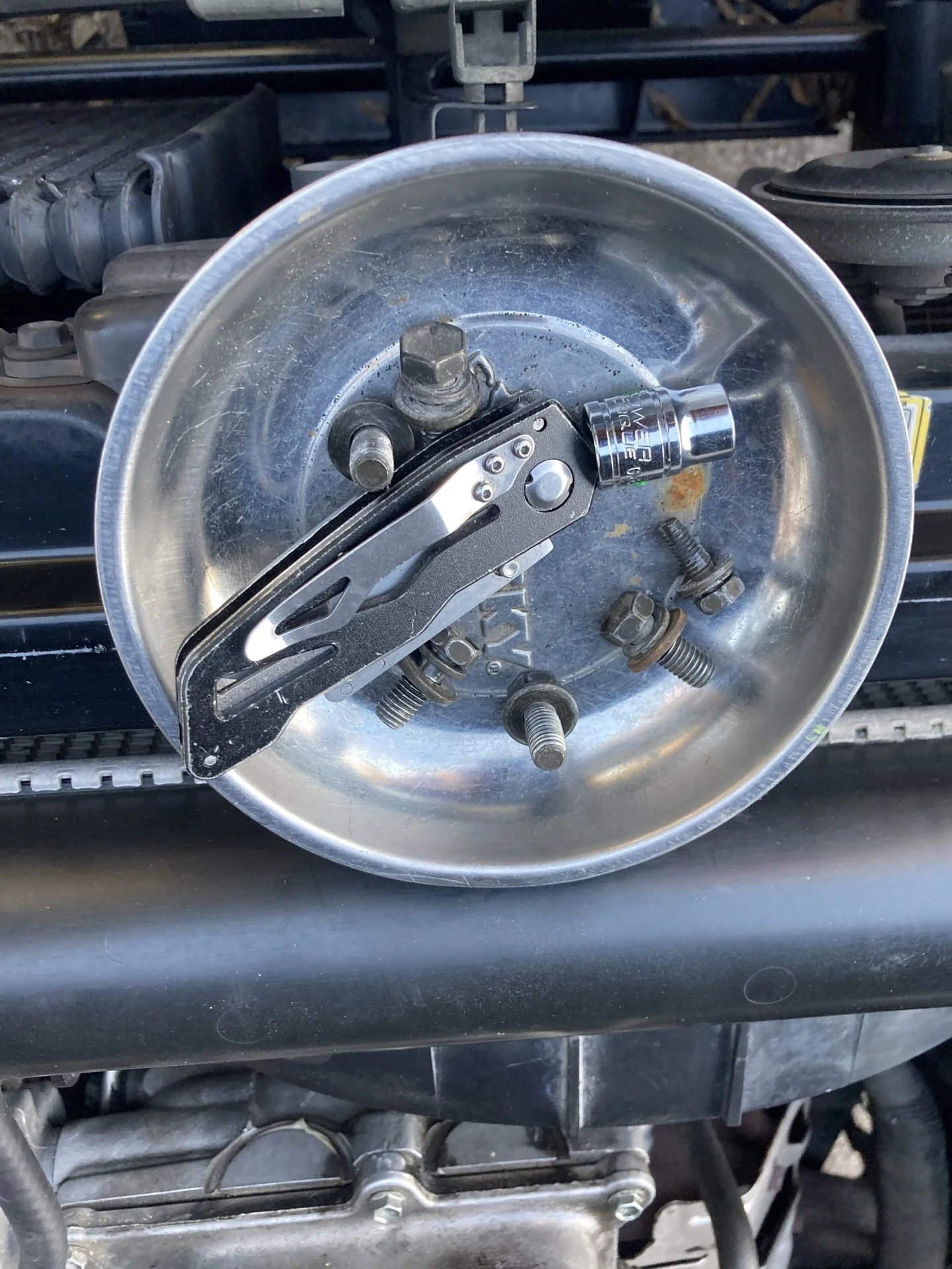

also since i was working alone i eventually put an X-acto in my pocket in case i got a finger caught Aron Ralston style in a belt or something.
bolts are for the battery box.
