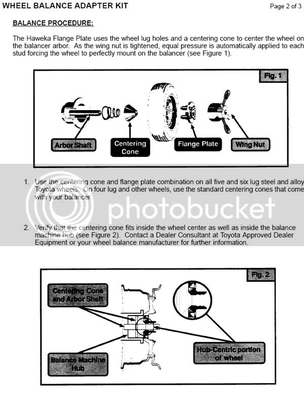

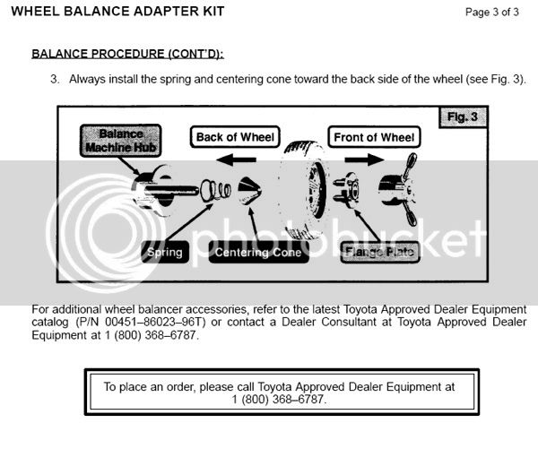

Per the TSB:
On your TSB, the centering cone goes through the hub opening in the wheel. The flange plate presses the wheel further onto the centering cone. It has nothing to do with the lug holes. The studs on the flange plate just pass through the lug holes, they don't hold the weight of the wheel or locate it for centering.
