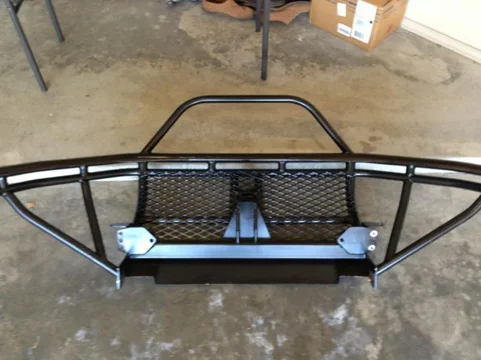

A local's front for FJC installed today.
Crating, which I may save for coffin. This addictions expensive, and I won't care when the time comes.
Tube front on floor.
Hour, half of which was BSing, later
Well executed bumper.
Thanks for making it easy, Stan.
