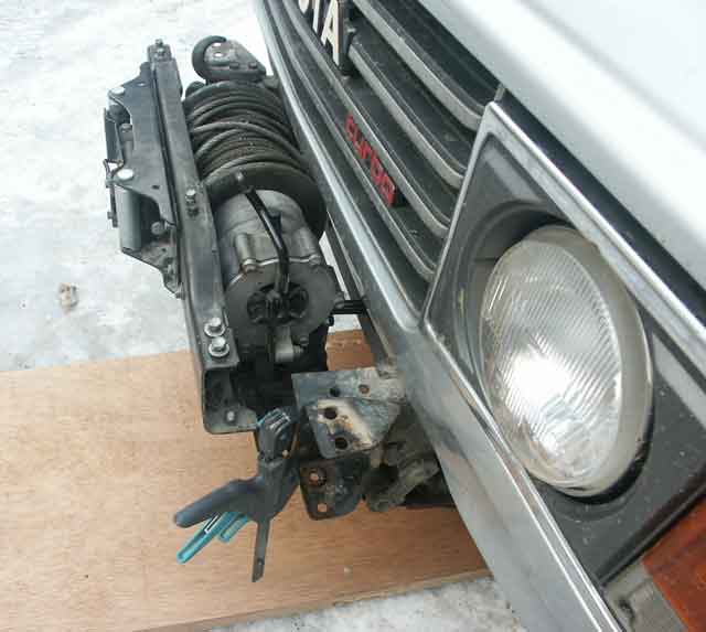

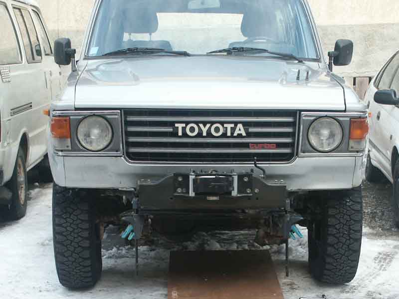

Here's the pics of today's atempt.
Whai i don't like is that i gonna have to make adapters :crybaby: and also cut the moustache thing under the radiator :crybaby: to fit it back closer to the chassis and a litle higher.
