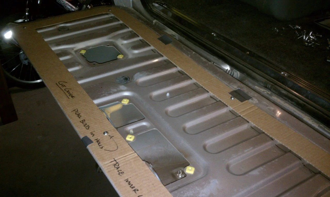

  2. Laid the template out, played for a bit with a measuring tape and figuring out tolerances and proximity of the tailgate lid latch rods (those which connect the lever which opens the tailgate to the tailgate locks on both sides) to finally realize there was nothing to worry about.
  3. Extension cords out, jig saw on the ready, damn it - no sheet metal blade (wood only). Project "on hold".....
  4. This morning, up before my wife and kids so went on a solo 45-minute jaunt through the forest. Nice ride, great way to start the day.....hit True Value and picked up what I needed to move forward.
  5. There's something unnaturally satisfying about cutting and getting into a project. Removal of excised sheet metal was easy and surprisingly fast. I honestly thought this was going to be a genuine PITA, not at all.
