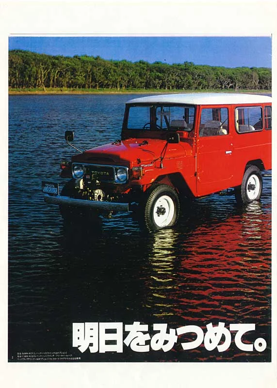

A 1979 Landcruiser brochure, all Cruiser FJ55 included came with 16 split rims at this time, mine too.
I borrowed my 16 split rims too a guy for an Africa trip and he sold them with his truck not gentleman like :frown:

Love those old photos, but are you sure that's 1979? I am pretty sure that the 1979's had square bezels? *(edit, just looked up the brochures in the archives, the square bezel first appeared in brochures in 1980)
I still have my 1980 stock 16" splits, but they are white/offwhite, and looking at them I think it might be the original color, they don't "look" resprayed, they have the same color and wear in and out, eventhough everywhere I read it says that they should be gray like in the pics above, any info on that?
