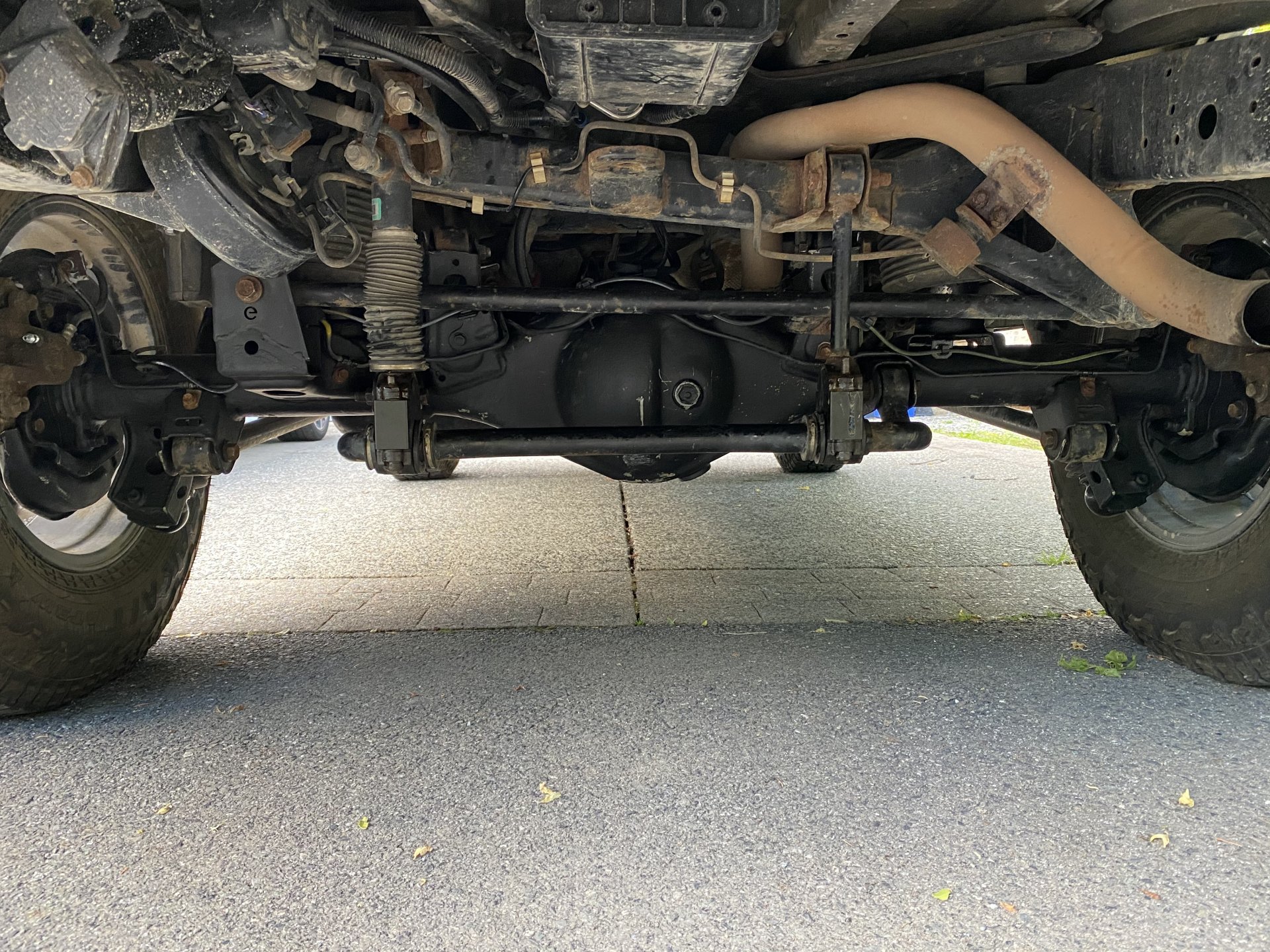

Not sure how much interest this will get, but figured I’d toss it up. I always liked the bags, especially for towing convenience. Mine are also in quite good shape, Pacific Northwest weather probably playing in my favour here.
The axle was a pull out of a 2011 4Runner trail with a front end collision, so I expected it to be fine and so far has been. I had a Elmkeith PCK welded on, and have Treaty Oak KDSS spacers. My drivers side KDSS piston bushing was worn through on the bottom, so I replaced both and kept the good one for a spare. The axle came complete with rotors so I didn’t have to buy those. I swapped my calipers and put new pads on since I was at it. Ebrake hardware I just picked the best of what there was from the two trucks. A friend blasted it for a case of beer, and put some random grey marine epoxy on it he was spraying anyways as a freebie, and I threw some tremclad over that just to make it black. Dunno if it will hold well, but don’t care. I got the factory switch and plug and play harness from Wil Oberdick at Dark Illusions Fabrication, and I also used a CH 4x4 locker switch in series as the factory switch doesn’t give much protection from an accidental actuation without the ECM part. To run it, you press the switch, and turn the dial. When it has locked in, the light on the switch is illuminated giving a visual indication it‘s locked. I also linked the axle and locker breathers, and ran them up near the gas filler, far beyond where I would ever get them submerged. The airbag spacers I had made by another friend, they use a M10 bolt on the bottom to bolt to the spring seat, and the top hole is a near friction fit for the bottom pins of the airbags. It also has a set screw that puts some further torque on the airbag pins, I don’t think I’ll ever pop one out with the way I drive.

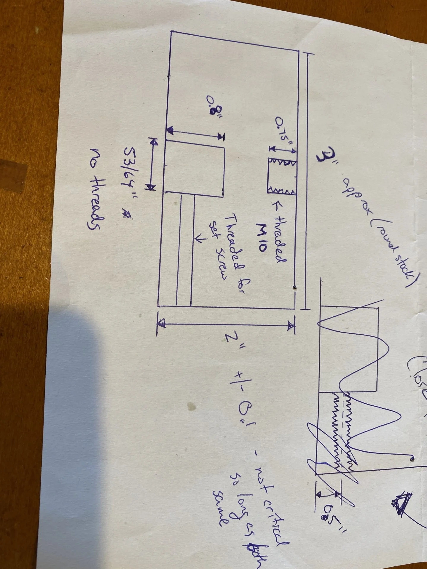

Okay, that is what I thought. Do you have more details you could share on the air bag spacers?
same here, i still love the self leveling of the oem airbags. where can i get a pair for mine? or specs so maybe i can have it fabbed!
I can get a basic drawing up later today. You still need to adjust the sensors to get your lift tho, as the trailing arms stay in more or less the same spot.

So 3” round mild steel (or aluminum, or whatever you have that you can work with) and I made them 2” thick as that corresponds almost directly to lift height. It can be a bit bigger and still fit within the bottom part of the bag. A bit smaller is probably fine too, but this was just a common size I could buy and not have to turn it down on a lathe. Wider all things being equal should be more stable. Strength isn‘t really an issue. My hesitation on any sort of plastic would be lateral forces on the bolt that secures it to the axle.
On the bottom you want a M10 bolt, and a heavy fender washer for it. It takes some finesse to get the bolt through the washer and the airbag seat, I think a 20mm long bolt is about best, but depends on what you’re doing on the bottom for washers. The hole in the spacer is centred and I suggest 3/4“ deep, and threaded to match your bolt thread. You might get a M12 through, but the clearance from axle tube to air bag seat is a factor. I used metric for the sake of not having imperial hardware on a metric truck but it doesn’t matter.
The top, centered 53/64“ hole which is about .82”. If you’re going to coat it, allow for the thickness of the coating. Going a bit big doesn’t compromise it, a bit small obviously won’t fit (or come out easily some day.)
For the locking set screw, whatever reasonable sized set screw you have around. Mine are 1/4 I believe but you want big enough to have some meat and not be super weak, it’s probably gonna corrode in there no matter what. This could also easily be omitted, the factory bags have about zero retention and just putting the pin into a deep hole rather than sticking it through a 1/8“ metal seat will fight the potential pop-out problem a lot. I am probably taking mine out, I worry they’ll corrode over time and make it hard to get the bags out should I need to eventually.
