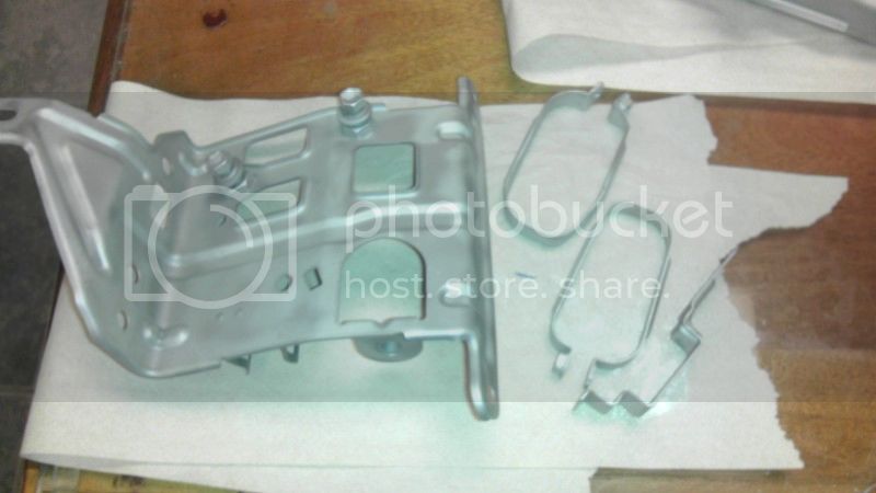

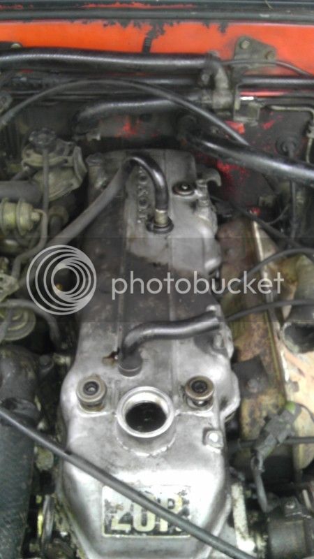

Breather before

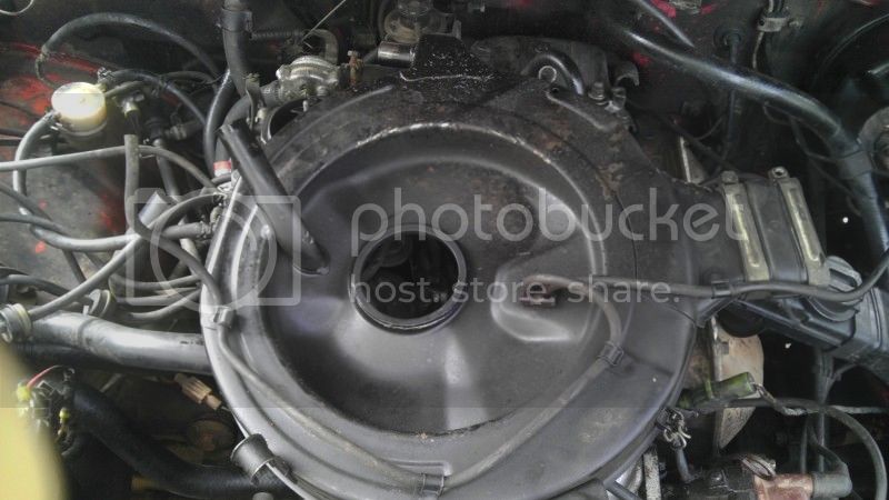

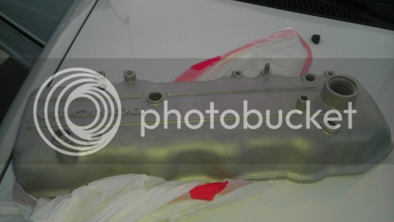

Valve cover before. Im trying to decide red or a yellow. I have many colors but I do like it to stand out a bit. I'm thinking one of those on it and maybe black for the breather assembly.

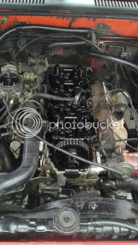

Still more work to be done and plan on taking more brackets off to do
I will post more as it happens

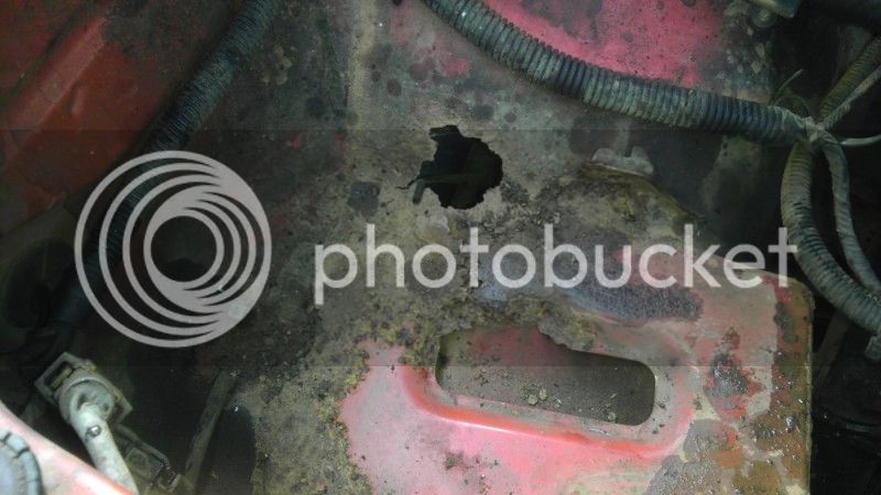

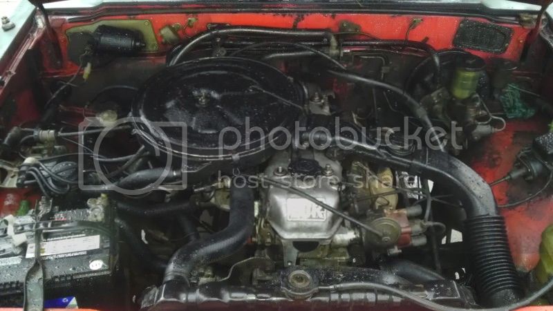

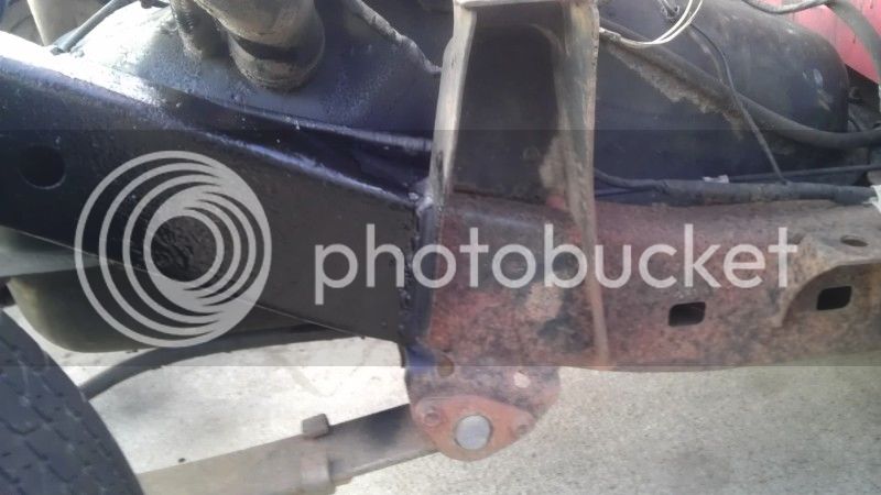

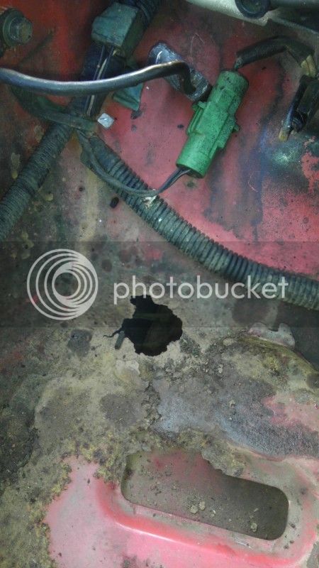

Well have found one place which I am hating, right under the battery there is a nice cancer spot. Trying to decide what to do about it. May try to cut it out and form some new sheet metal in it's place.
Don't have a welder but maybe can get a friend to help out
Well I got the valve cover and the top of the air breather media blasted more to come

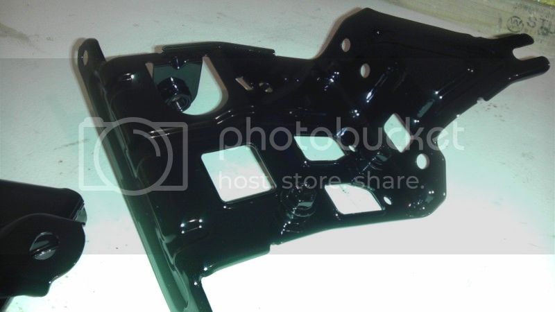

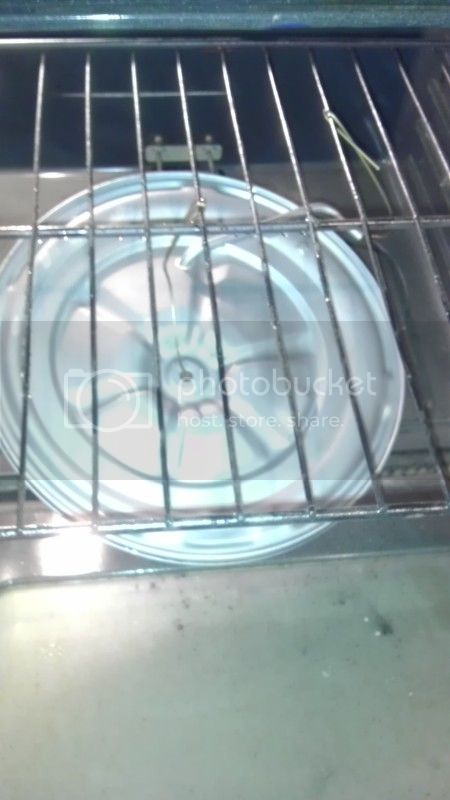

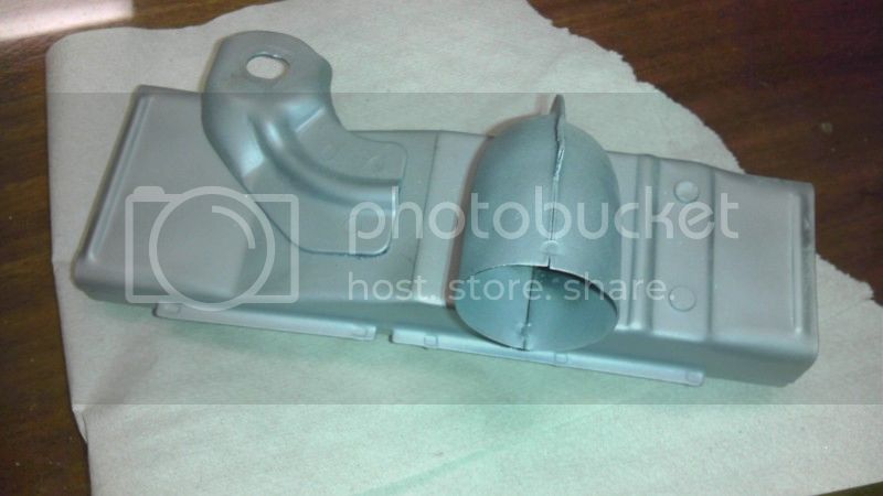

Well did a small bit of powder coating today before getting ready for work tonight.

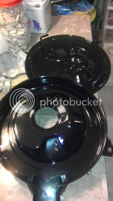

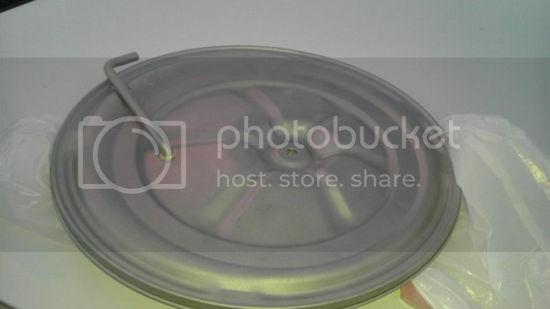

All cleaned up ready to spray

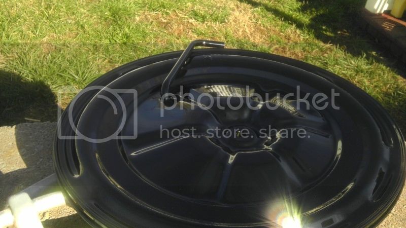

Finished air cleaner looks great
Will be doing to valve cover tomorrow, and took a few other brackets off to do.
A few more under hood goodies to be coated, all blasted down and rust removed
I am thinking of doing a few small brackets in red to break up all the black. Hopefully it will look good.

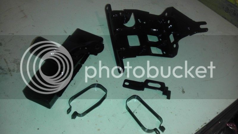

Well all parts that were removed have been coated. They look great

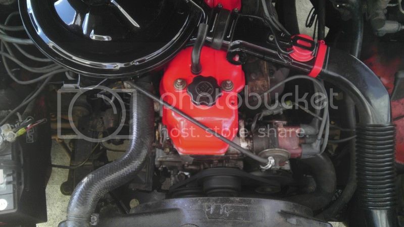

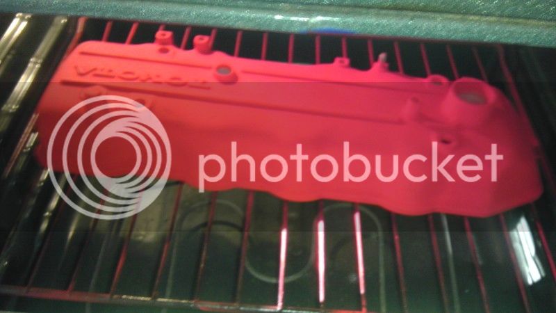

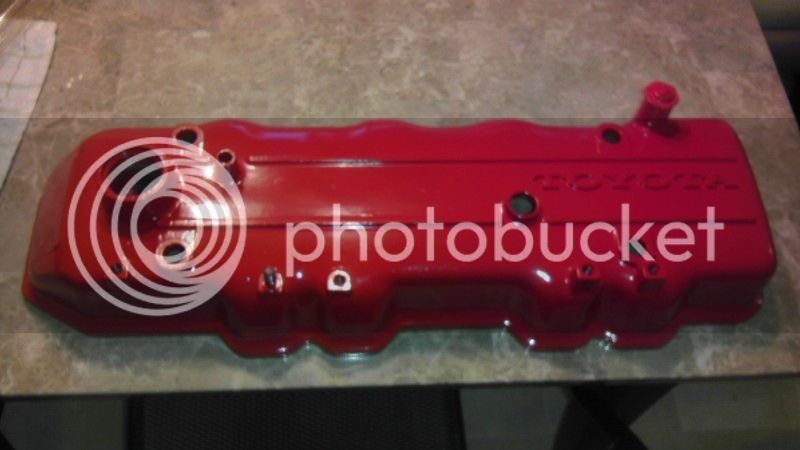

Valve cover sprayed but not baked
And the finished product, it looks amazing

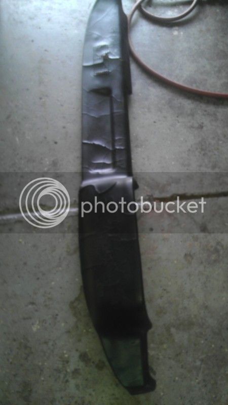

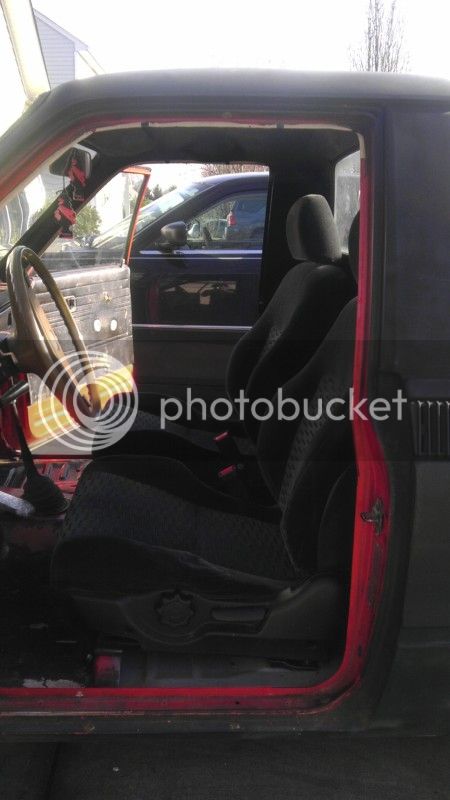

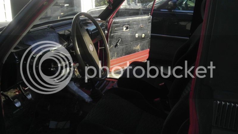

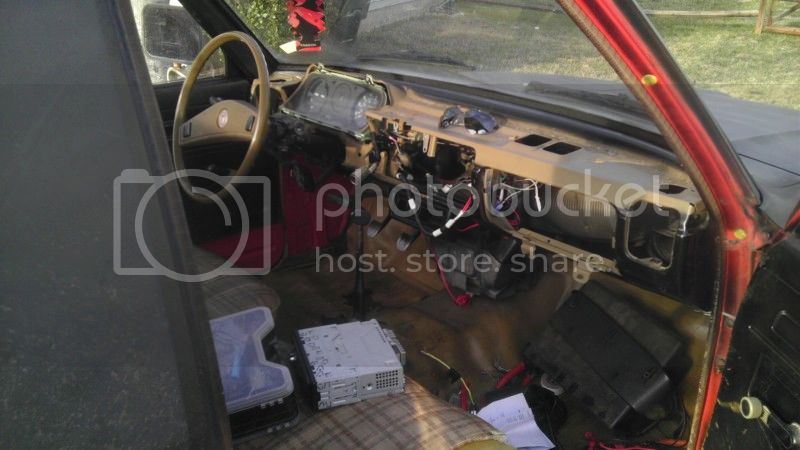

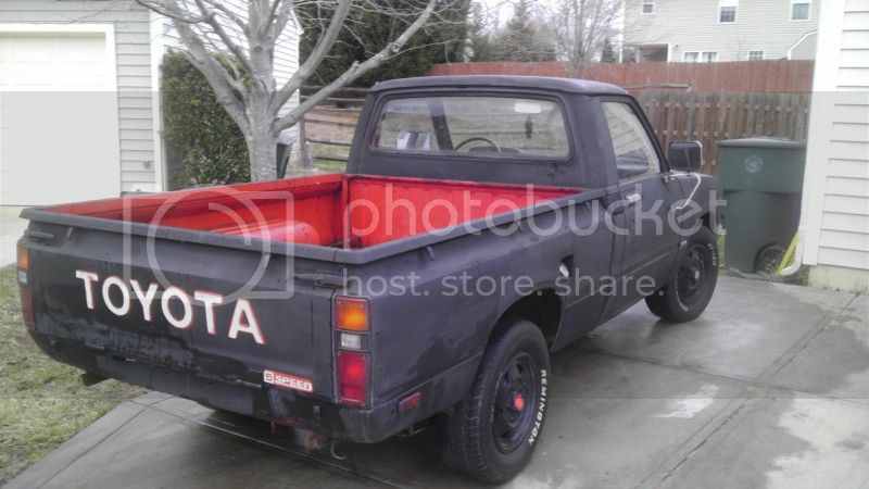

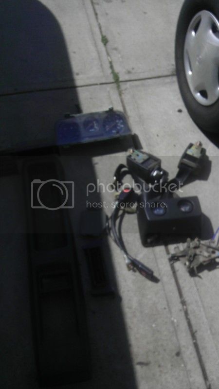

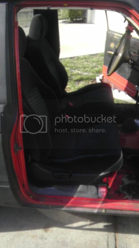

Well I got a decent amount of work done today. I took out the horrid cracked dash which I am hoping to bring back to life with some fiberglass. I also started fixing the wiring nightmare of the interior. The previous owners had removed all stock radio wiring and made some"custom" wiring. Wow what a mess, so I tore it all out and did it the right way. I also am painting a few interior panels, so far glove box , and trim above and over the steering column.
I also fixed the horn it needed a few washers behind the brass o ring. Tomorrow is inspection day

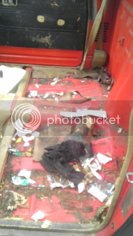

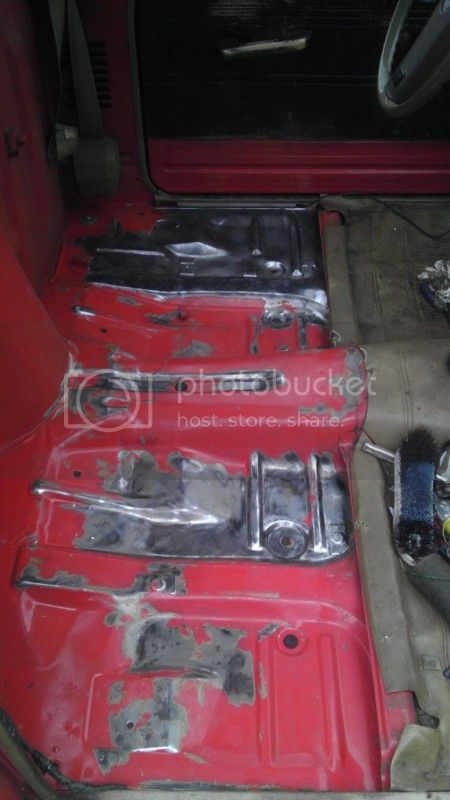

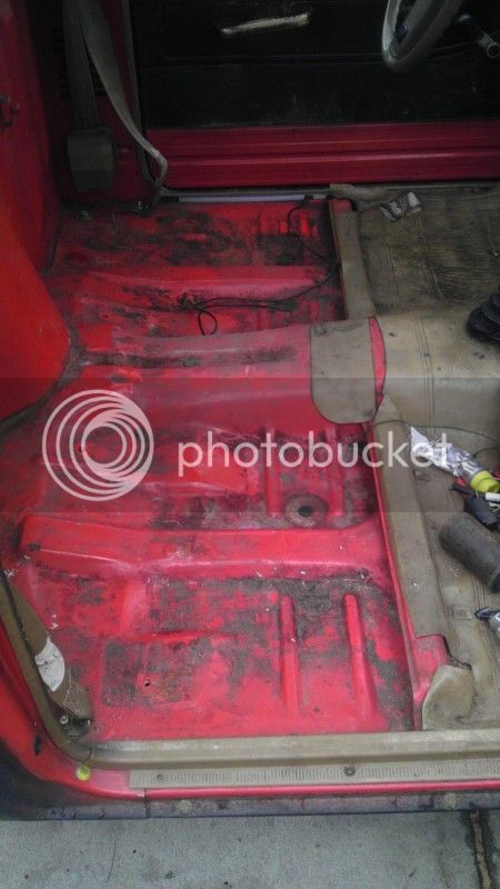

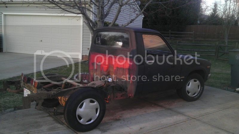

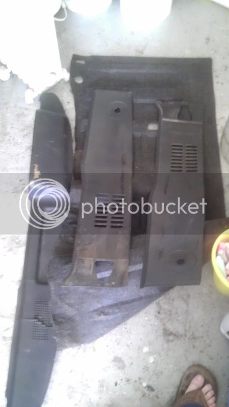

Well got some work done today. So far I took out the bench seat(likely trashing it), cleaned the back part of the floor pan, started grinding it so clean it for paint and to remove the surface rust. More to come
