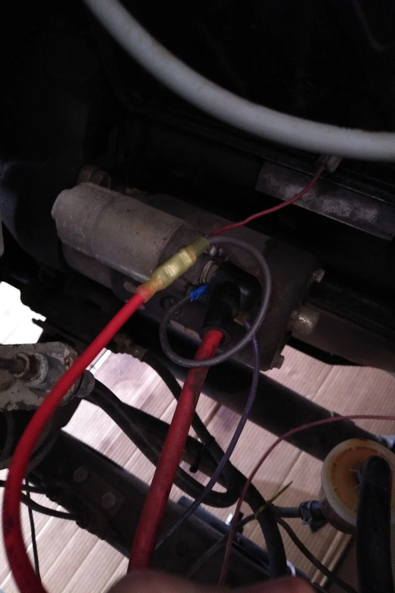

Added a fusible link where the Kwik Wire ("KW") instructions indicated (#16 Red 10 ga from fuse panel to Starter Battery Lug).
Here it is installed- the little red wire heading to the upper right is connected to nothing...
I know this isn't the Toyota location (between ammeter and battery), but I figure it will protect the harness while I sort it out and I can replace the fusible link once I figure out whether to reconnect the ammeter (see below).

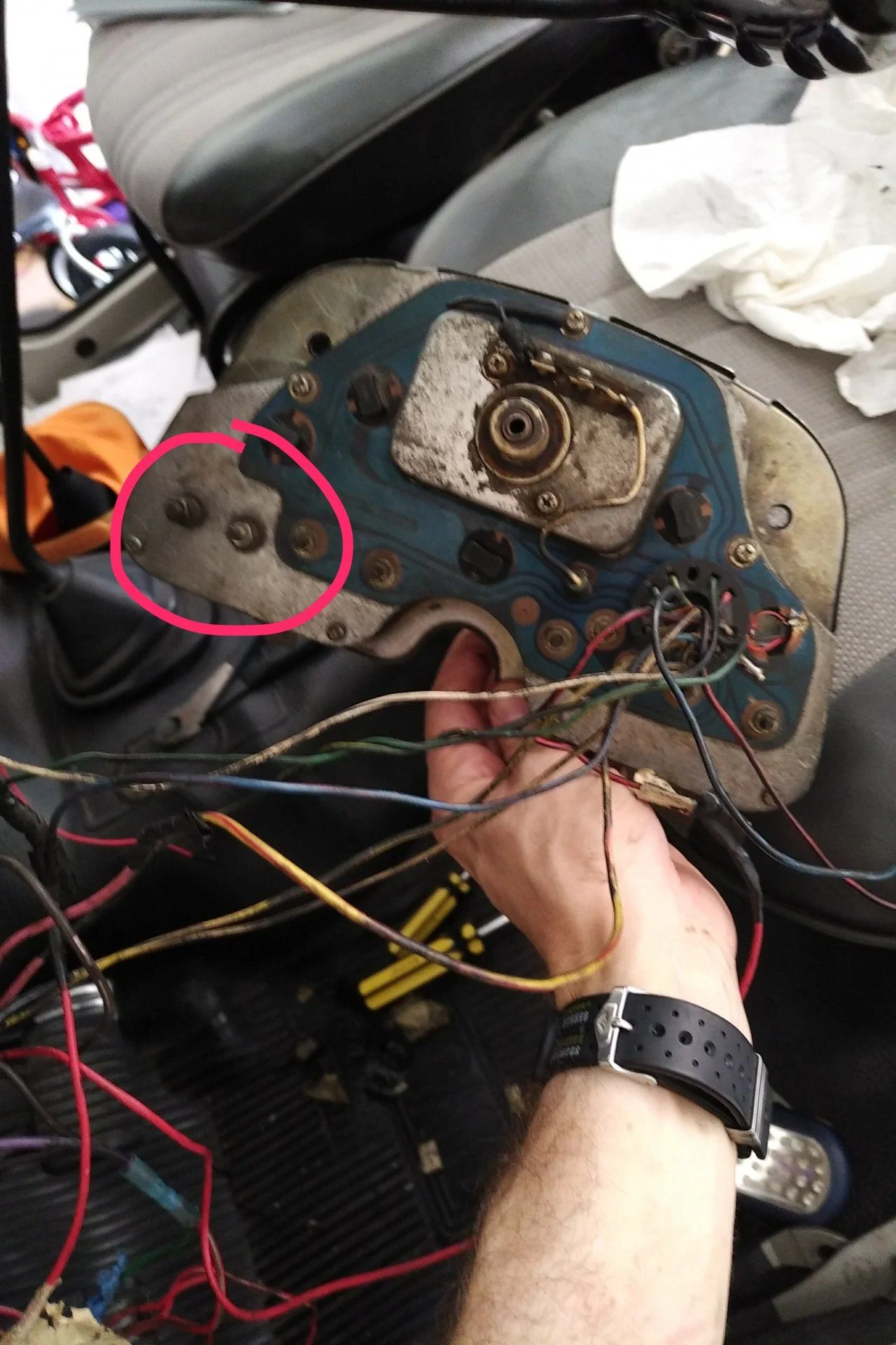

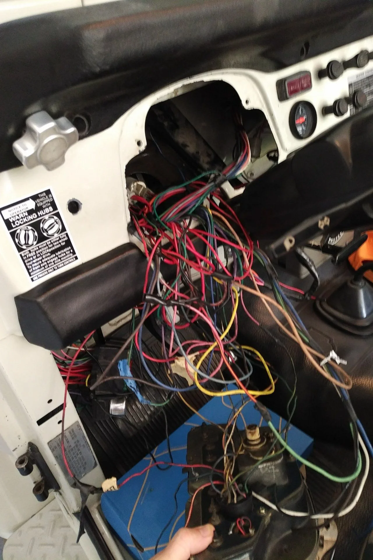

Pulled the combination meter (instrument cluster) and found more rats nest and discovered that lots of the KW harness isn't connected to anything, and a lot of what is connected is just twisted and taped.
I did manage to sort out the high beams and headlight switch:), as well as the high beam indicator which was disconnected. I'm missing the purple (or is it blue?) lens that covers the high beam indicator- will try and pick one of those up eventually, but not worth the shipping on its own.
Feeling like whoever installed the Kwik Wire harness had plans to finish the install but ran out of steam - hence some things nicely wired with butt connectors, and some things that (giving the benefit of the doubt) look like temporary connections intended to be finished later (I.e. wires twisted together and wrapped in electrical tape, the headlight high beam wire in roughly the right location behind the firewall but not connected to anything, etc). But there was some really bizarre stuff - like a new red wire, wrapped completely in electrical tape to turn it black, run from the KW wire at the right headlinght back over to the left headlight, when the KW harness already had a separate wire that was already run to the left headlight).

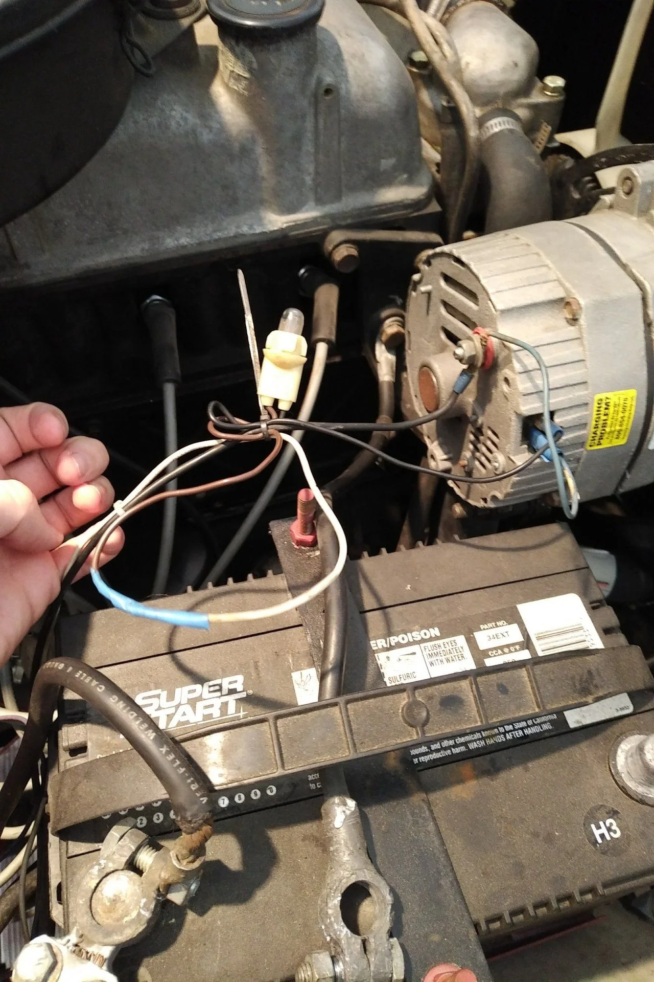

Lastly - why is there a bulb between the battery and the alternator?
The light on the alternator is likely for an iddiot light to show when it's not charging.
The Ammeter was likely left out for simplicity. To wire it in the feed from the alternator should go through it and then to the battery. If you're planning to upgrade your alternator, don't bother hooking it up... instead install a volt meter in its place.
