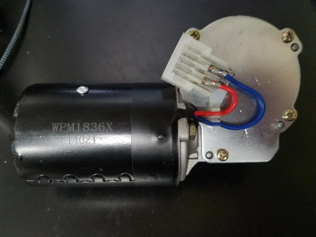

I purchased this motor of ebay for $20 shipped Super Auto WPM1836X Windshield Wiper Motor, Front | eBay using part # 43-1836 which is a wiper motor for newer VW beatles.
This is the motor;
This is the motor;
