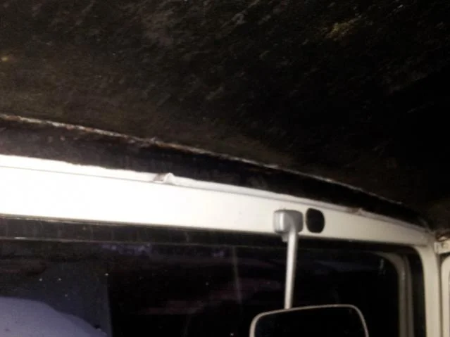

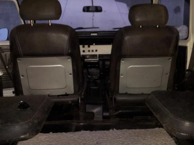

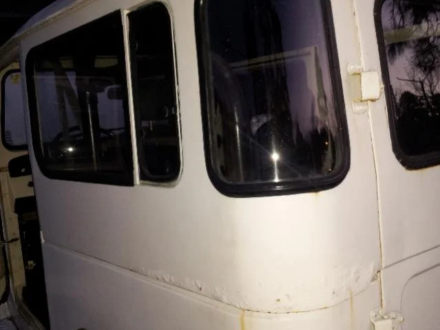

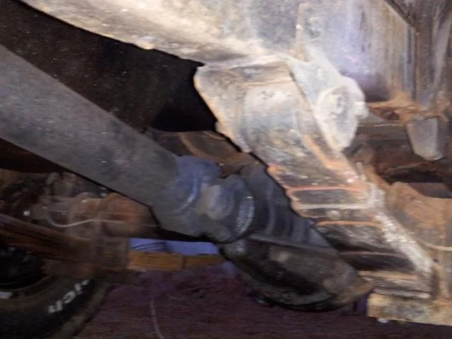

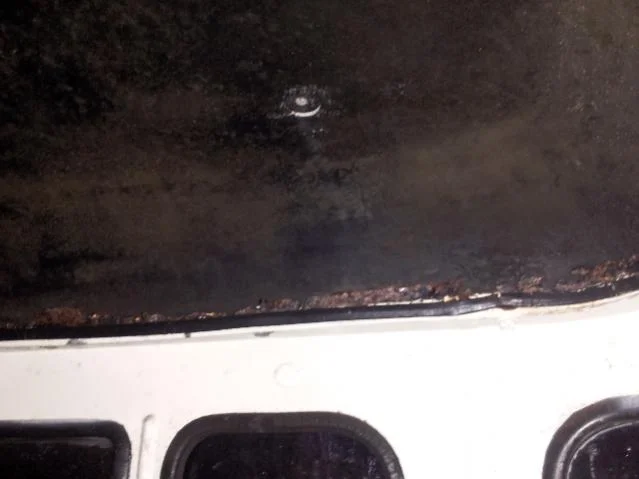

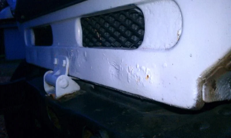

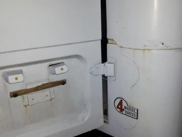

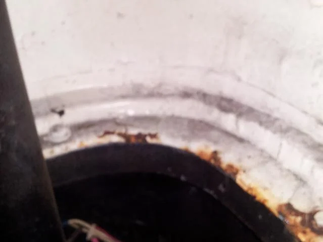

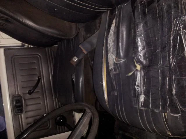

I just went out and looked ... A fiberglass tub, which I know nothing about but here's the pics

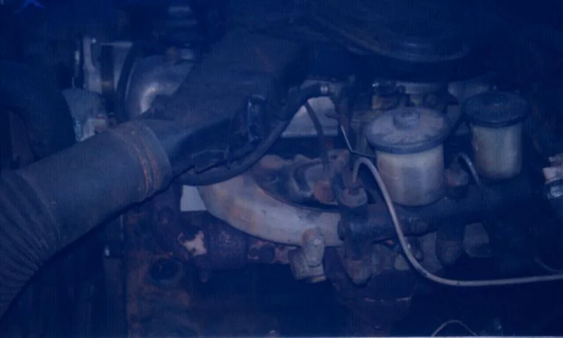

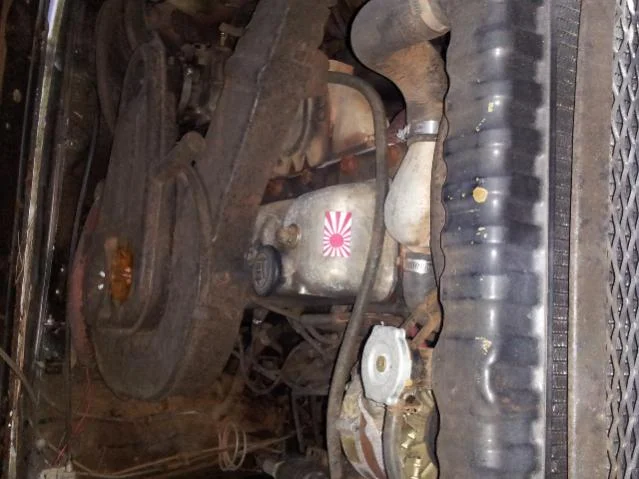

Coming from the huz (and our comparison is to my 74 FJ40 with 2F) On the engine start up

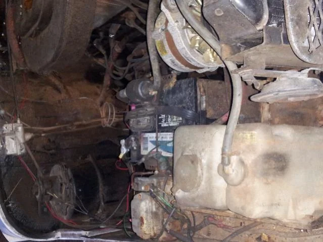

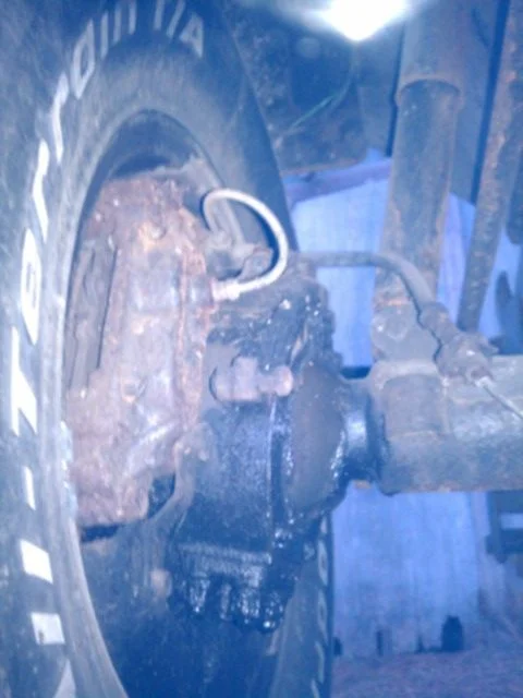

Recommend checking the compression on all cylinders - sounds a little flat. Heavy blue smoke on start, decreased a bit after running. Definitely needs a tune up and for the most part, we both thought it would benefit from being ran more often. The guy bought it from a marine and it had sat for quite awhile. Current owner says he replaced starter, radiator and alternator...If the 78 came with an Aisin - that is not what is in it now. Discs on the front, drums on the back..He's pretty honest about the electrical, says it has a short in it - messing with the signal lights but that he hadnt gotten in to that yet.

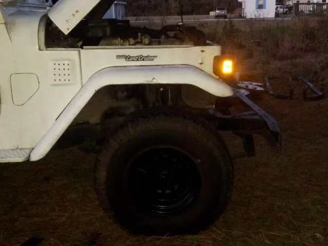

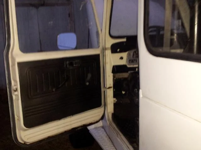

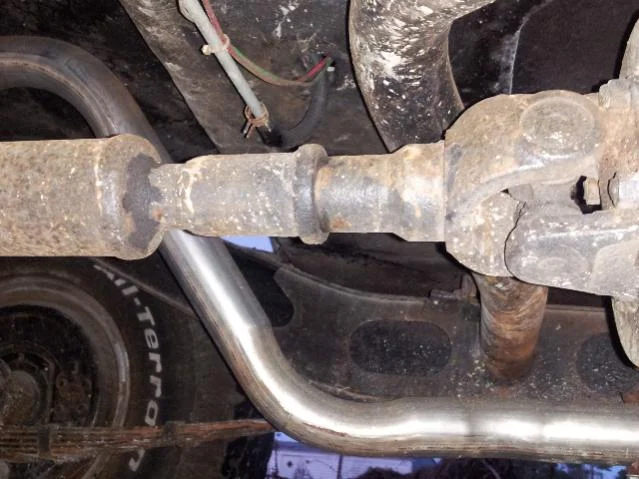

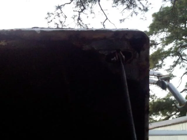

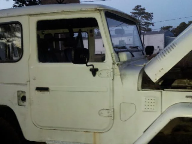

To be honest, anything that wasnt fiberglass had rust - but the frame looked A+ Solid. My pictures are to point out the wrong things - as thats what Id want to know. He replaced the tub with a fiberglass tub, this was the first Ive seen, so I wasnt sure of what areas to specifically look for problems in.
Those are 33x11.5x15s - I apologize for the odd 'blue' pics - once I figured my phones camera was poo-ing the bed, I switched to the huz's. The hood looks real bad on the front corners. The front fenders do not look well attached, or as if they had pulled away.
