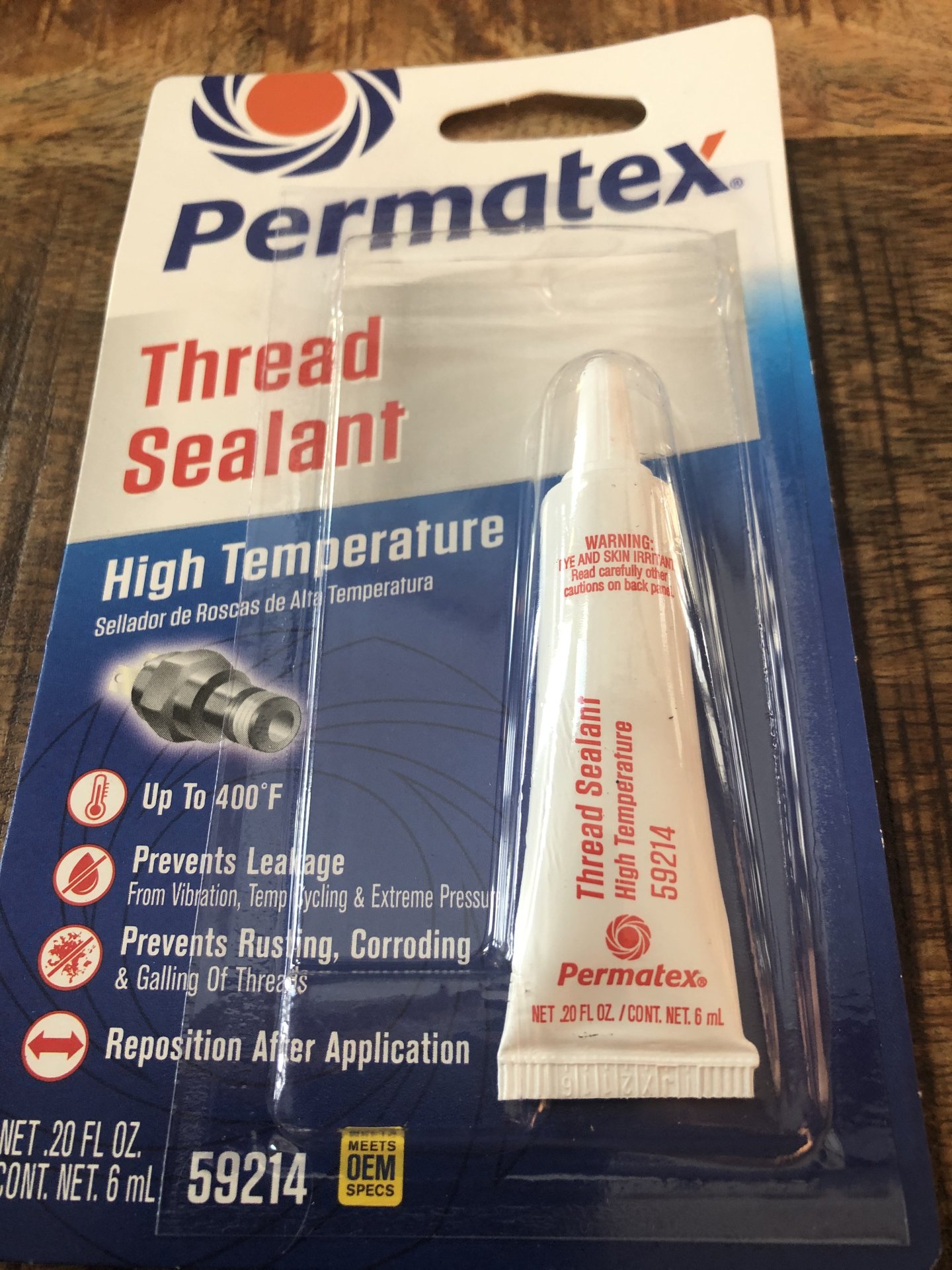

Yes the sensor threads into the bushing. Don’t use Teflon tape during assembly. There is a couple different products available. I’ll post for you later if no one else “recalls” the brand name.
