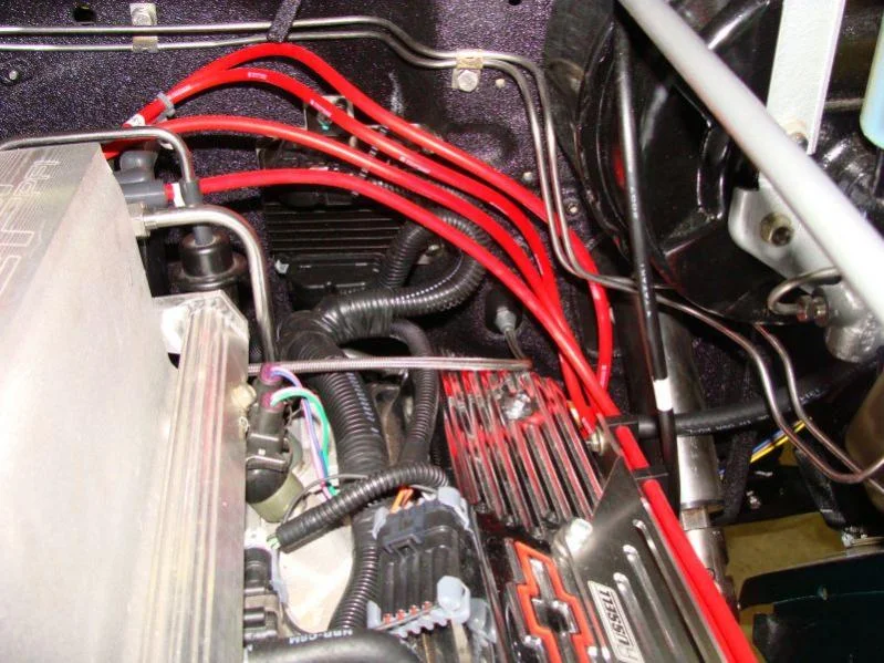

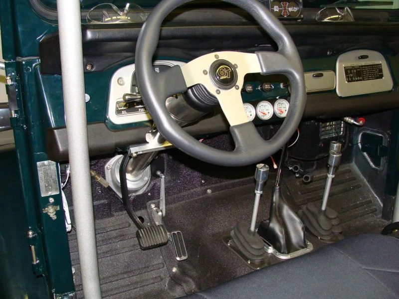

I've been trying to wrap up the wiring, but I keep finding more wires that need pulled. I installed the three autometer gauges into the radio slot (oil pressure, water temp, and trans temp), which was a real tight fit. I found a small gauge panel at Summit that was almost a perfect fit, until it came to installing the lower dash pads. You can't see from the pictures, but both pads have been shaved with a sanding drum to fit the outer gauges.

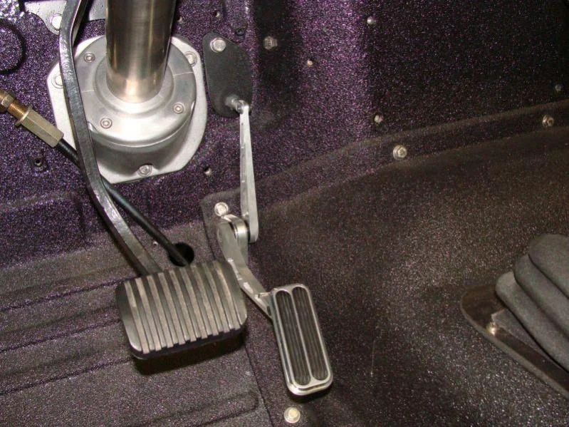

The next thing to tackle was the gas pedal. MUD research indicated the need for a Lokar replacement of the stock pedal for the V8. Apparently, there is not enough throw in the OE assembly. I guess that folks have heated and bent the stock units to work, but this leaves the pedal pad pretty far off the floor. I build a little blank-off panel for the proper opening and installed the shortened cable assembly. I also flipped the pedal pad over to extend the longer side toward the floor.

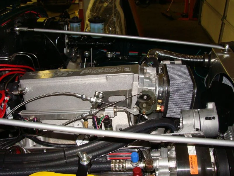

After the gas pedal was installed, I could then shorten the throttle cable and make final adjustments on the transmission kickdown. I tried to route the cable for nice sweeping bends between firewall and throttle body.
Sounds good, nice exhaust note but not annoyingly loud. Bet you had a big smile on your face during that drive. You do excellent work but the tilt-o-meter on the dashpad has to go, it ruins such a nice clean dash pad and screams tacky add on. On a 4Runner where it was stock OK, otherwise they just look terrible IMHO, unless it is a trail beater where it will be used to freak out the passenger.
