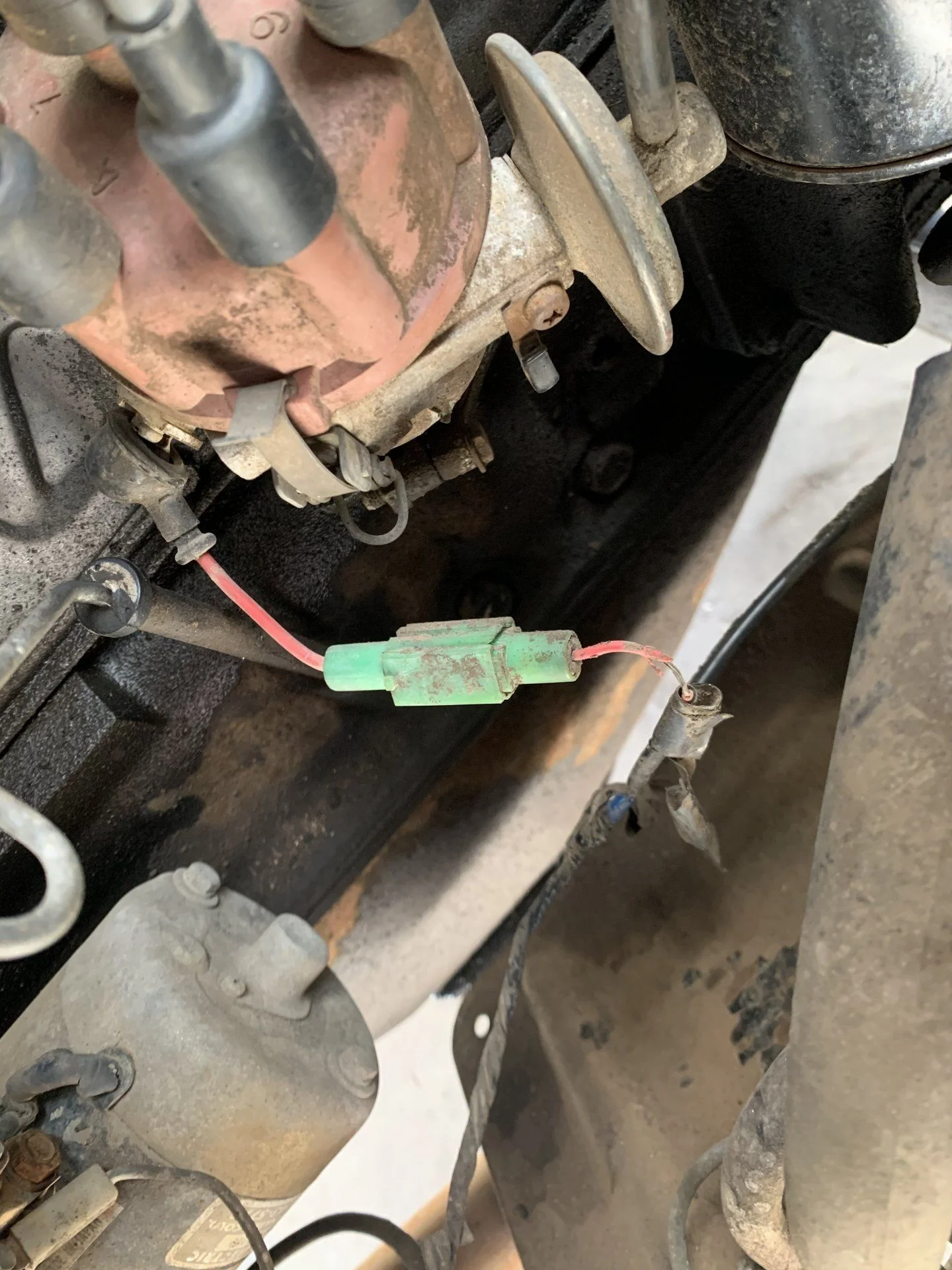

Thanks dmaddox. I’ve checked the idle solenoid and from what I’ve read it seems to be ok. But I will check the inline fuel filter and clean the fuel lines.
sight glass has fuel when it dies and needle valve was cleaned. I’m thinking this may be the culprit.
