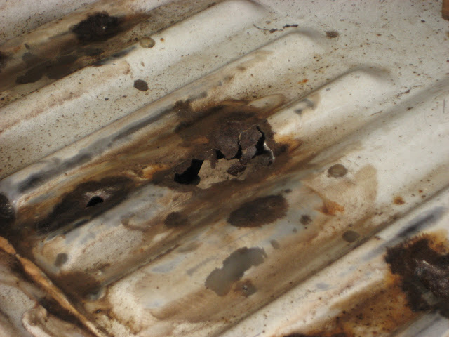

I started working on the truck, the first stage being cutting and exchanging the rotten floor panels, sealing the floor and then isolating it from heat and sound.

and the floor:

that rusty floor looks like the floor of many aussie troopys and utes:D
