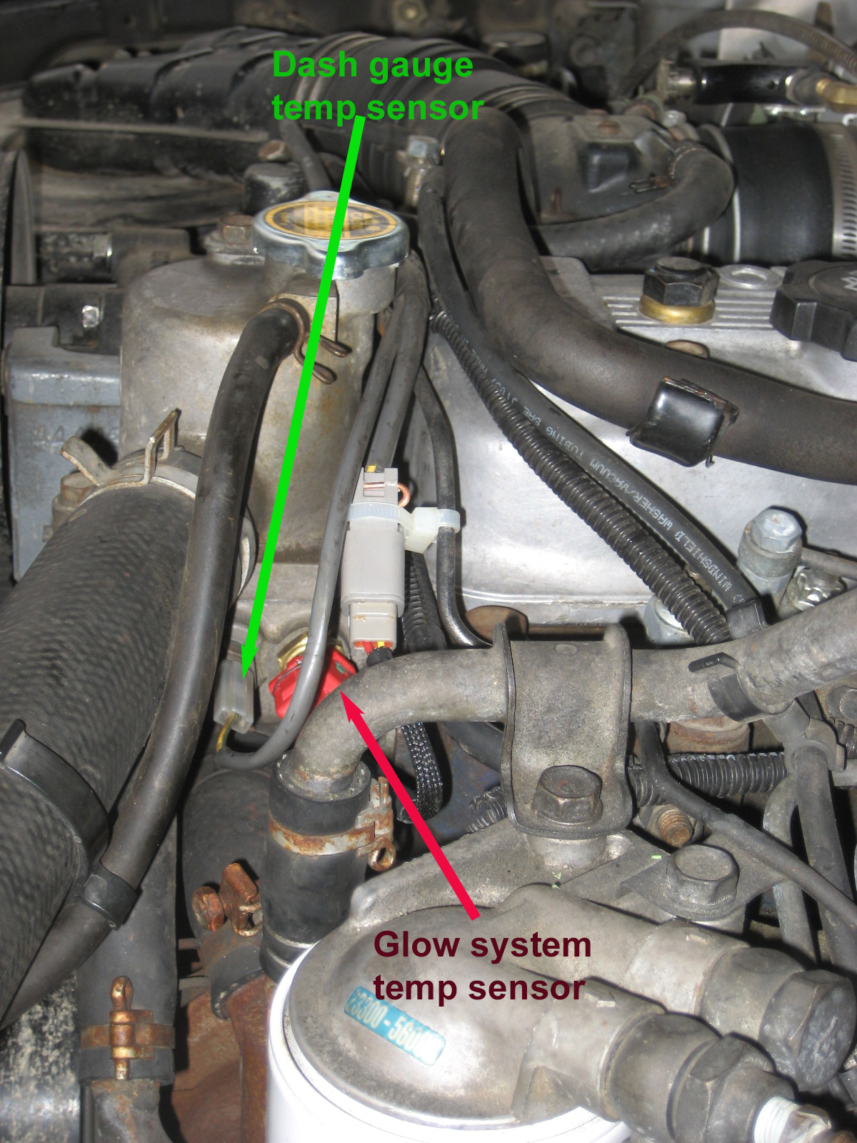

I had something similar on my 3B, and found a broken wire. There is a temp sensor in the system, so the glow thought the engine was dead cold still. It nuked my glow plugs, and I had to get new ones.
On my 74, the temp sensor threads into the thermostat housing, or right next to it.
Looks very much like the coolant temp sender and is near it.
In the parts catalog I believe mine is listed as an oil temp sensor, but it is actually for the glow system.

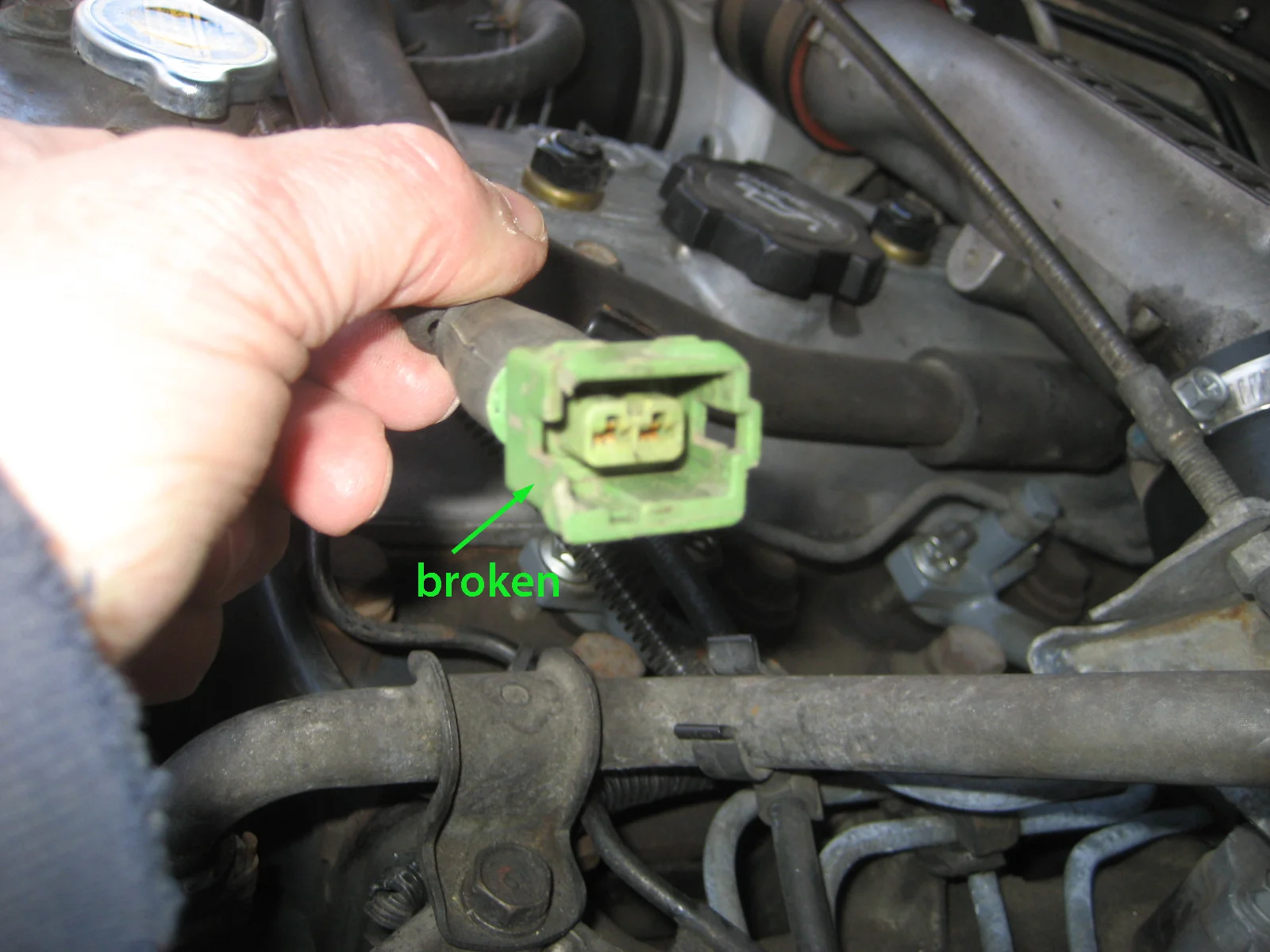

I used to have a green plug that attached to the glow system temp sensor.
I broke it and now have a red one.
