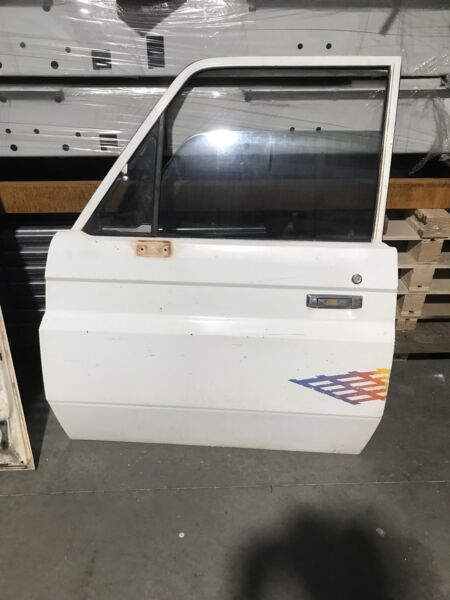

Rounded Edge (75 troopy/79)

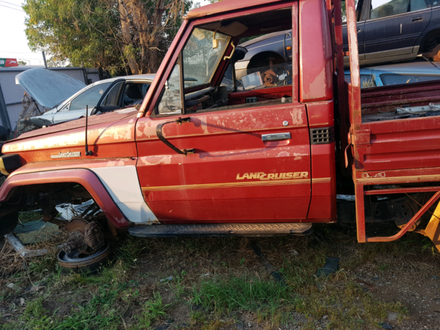

Sharp Edge (75 Ute, I also think 70/73/74 with the folding windshield are the same)
