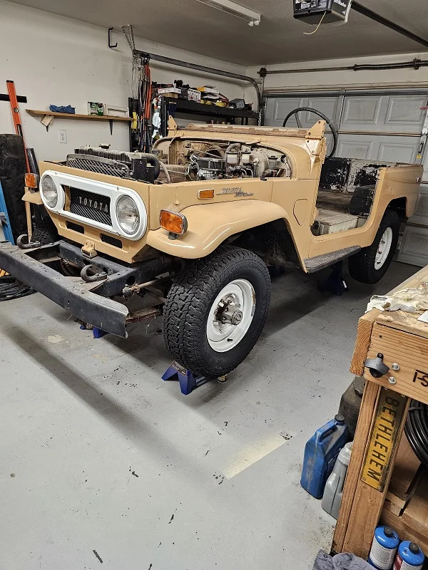

'71 FJ40 Meet Jiffy

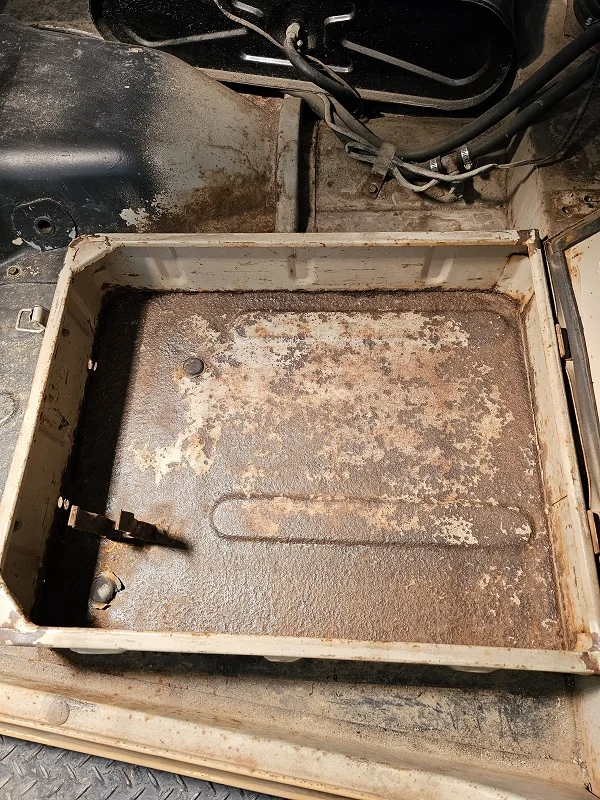

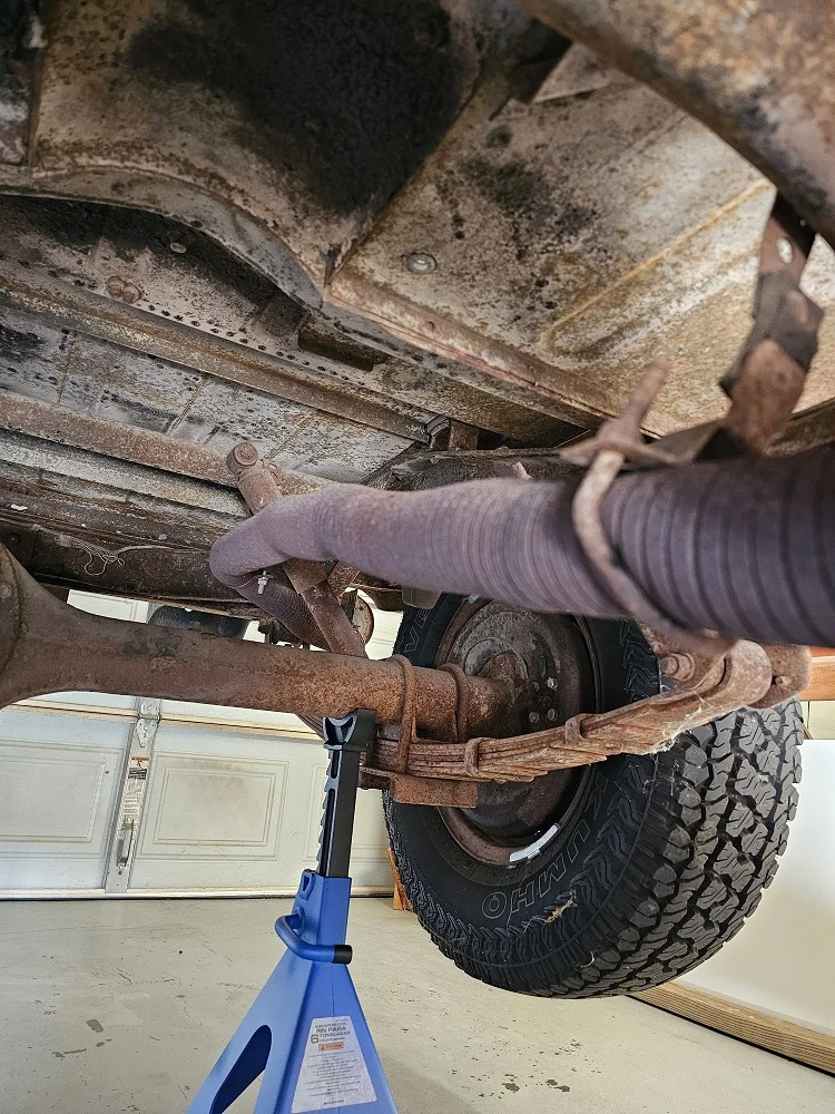

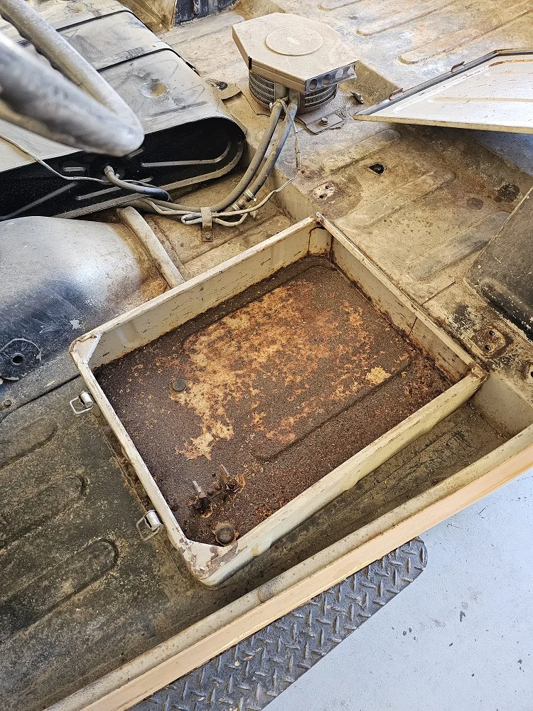

This area is pretty rusted and I'll need to sand away at it to see if it can be saved or if I'll need to cut and replace some metal.
full
full
Might want to pull the tank up and have a look at floor and bottom of tank while you have it apart. I am not a fan of the tool box as it condesates in them and walla, mine was removed by PO and at first I was miffed but over 20+ years I now appreciate the foresight. Thas a clean rig. For wires just locate the factory harness coming from all 4 corners & thru firewall, identify the factory harness going to gauges & hazard/blinker/brake , take everything else out. I used a small 12v batt and test leads to identify & tag the wires for running lights, blinkers, brakes, etc. Some like to use the factory wire color codes, I prefer to test each wire & label anyway, if it corresponds with factory colors all the better for reassembly.

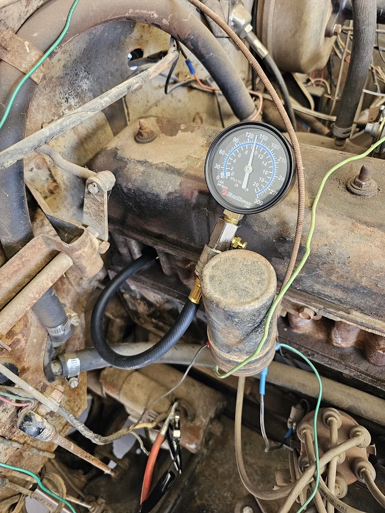

Compression test
Cyl 1 - 92psi
Cyl 2 - 120psi
Cyl 3 - 110psi
Cyl 4 - 92psi
Cyl 5 - 120psi
Cyl 6 - 140 psi

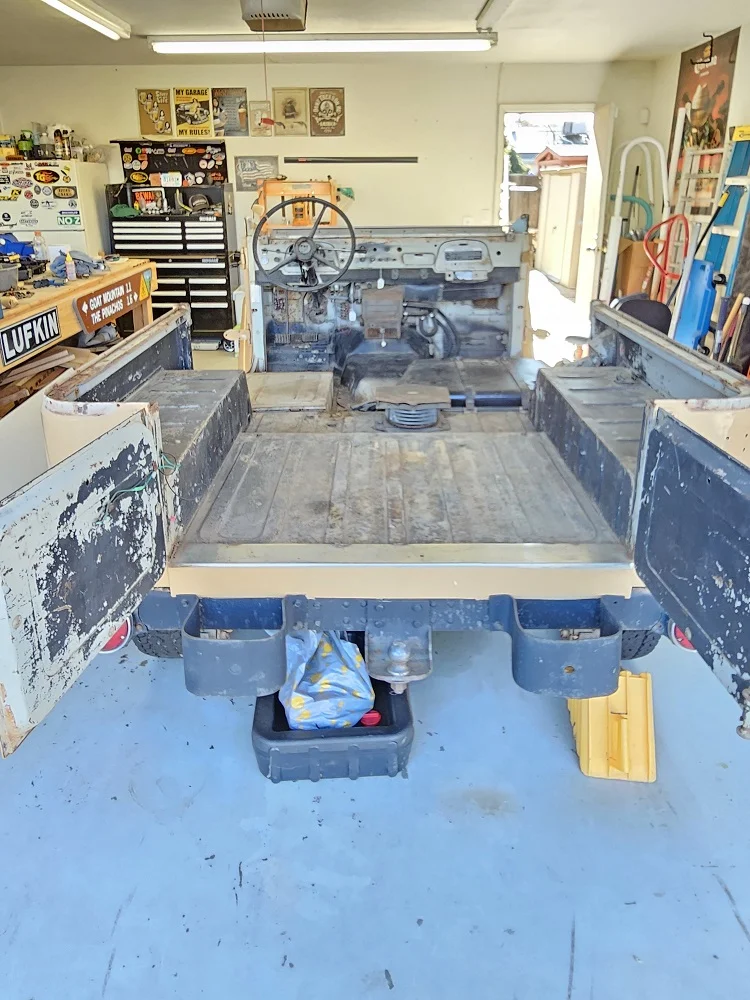

As she sits now, I think how far I want or should take the build. Should I strip the rest of the body down to address surface rust on the body & chassis? That's quite a commitment. Should I drop the transmission & transfer case to have that gone through? I've had work done by Georg on my previous 40 and was very satisfied with VH's work. Should I pull the 1F to have it gone through? I hear the oil/lubrication system is the sole killer of these 1F's and a lot of people swap a 2F. I'd personally like to keep the 1F, 3 speed column shift, I'd like to maybe pull the Weber off and have the original carb rebuilt and put back on but still unsure about that yet.
I'm thinking of sanding the inside of the tub while I have it stripped and re-paint or re-coat it. I have read to avoid truckbed liner style coatings.
Thank you, That's a good idea. I'll pull the tank next to look for rust. How is the front of your driver seat mounted since the tool box was removed?

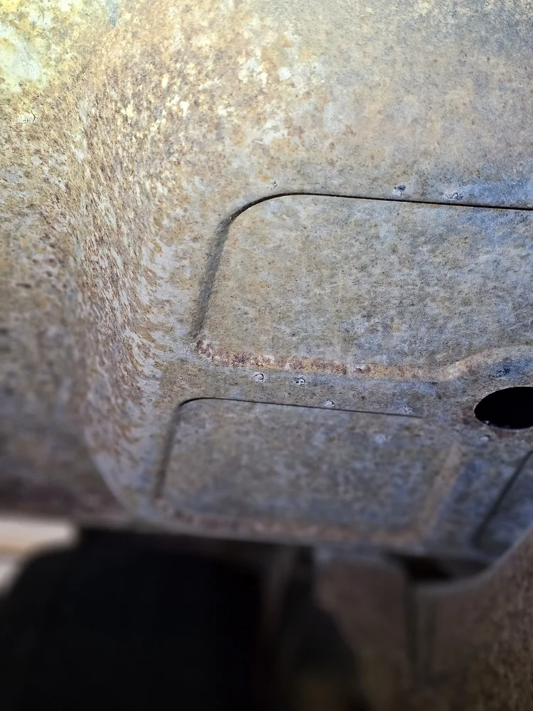

I unstrapped the fuel tank to lift it and look underneath, no rust. Looking at it from underneath there is just the surface rust.

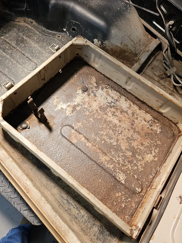

I clean up the tool box with a wire wheel. It wasn't as bad as I was expecting it to be. There are some severe spots that have corroded all the way throuugh the side of the box but at least nothings gone through the bottom. I'll probably clean it up a little more and coat it to prevent further damage or look into removing the box all together.

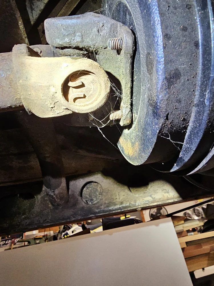

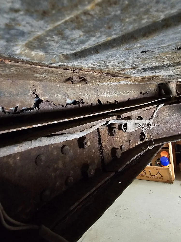

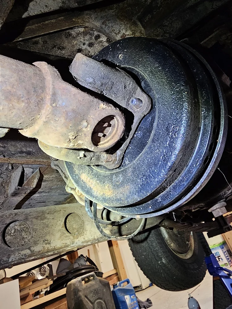

I was in the garage earlier while it was still under 100 degrees out and was on the hunt for the Overdrive that the tag on the dash indicated.
I found this,
full
full

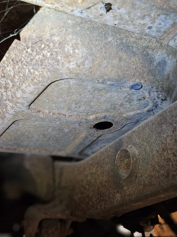

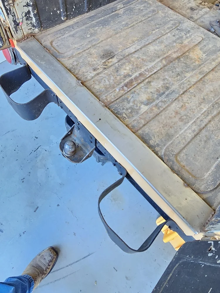

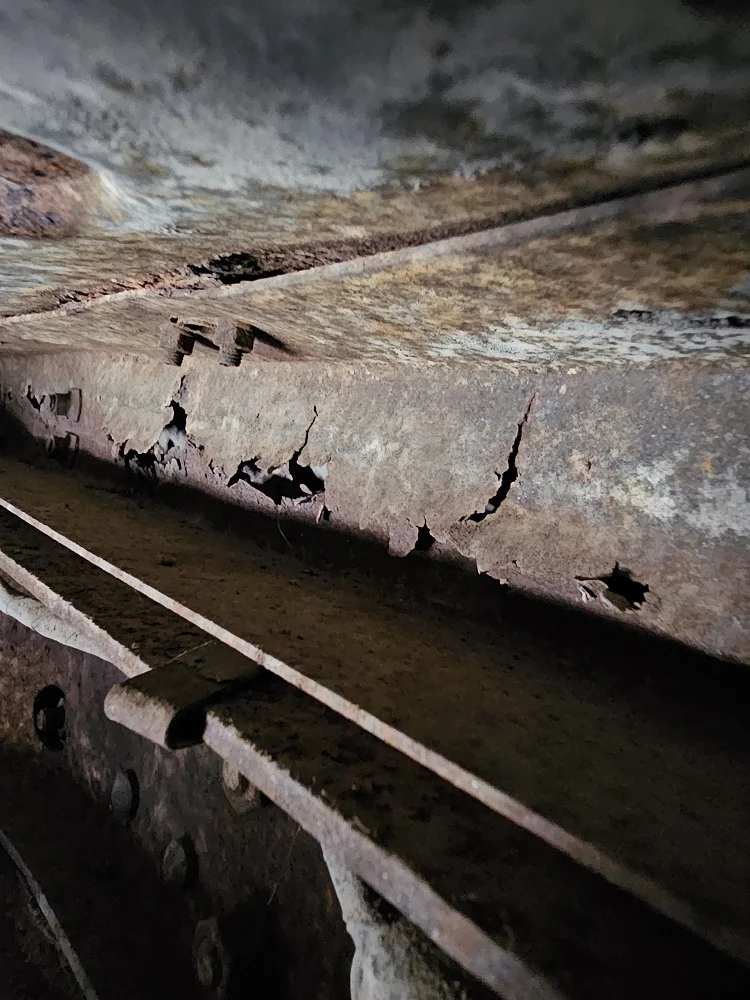

And then I found THIS!
full
That’s where your overdrive ‘use’ to be….you have a standard 3 speed trans and 2 speed transfer case. You should patch or replace the cross member however.
