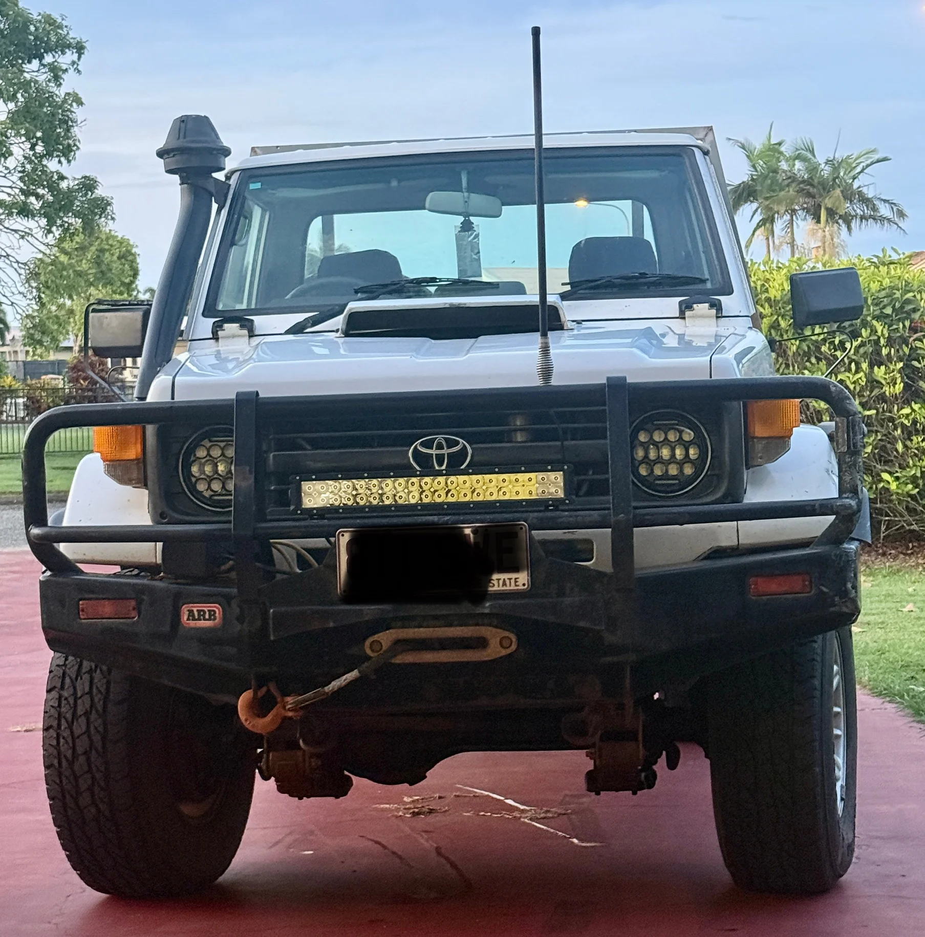

I spent a fair bit of time looking into this as well in the past, and after extensive research, I went with these:
They are currently on sale too, pretty good deal IMO. They are robust, and I have had them for close to a year now and I am very happy with them.
I had the OCAM. Be aware they're designed for RHD not LHD.
I ended up taking mine off as they are cartoonishly large.

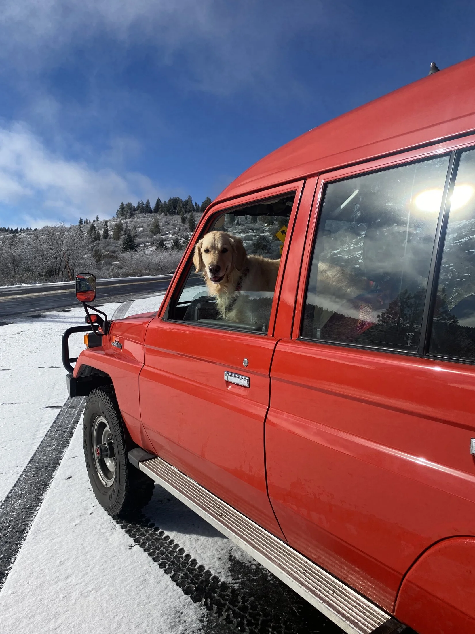

The original fender mounted ones work great for me…That’s why I kept them. Lots of adjustment.
I bought a set of original door mirrors but will probably never install them.

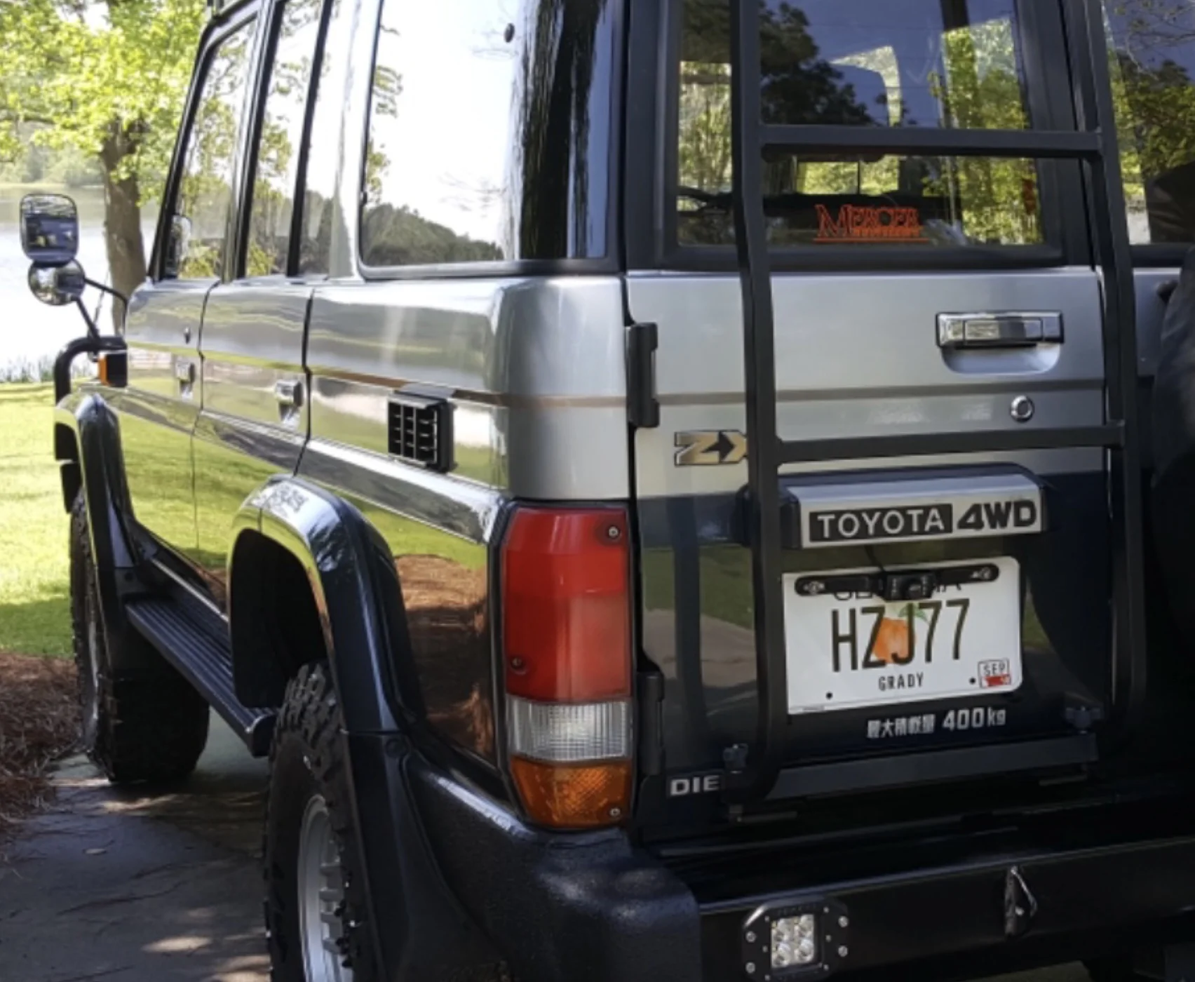

I also stuck with the fender mounted mirrors, but added “fish eyes” to aid with merging into traffic.
For the G-wagens you can buy a milled spacer block to space the mirror out an inch or so. Its not much but I wonder if a small spacer would help, without adding too much leverage to the door sheet metal? My trailer (at least the one behind the 70 series) is going to be pretty small, but I have been wondering if I'll need enhanced mirrors?
