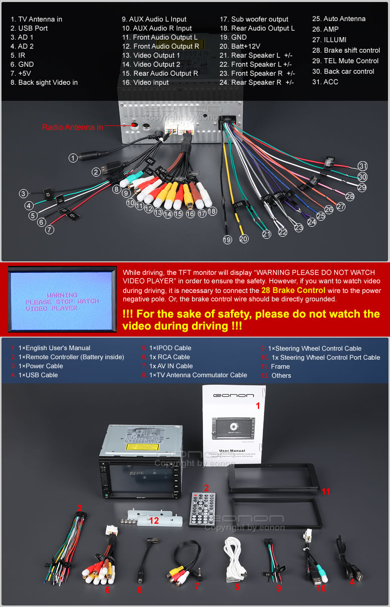

well . the second unit arrived DOA. It boots up, but the screen is non responsive :bang:
Looks like I'll be buying the more expensive namebrand unit afterall. :doh:
Only 19, 20, and 31 MUST be hooked up for it to turn on and function. i have everything soldered properly and still nothing. :bang:
