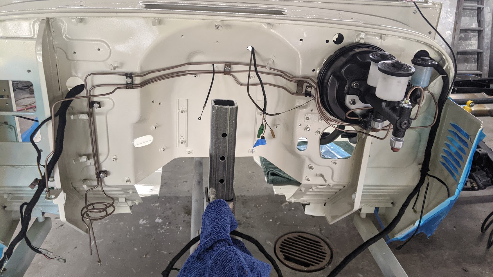

I just bent my own - if you get the nickel-copper line, it's pretty straightforward as it's a bit softer and easier to shape. I won't match the finish/color of the factory line, though - it's got a copper'y color to it. It's a bit more corrosion resistant, too, which is not a bad thing up here in the north.

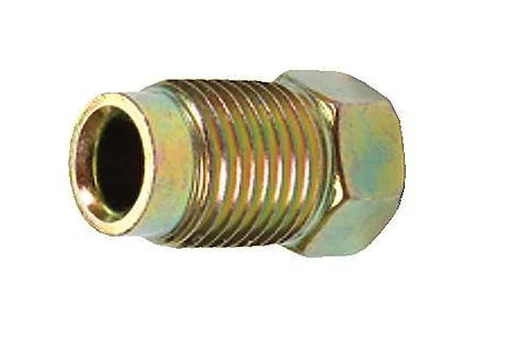

Fittings were the BR205s and 3/16" line:
I'd bend some new ones. Pretty easy to do, the only difficulty may be the bubble flare for the metric fittings.
Those lines look nice!
Should be able to use those M10x1.0 fittings with normal 3/16 line. Just a typical double-flare, not a bubble flare.
Just make sure the fittings have that unthreaded bit - I got few that were threaded to the end, and had to reflare a few lines as I didn't notice before doing it. Most parts stores carry at least a few of those BR205s.
