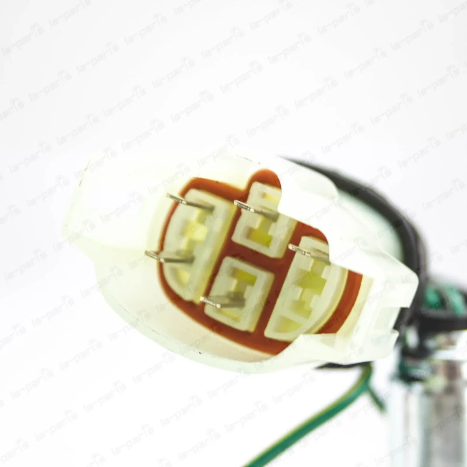

Talking with @ToyotaMatt sourcing parts for the wife's FJ40 and am wondering if anyone out there has ever seen a 6th wire going to the taillight housings? The late model plugs are a 6 pin, such as the one listed on ebay here, but there are only the 5 wires going to the housing. Has anyone seen that 6th pin in use? Just wondering why Mr. T would switch to a new plug with an extra pin unless another market had a use. Below is a pic from ebay showing the plug, with the bottom right slot clearly empty.

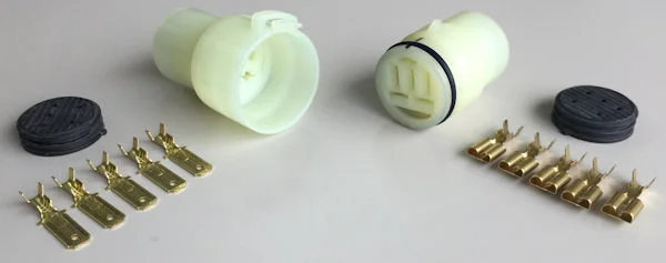

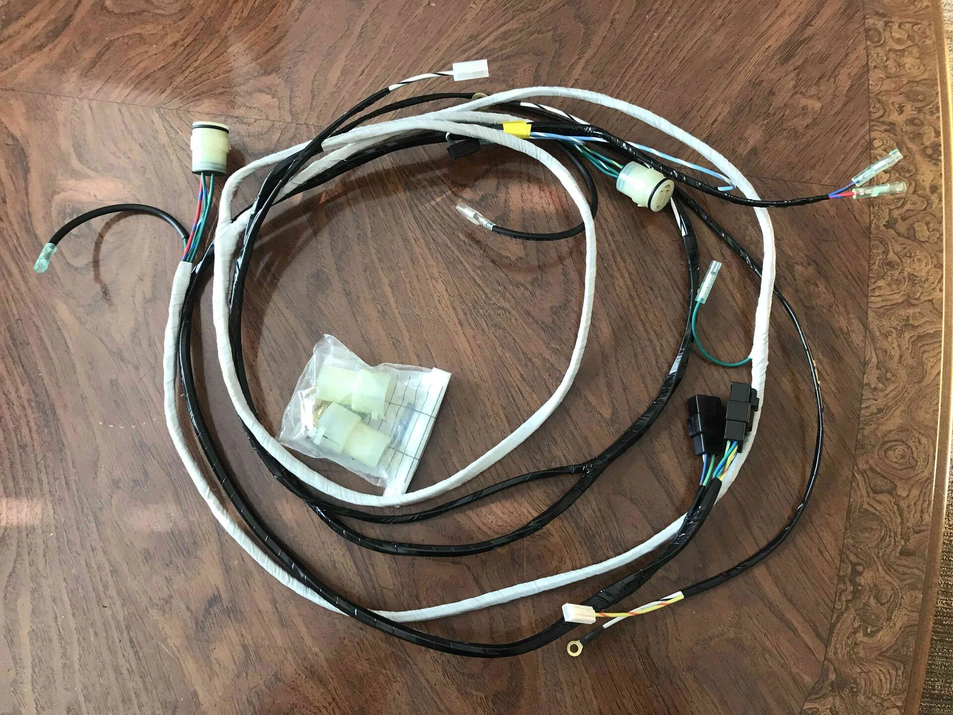

I had my '76 wiring harness professionally rebuilt by a Mud member. As part of the process, he wired up my taillight assemblies with a 5th wire mod that takes the ground all the way back to the front of the truck. Standard was 4 wires. I have no idea what I would to do with a 6th wire...
He used the plugs/connectors shown in this pic, which I "thought" he got from Matt. I could be wrong, but these connectors are the bomb.
That's the one! Sumitomo 5 pin.

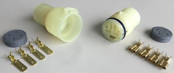

I typically use the 5 pin on my rear harness builds.....but will use the 4 pin for the older rear combination lights.
FWIW: The Toyota (8/76 - 1/79) OEM rear combination light's 4-pin seals fits the Sumitomo housing, so it is a simple swap when needed.
