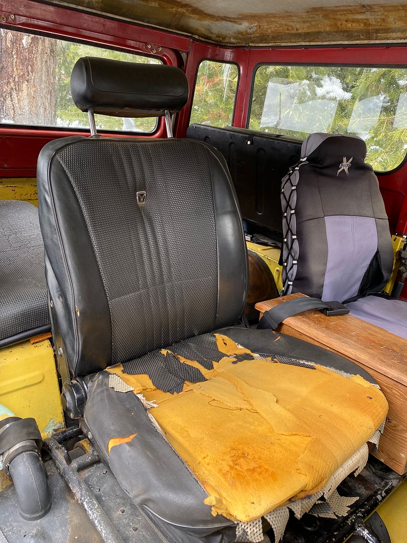

Also replacing these sweet seats with a set of Mastercraft Baja RS reclining seats in front. Heated of course :biggthumpup: and swapping in a rear bench bc the jump seats are just not practical or safe for actual wheeling or touring. As sad as that may be!!! :dunno:
these are VERY cool though!!

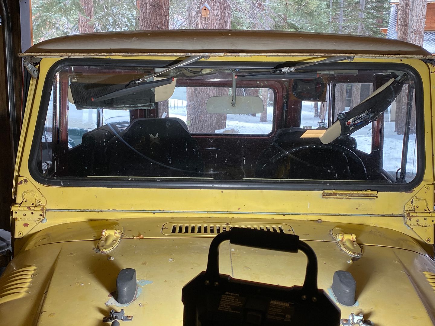

New windshield frame and new glass!! And a sexy fresh coat of Spring Green
Not gonna lie, installing that glass solo kinda sucked. 😂😂
Now just need to clean up the wiper assembly and reinstall. Top and doors might actually fit with a straight windshield frame😎

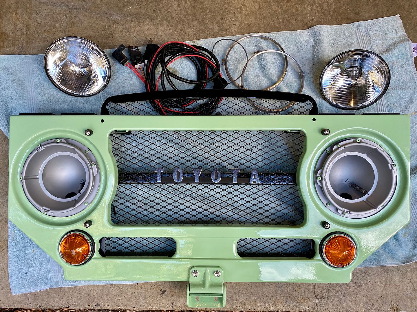

Cleaning up the electrical a lil so it works better, replaced all the front lighting and cleaned up any evidence of corrosion on the front.
Windshield Frame and new glass, Aprons, Hood, Grill and bezel are fresh, no bond. even pops for professional paint- a first in my life 😂.
IPF headlights, Sylvania H4 pro? bulbs and Painless High Amp Headlight harness. A start.

Hardwired in the new Painless Headlight Harness, cleaned up a bunch of front wiring and replaced the wiring distribution blocks on the fenders. the new Hella H4 100/55 bulbs in the IPF housings are BRIGHT :biggthumpup: like most newer vehicles
