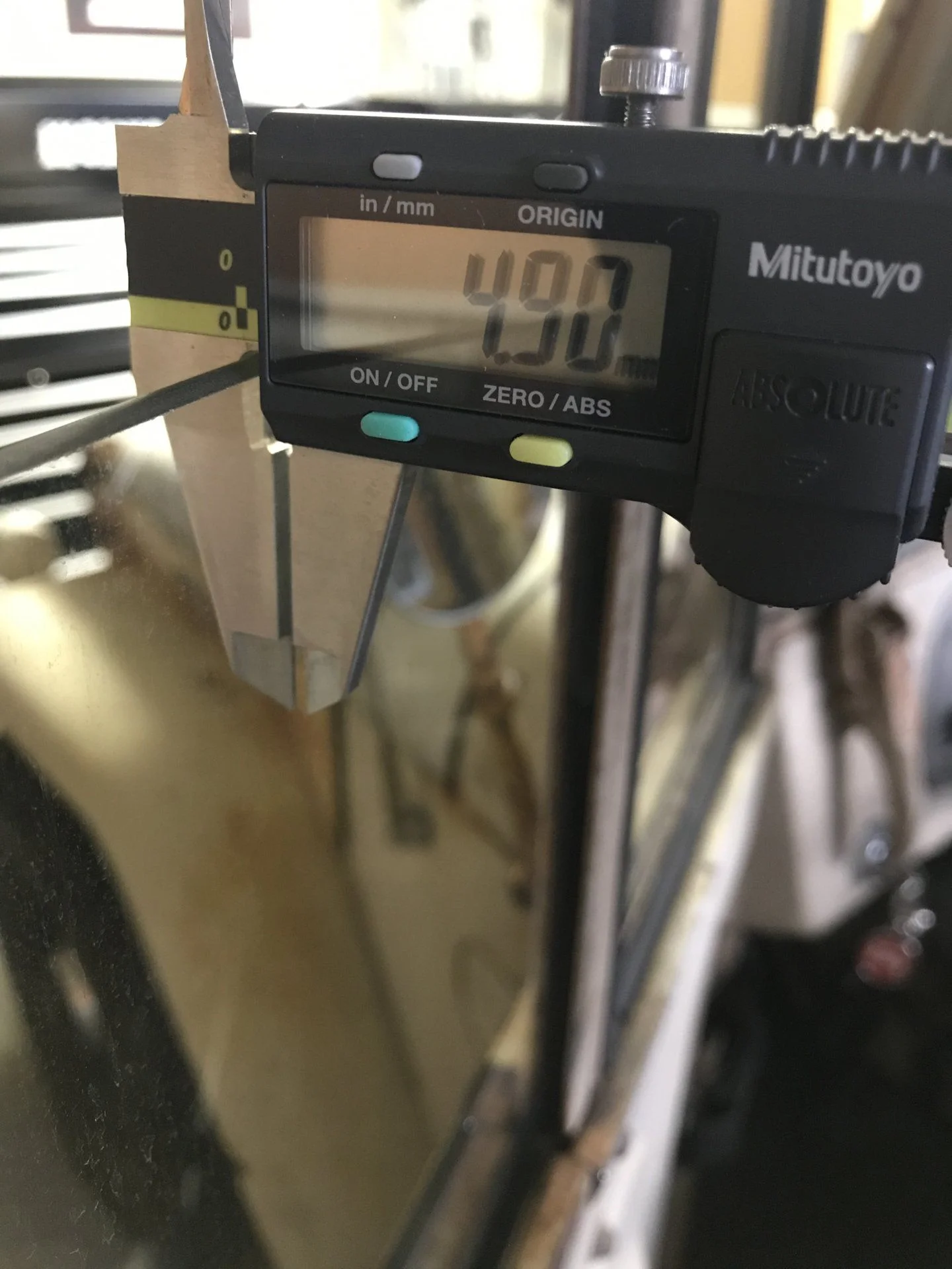

Mr Mitutoyo says 5mm for my 65 SWB.

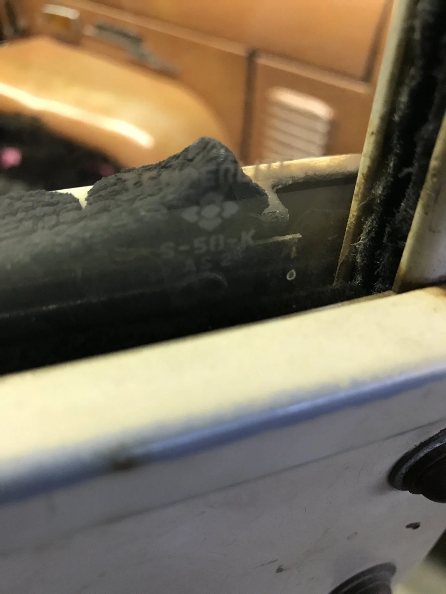

All my glass appears original as it has 7 pieces that have this Temperlite stamp.

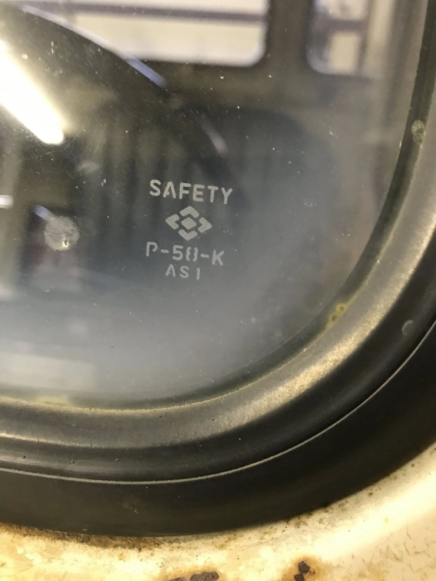

Only the front has a similar stamp but says “Safety”.
So then the original is just a “scosh” thicker than 3/16 ? 👍
