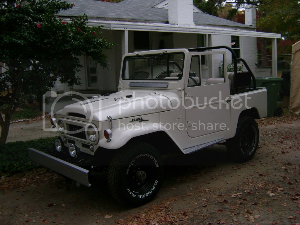

Not killin' my buzz...I didnt think it was correct....just glad I have one.....:) I like the windows in it instead of the corrugated sides ....
If I was going for correct resto I'd be in trouble anyway...:)
So...I'm still enjoying the buzz
Dont wanna be a buzz kill here but that may not be the correct top. 65s came with a top with corrugated sides. *disclaimer* there are always exceptions. You will be able to tell by the top rail of the doors....

Actually, corrugated tops stopped mid year in 1965, so this could in fact be the correct top for this Cruiser.
Nice that you have the doors, now all you need is to paint the sides, and back door white to match the 40.

The build date/month was October '64 so I'm okay knowing It probably should have the corrugated top (early 65).....but I'm really happy it just has a top...especially after the top sat at the body shop unclaimed for a few years!
Thanks for everyones support...I'd hate to think what I'd have done if not for this forum...:cheers:
only reason i made mention was there could be a small issue with the doors. If the doors are for teh older top then the tops of the doors are slightly different from the "newer" top doors. Thats the extent of my knowledge on this as i had the same issue with my 65.... The Mud elders pointed out my existing doors would only work with the older tops.....so, a change in doors "may" be in order..... I "had" a 65 with a 71 top..... I lucked out and found an old school top so i did not have to change my already finished doors...
Do you have a pic of your doors?
Best door pic i have. Notice the top is pretty thin and flat, this is for the old top. Something else to note, the wing window opens into the wind, suicide style....

Mine are the newer doors that go with the top...I'll post a pic in a little while to make sure....

OK - Posting a pic of the doors to make sure they'll work with my newer "uncorrugated" top....

I am by no means an expert, but i'd say your doors are the newer style based on the above mentioned top design and corner windows being the newer style which opens at the rear.
looks to me like you should be good.

Finally decided on a soft top to get me through winter...Did a buy it now on Ebay for the 599.00 Bestop Super top, Used the 10% coupon per Ebay and with $20 shipping got the deal for $560 shipped....It'll be here Monday....Can't wait....

OK - Got my Bestop Soft top today as planned.....The hardest part was the realization that I'm 125 pounds wet and I didnt have enough bum to pull the top taught.....and raise the rear bow.....:)
I did manage however and am thoroughly excited about my top.....Its only been an hour but I like it so far.....Maybe I'll post some step by step pics...
The fit is nice and it appears to stay very nice around 60 mph...Overall Its a very nice feel and I'd do it again in a heartbeat....
I'll post some better top pics but the kiddies and I were ripe for a ride so this is all I got so far....
