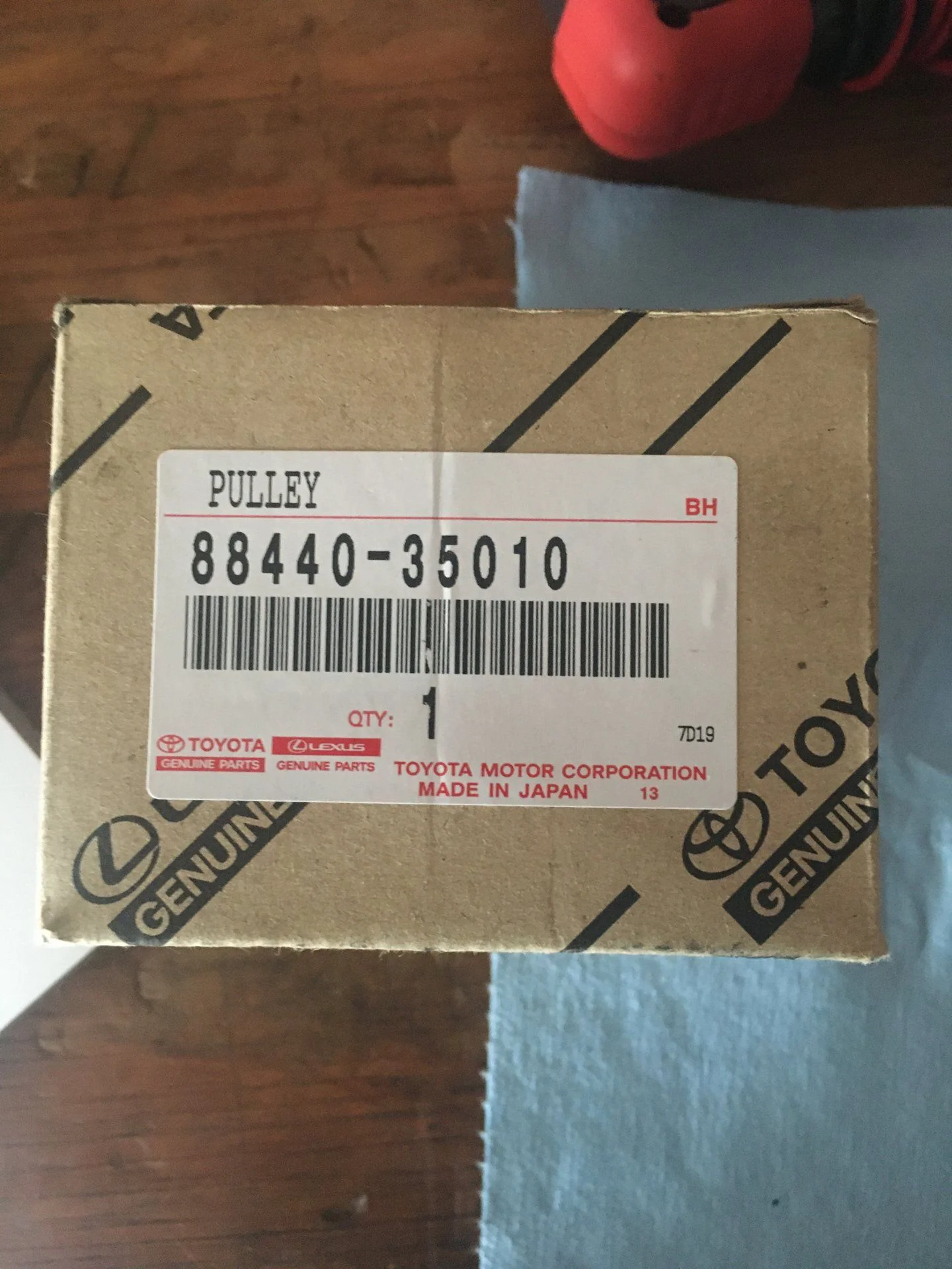

I also replaced the other idler pulley that was available complete from Toyota. Pic below...
Original NSK on the right, Koyo left...
Ordered the pulley assembly (88440-35010) and all new belts from Toyota.
